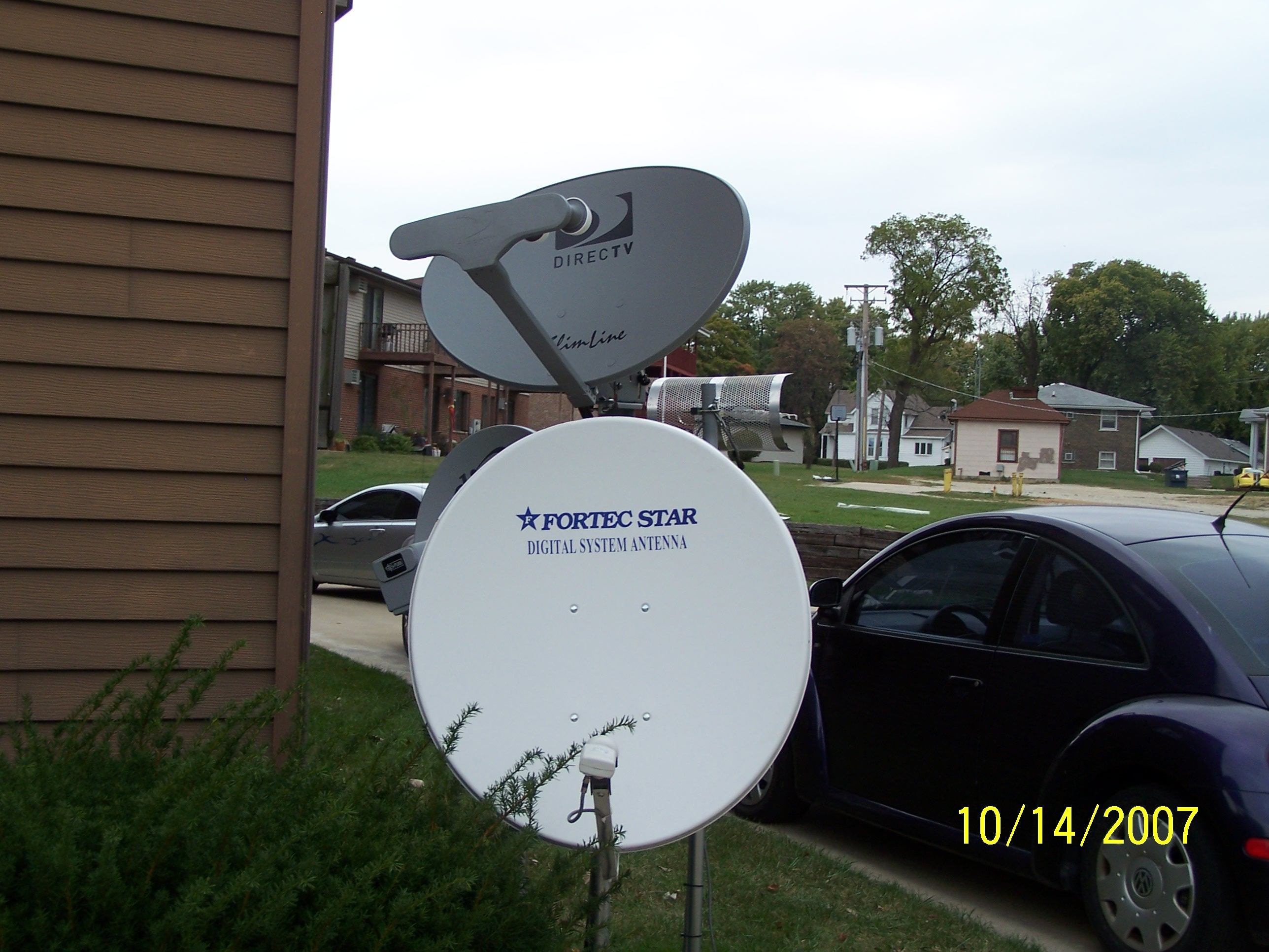

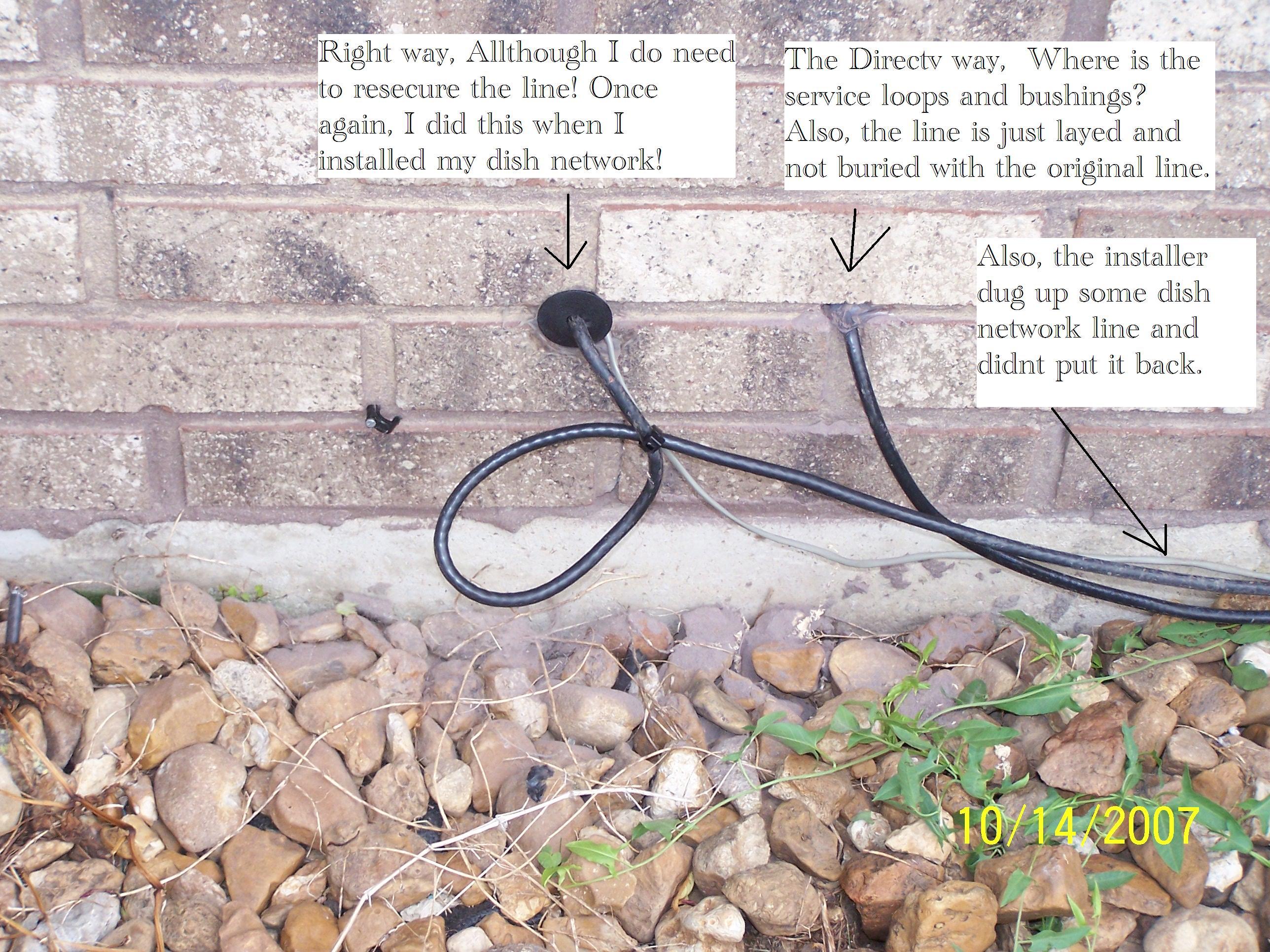

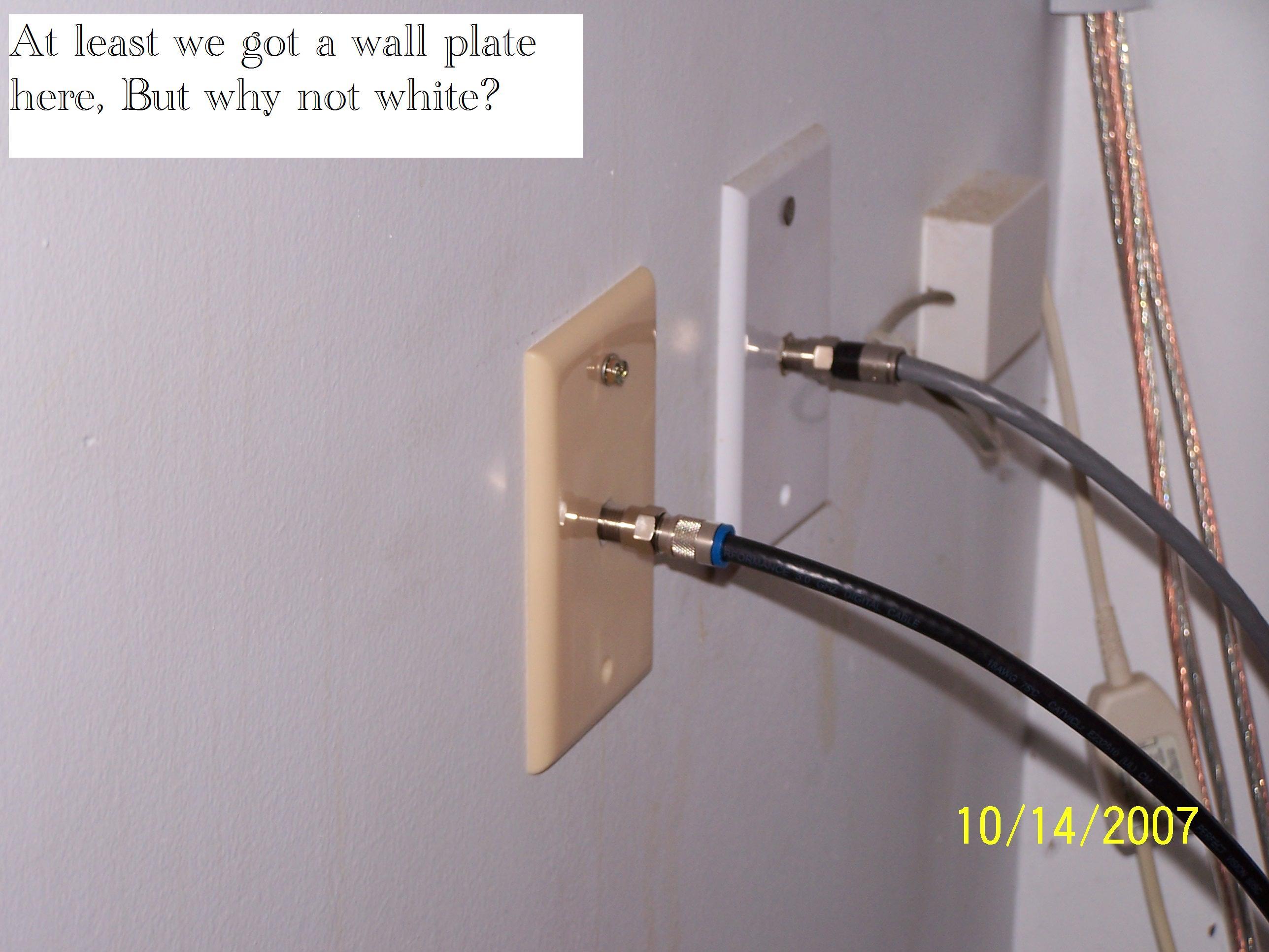

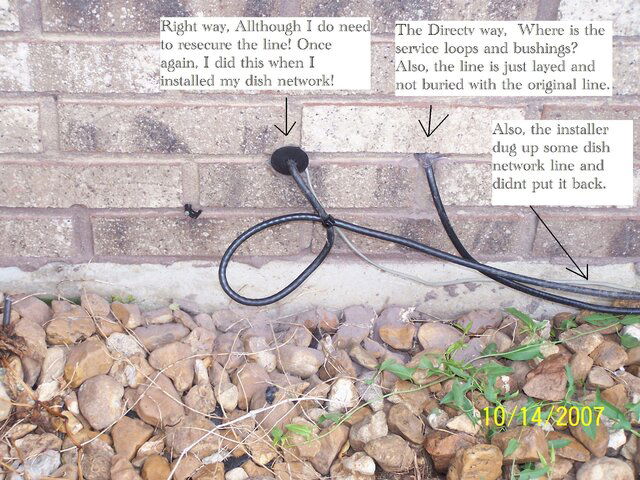

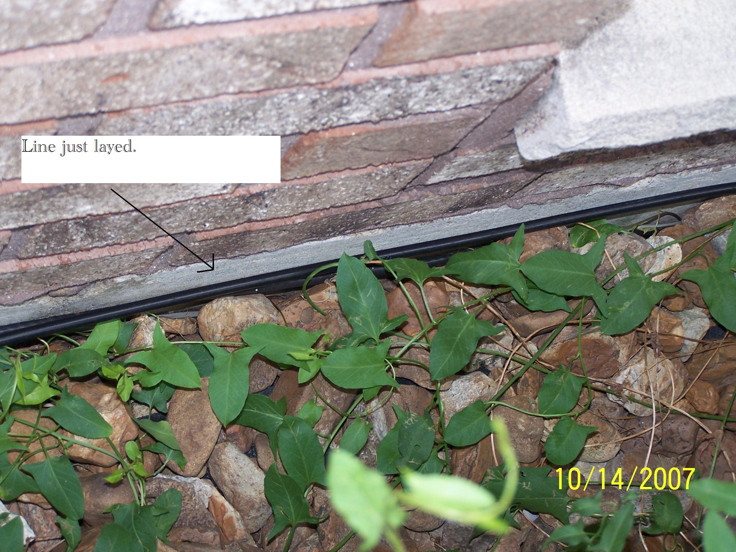

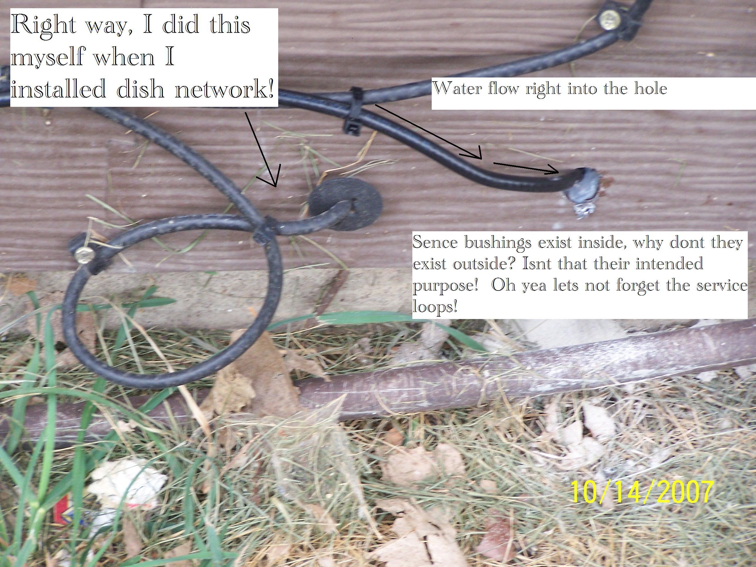

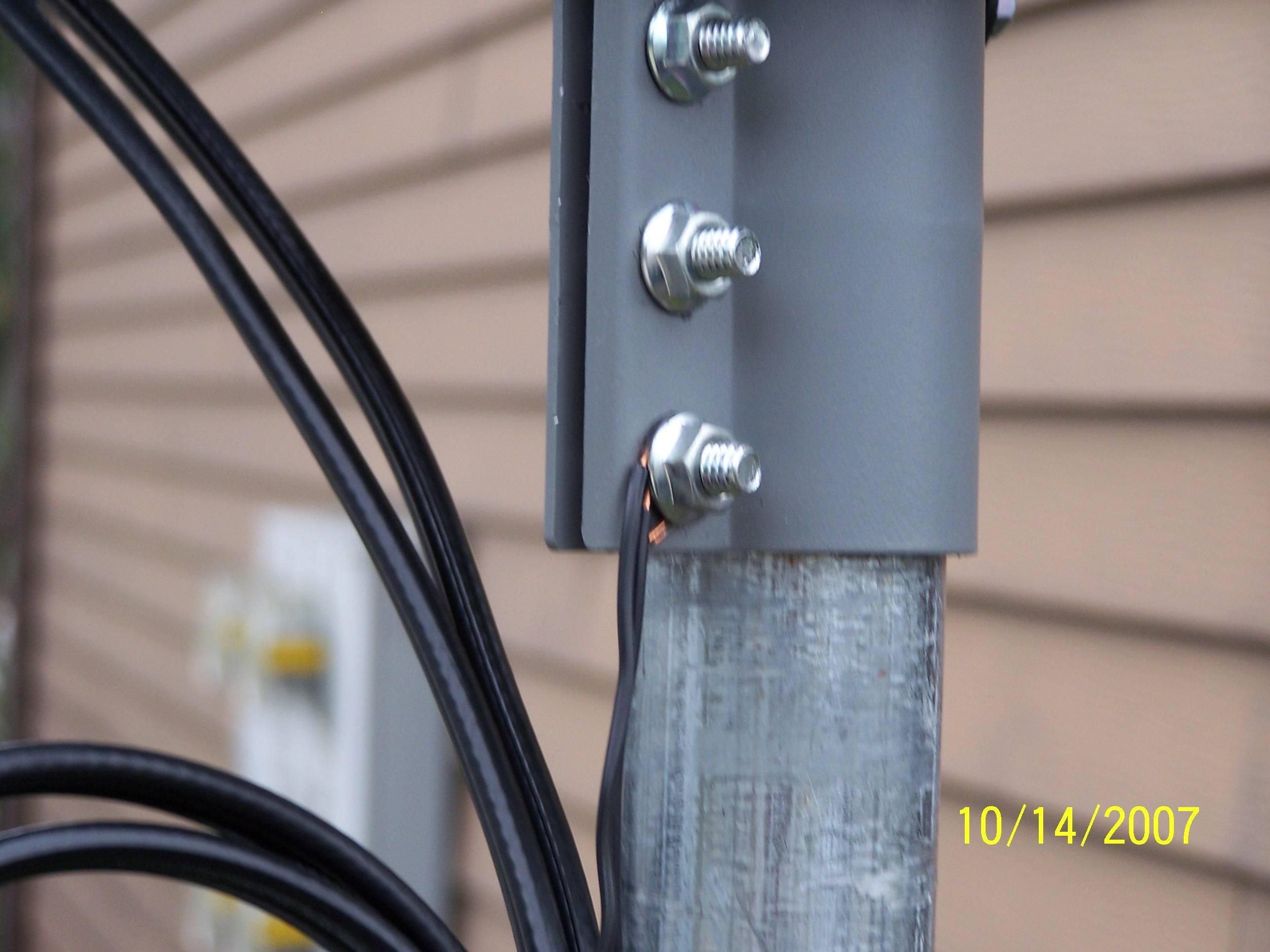

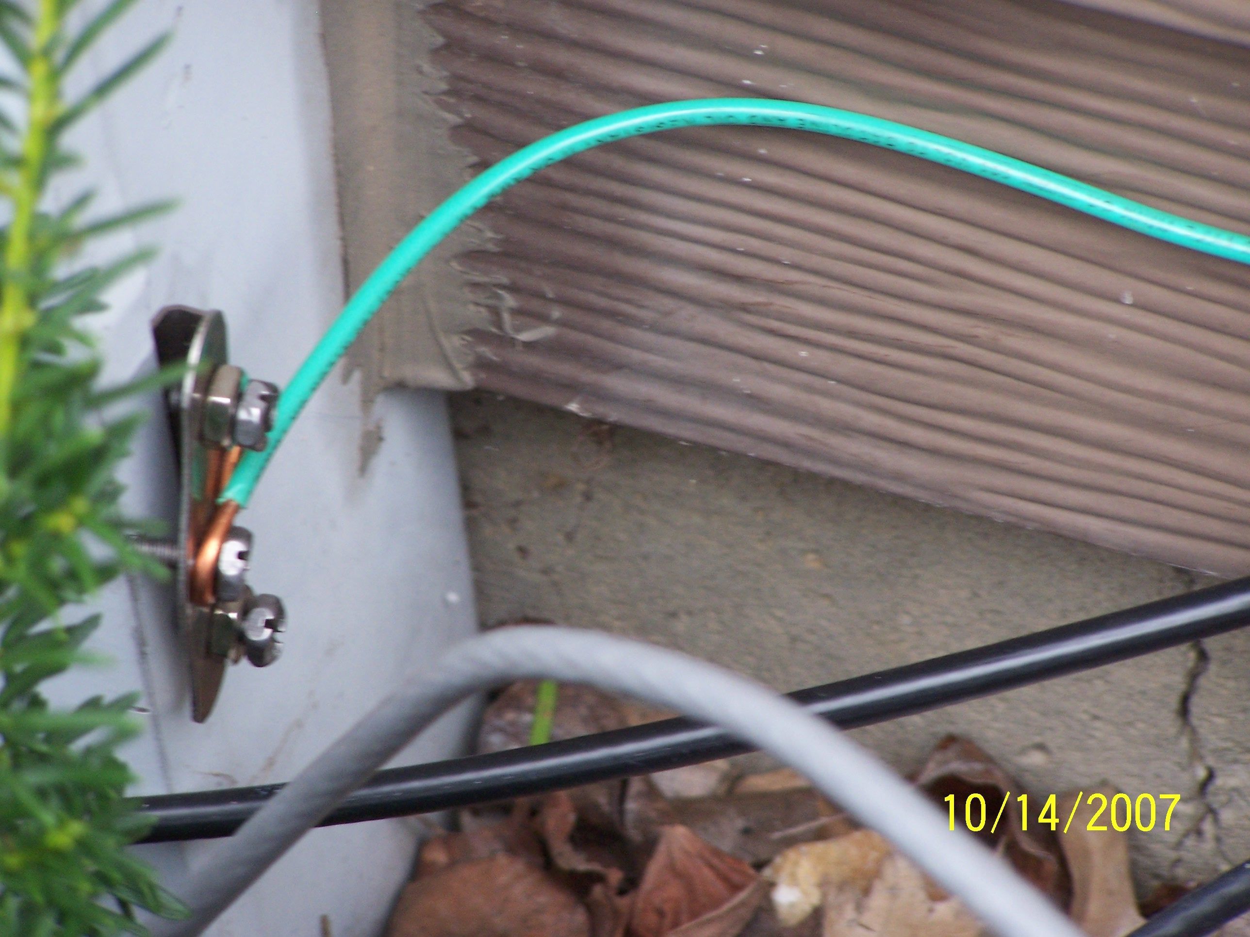

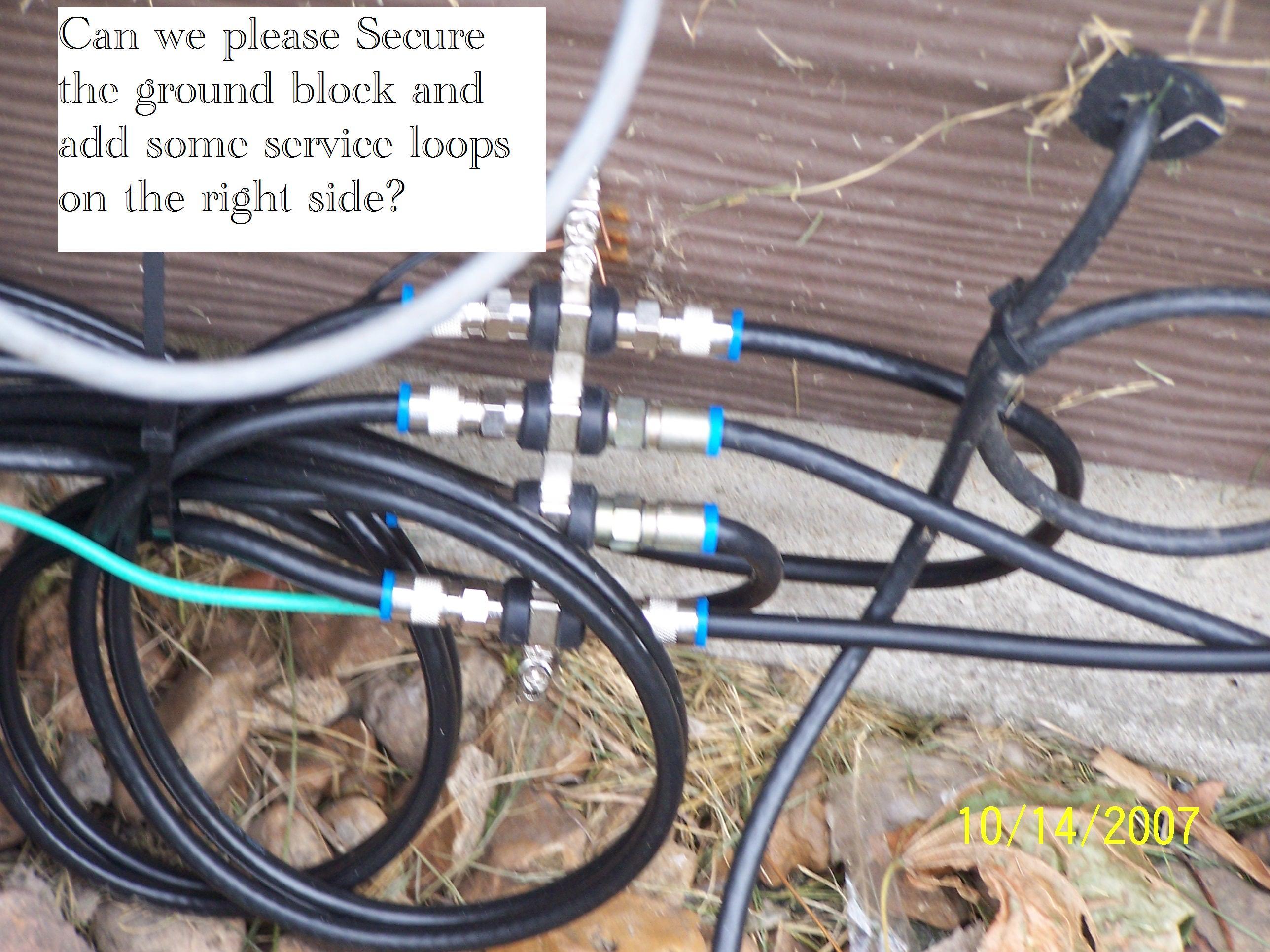

We go outside... I notice the fact that none of the holes are sealed with silicone. Mentioned that, and he sealed them but without bushings. We go out to the ground block, the dish is grounded to the ground block but the block itself is not grounded. Don't you think thats an important thing? So he runs the ground. By this time its dark, and I notice that he never attached the ground block to the building. So we go to his truck, I sign and annotate the work order with the stuff he failed to do. He takes off, not giving me a copy of the work order and annotations. WTF.
So, I call up Directv and schedule another tech to come out here on Monday morning. Attached below is pictures of the install, They speak for them selfs. You can notice the difference where I did my own dish network install and Directv's install.

Same for me, loose wires, loose connections, holes not sealed, equipment not connected right, equipment not setup, HDMI not working. All no big deal IF you how to mop up after they leave. Very sad to leave the less technical with a sub-standard install that they will be blind to until some geek relative, friend, or neighbor happens by and straightens it out. Still my HR20-100 works and works well. Thrilled to be rid of AT&T Dish Homezone.

QC fails on that job:
Non Approved connector (the T&B snap n seals)
Non attached ground block
No loop at POE (no bushing is OK as long as there is sealant)
Cable routing
Dish Assembly (no LNB bolts)
Stacked bond, connected improperly (ground wires at dish on assembly hardware)
Bushing inside
