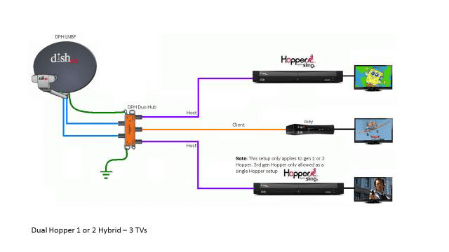

No. One Hopper 3 per Hybrid LNB. The Hopper 3 must be connected to port #1 on the LNB.
So the only way to get a second Hopper 3 working is with a DPH42 switch which requires the hybrid dish to be replaced with a DPP dish, is that correct
And what's the second port on the hybrid dish for?

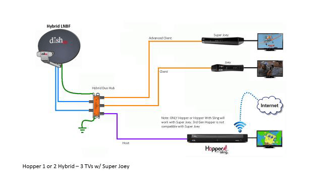

Yes, you need a DPH42 for 2 Hopper 3's.
The dish doesn't have to be changed, just the LNB.
You can connect 2 Hopper 1's or 2 Hopper 2's or a Hopper 1 or 2 and a Super Joey to the 2 ports on a Hybrid LNB.
