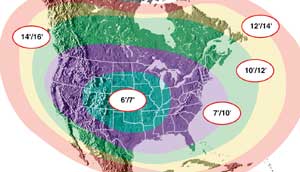

No problems here with a 1.8m ( 6') dish with 99% of C-band satellites, when talking about C-band dish size its important to distinguish between Analog and digital!!
NEVER noticed any interference from adjacent satellites with digital signals and I am slap bang in the middle of the country!
See below picture for C-band dish sizes required...........
Pete I'm 45 minutes from you and I can get 2 satellites if I wanted too
I can get the nets on G4 (digital) and a couple feeds and channels on IA5 next door :)
And thats very cool, but is that interference from adjacent satellites? Have you ever NOT been able to get a digital signal with a 6' dish because of this interference from adjacent satellites may be a better way to put it.
Of course with analog it manifests itself as two pictures at the same time so its easy to see, and more of a problem, but its never been an issue with digital signal for me with the 1.8m here in the US and the 1.7m I had back home (Different spacing over there of course)
How can you make the picture bigger? I click the thumbnail and I still have to touch my eyeball to the screen to read it on my 21 inch screen.
Seen that :0) That picture is especially for members with dial up only :)
