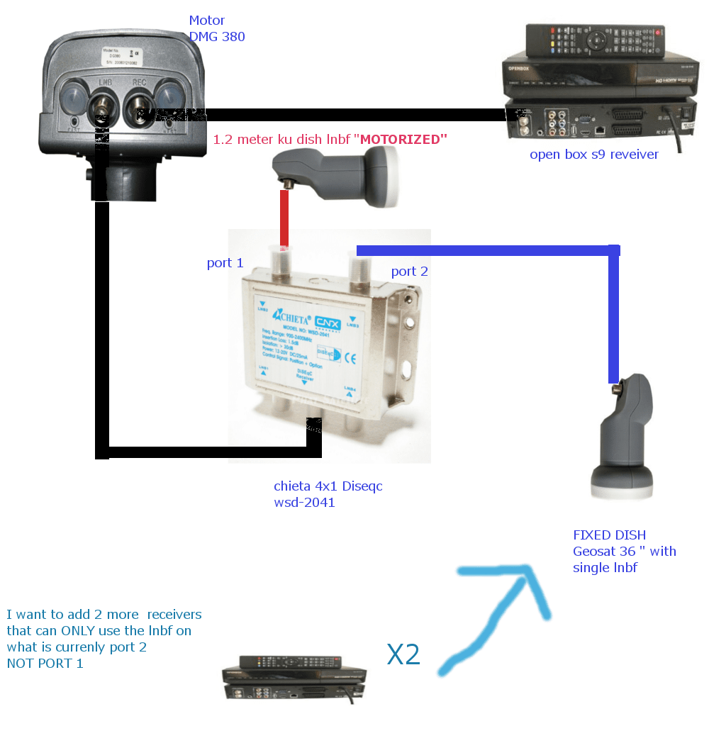

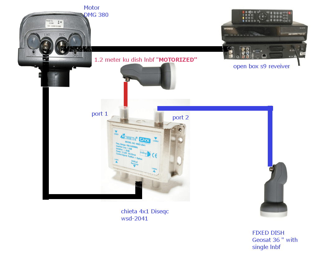

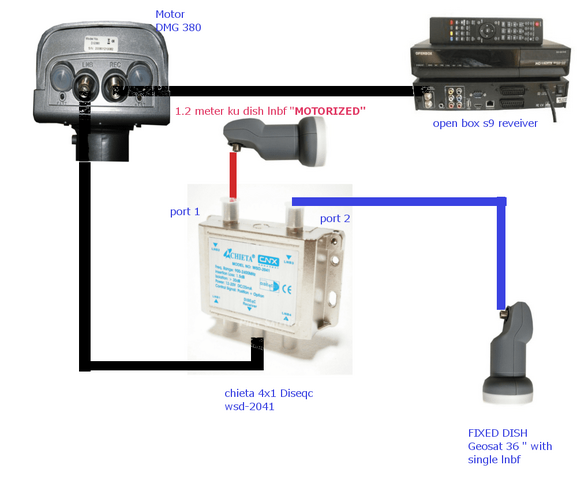

Just to be clear of the current set up again so I can be less confusing. Openbox s9 hd/ wire up the hill about 90+ feet to the motor on the 1.2 meter dish/ the "lnb in" on motor is wired to the output on the diseq switch/ ports 1 to motorized dish lnbf and port 2 to fixed geosat 36" fixed dish. I only want one receiver to be able to use motorized dish.
You get more confusing with every post you throw out. I have less idea now of what you have then when this thread started. I suggest you make us up a wiring diagram in Paint to show us exactly what you have now, and how it's wired. THEN, give us the brand names of your present switch, OR photos of it (better) A Diseqc switch can NOT feed more than one single receiver. A Diseqc switch is NOT the same as a "multi switch".
There's multiple ways of doing what you want, but we can't help if you insist on referring everything back to the way it is at present, which isn't what you said you wanted in the end.

This is what I am asking how to do
Good, those drawings make ALL the difference in understanding.
Ok, that switch is a Diseqc switch, and can only support a single receiver.

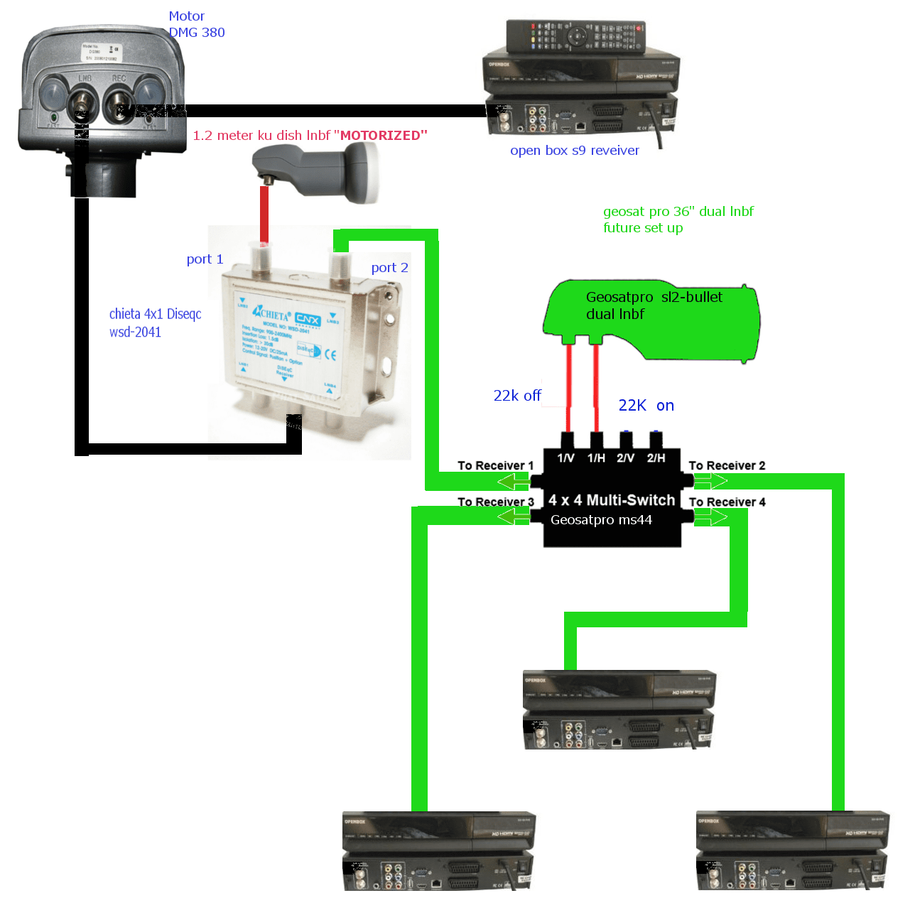

Now, what you do, is you ALSO buy that new additional multi-switch I posted in my first reply, and the dual lnb. You need the dual output lnb to replace the single output lnb you are pointing at with your blue arrow on port 2 of the diseqc switch. That's the only way to do this, and get both H and V transponders (well, the easiest way...)
You then put a coax jumper wire in place of the single output lnb presently on your Diseqc switch. Hook the other end to one of the Receiver IN's on the new multi-switch. Then, hook the new dual lnb up to lnb1/H and lnb1/V (22k OFF side) on the additional new multi-switch. You then hook the two NEW receivers up to any of the receiver ports on the additional multi-switch (they have no connection to the present diseqc switch, YES, you will have to run two new coax cables, one for each receiver). So, the two new receivers and the jumper, will take 3 of the 4 ports on the new switch.
The two new receivers are set for: standard lnb, 22k OFF. They can only see the dual lnb. But, in the future you could add another dual lnb to lnb2/H and lnb2/V (that's 22k ON)
Your present receiver would be set to: standard lnb, port 1 (for "motorized dish lnb"). To access the dual lnb, your present receiver would need to be set: standard lnb, port 2, 22k OFF (that will switch to port 2 of the diseqc switch, which jumps to the multi-switch, and selects the dual lnb)
Simple, huh? There's going to be a bit of money outlay, but this is probably the simplest way to do what you want. It also leaves some lee-way for future expansion.
View attachment 93035 Is this what you mean?
That's it exactly!
p.s. You don't HAVE to use the Geosatpro dual lnb. ANY dual lnb will work, just make sure to get a standard one (10750) for this setup. The Geosatpro is a great lnb though, and that's the way I use one. Don't use a Universal lnb on the 22k off side.
p.p.s Actually, if needed you COULD use a dual universal lnb on the 22k ON side, if you change your receivers to Universal lnb, 22k ON for a particular satellite. This particular 22k multi-switch will pass the 22k signal. NO other multi-switchs will do that, ONLY this Ecoda model will.
