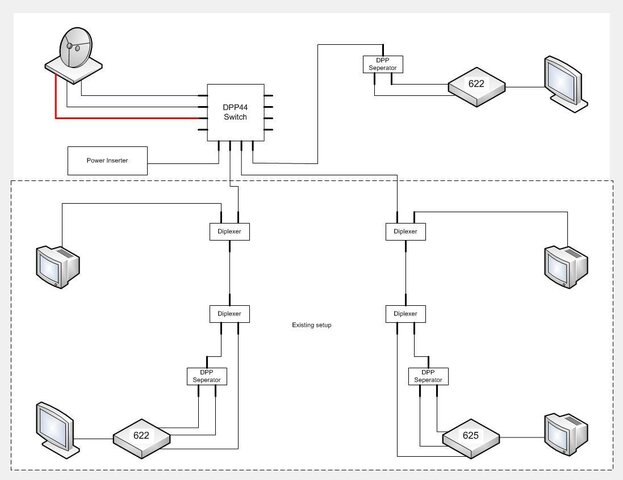

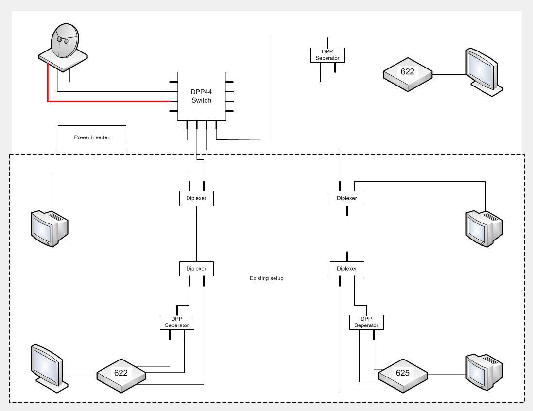

OK, I did some more checking and please correct me if I am wrong.
If I were to make one more run of cable from the dish 1000 then put all three into a dpp44 then because I would be using 2 - 622's and 1 - 625 then I can make just one cable connection to each receiver as long as I have a dpp seperator at each receiver.
I think that this is starting to make sense.
Thank you for all of your help, you guys are really great!
I think that I know how to install this.
I will try and put the picture in the post but if that doesn't work I will put it in an attachment
2064416131
I need to run another cable from the dish (in red), then install the dpp44 as displayed and then run a cable to my new 622 in the upper right and install a dpp seperator and it should work.
Yeah you have figured it out......good research on your part.
