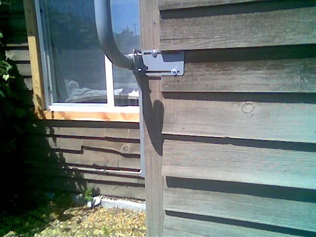

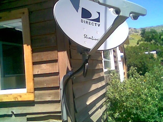

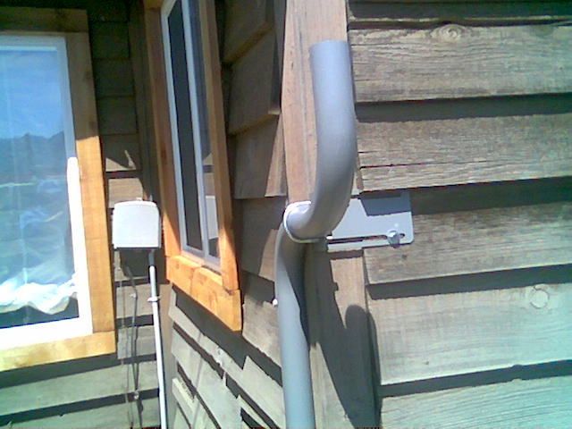

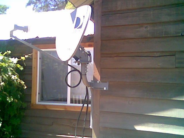

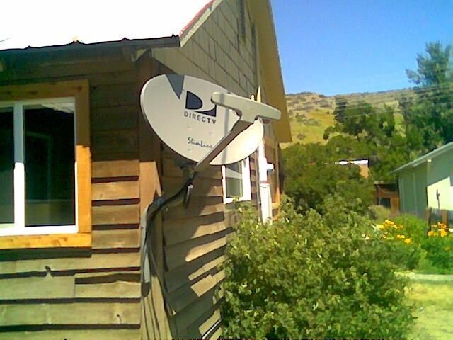

There are other mounting options also. D* recently came out with an S-tube mount for the 5 LNB dish that is designed to be mounted on the corner of the house and does not need any brace poles. Your installer may have one on his truck if you ask and this is a viable option for you.
I've done 4 of these mounts and it is now my favorite way to do 5 LNB dishes. No braces poles, sturdier than hell (I can hang off the mounting tube), installs in less than half the time, and is easier for the sub to remove snow/ice from the dish.
