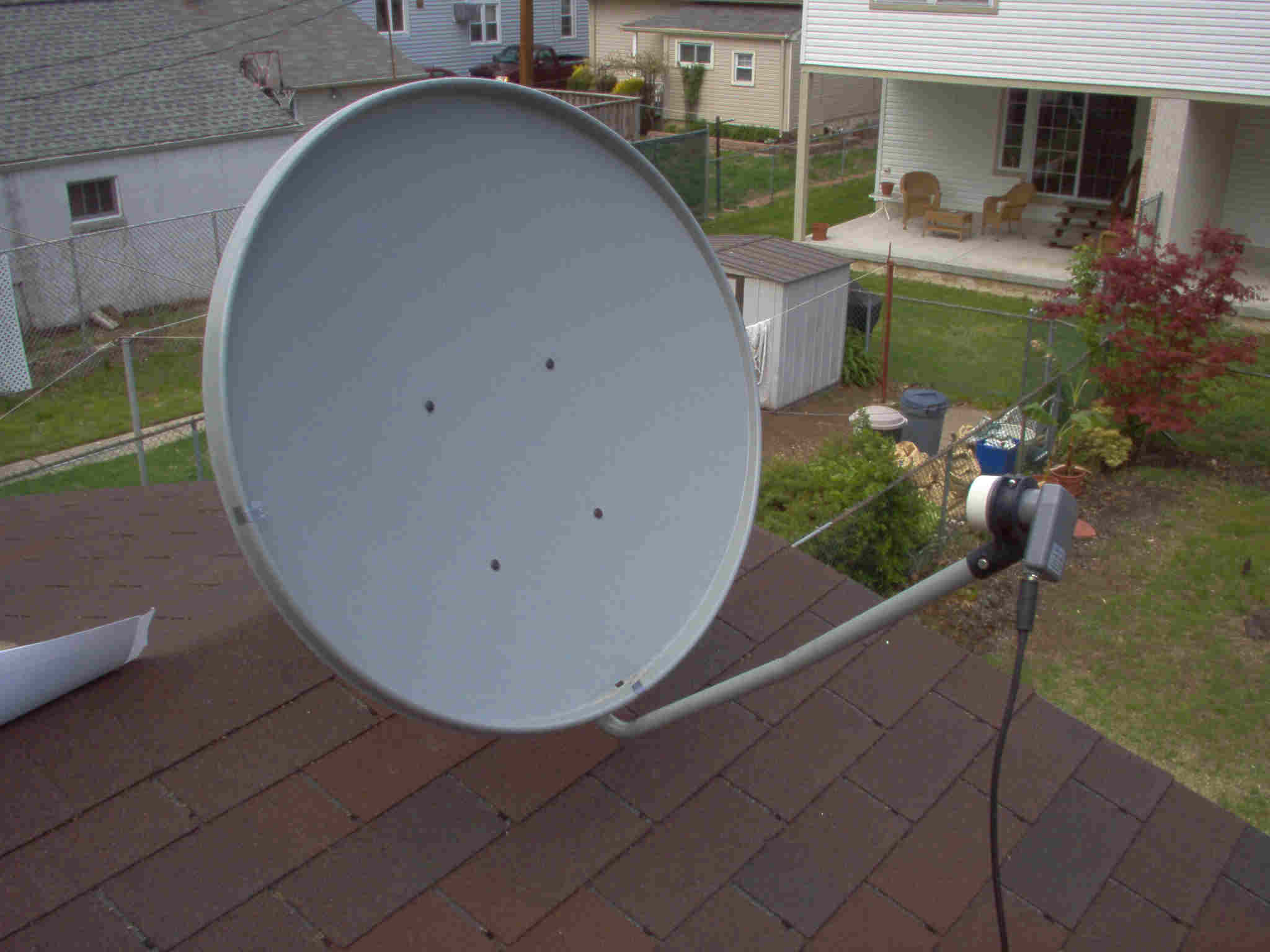

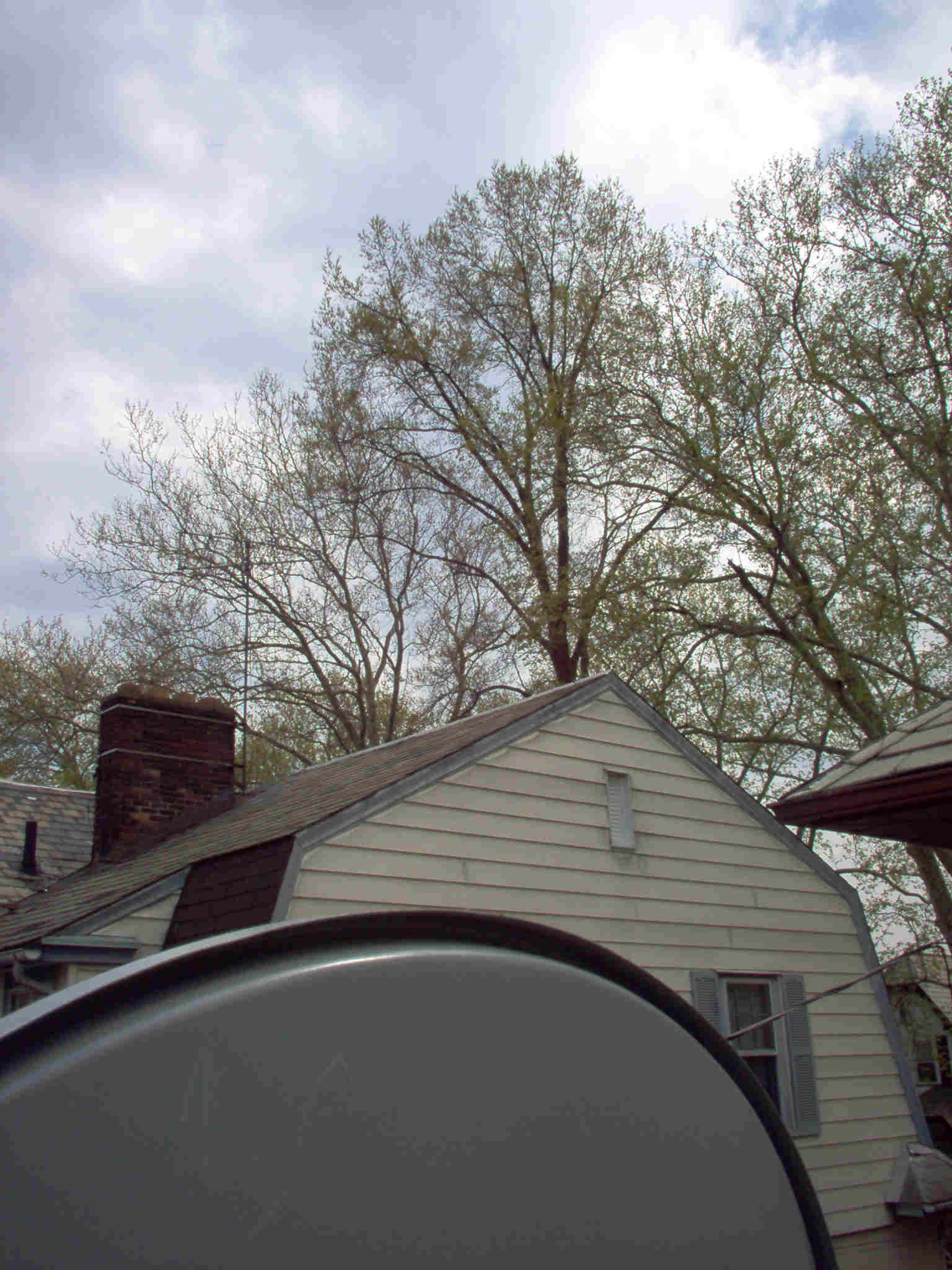

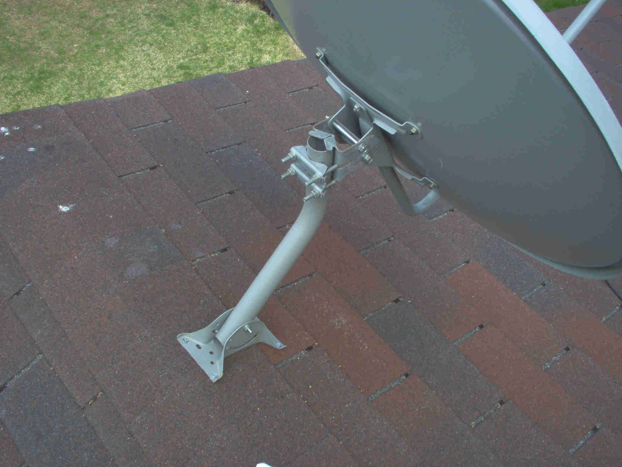

Hey guys. I'm beginning to think there is something wrong with my receiver. But I'm probably wrong! I have 2 lnbf's one is a universal the other a standard and a Traxis dvb-3500 receiver.How crucial is a plumb mount when aiming for a single sat? I understand the difference between quality and signal levels, only quality is truly important. Tried for SBS6 againtoday and still nothing.
Attached are some photos of my dish and the view of the southern sky from behind the dish. Notice the trees? They may be to high? Further below (not pictured) is my DTV dish installed since Aug of 2000 no problems and easy to setup except for the monthly payments! I figured if i could get DTV with those trees in the way, SBS6 should not be a problem higher and closer to the treeline.
Any thoughts anyone?
Thanks, Sharpee

I would let the receiver do the work for you, get as close as you can to where you think the satellite is then do a blind search!
Hard to tell what direction the dish is pointing in reference to the trees, but no signal will come through those trees!

Its VERY unlikely that the receiver or LNB is bad, they are ALWAYS the first thing to be blamed, but I guess it could happen.

I would also make sure the reflector on the dish has not been overtightened, especially with that kind of dish. It often warps the dish out of shape making it impossible to get any signal quaity. Hand tight then half a turn with a wrench is enough.
Had one like that in the middle of last winter, a customer had tried to install himself and had cranked down the four nuts on the reflector EXTRA hard.

Maybe useful to show us a picture from behind the dish facing forward just to make sure the trees are not the issue, another with both the DTV and FTA dish would also help.
hummmm, good point PSB, Ill check on it later if it doent rain again. I put the flea market lnb aside and got a brand new universal one so i could get the Cuban channel and in case anything within that frq range ever opens up.
I also "strung" the dish with a couple of strings to make sure it wasn't warped by crossing 2 strings one from the length and the other from the width.
