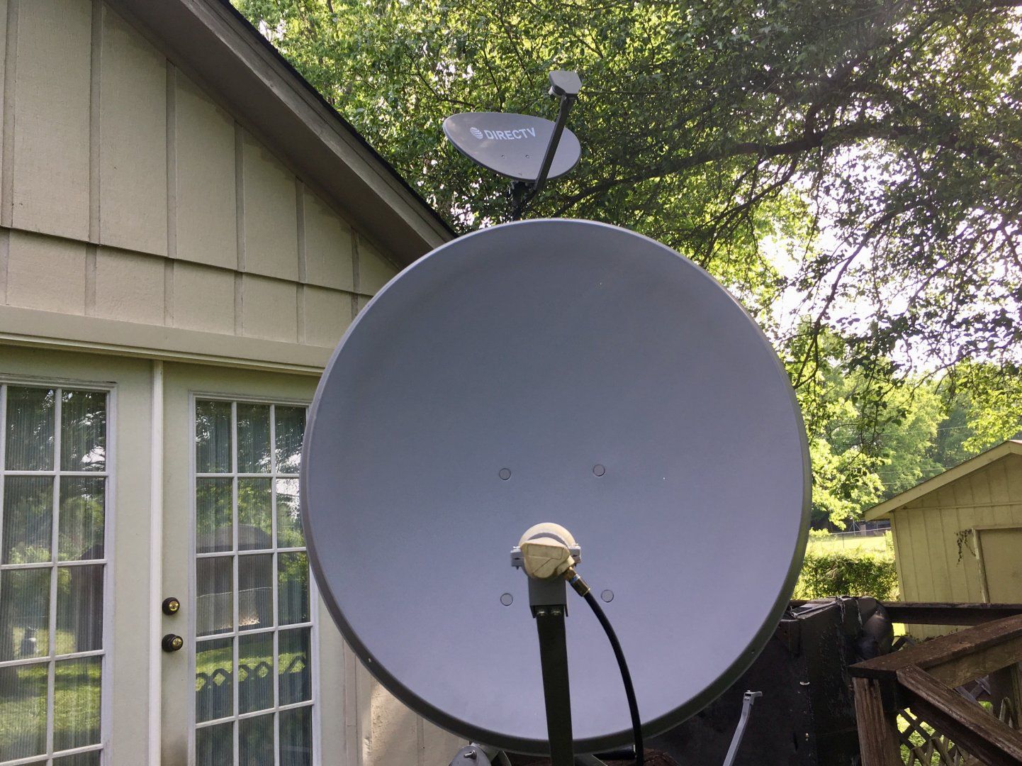

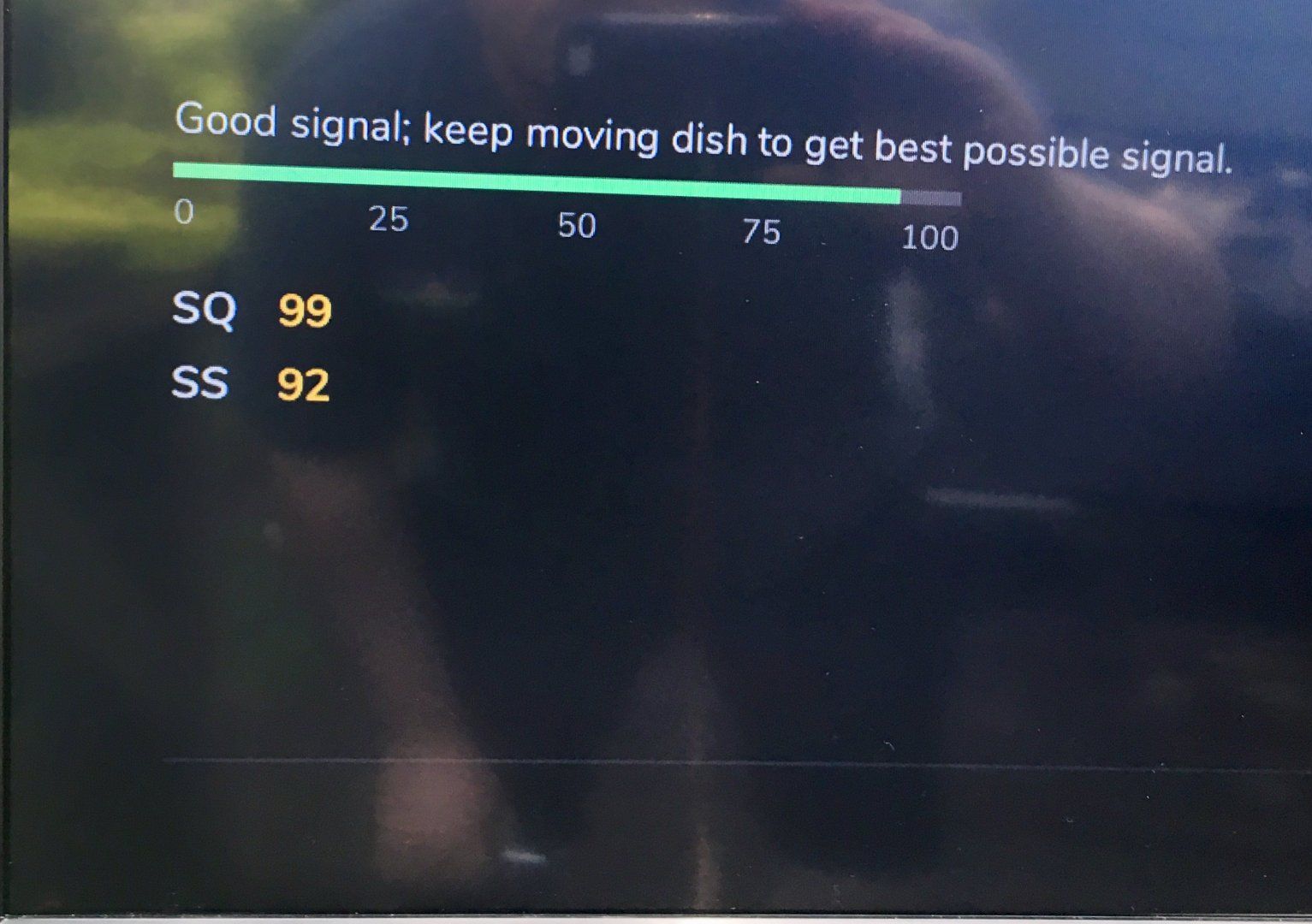

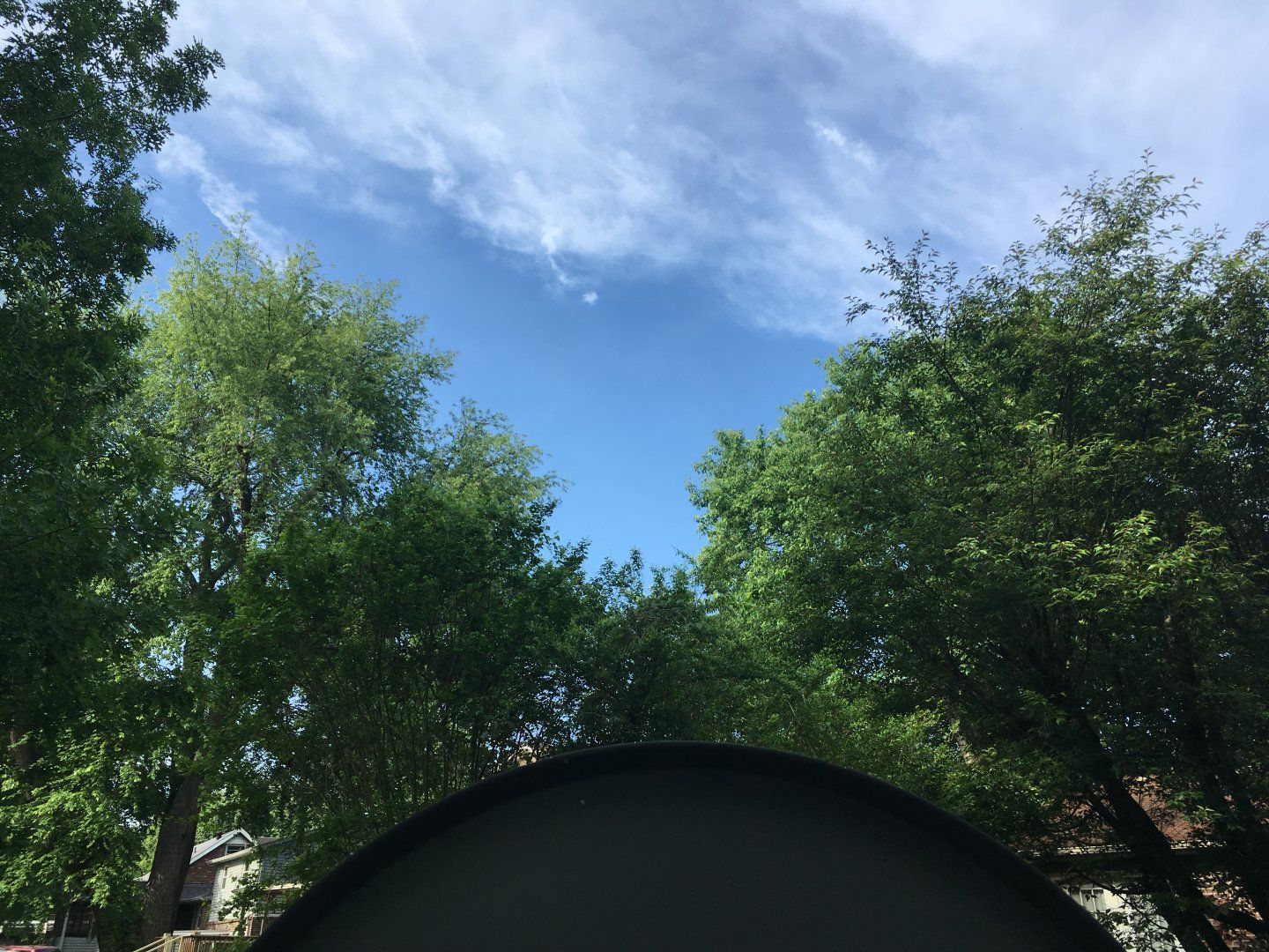

I'm still getting breakups. I'm going to put in all new RG6 quad shielded under the house. BTW, here are some photos:

The signal reading looks good on this transponder. Orby TV uses two different transponders and they are not the same strength in my area. Is this reading with the channel tuned to the weakest of the two transponders for your area?
I doubt that the break-up is related to the coax, but anything is possible. The LNBF LO frequency may be drifting if it is older hardware. This is hard to diagnose unles you had a good satellite meter or a FTA receiver with blind scan.
Looking up the bottom of the LNBF support arm, are there any branches at that elevation angle or above? Any tree branches close to the line of sight with the LNBF support arm? It looks like the trees are on either side of the opening, but there is no reference to the LNBF arm in the photos.
The LNBF Skew should be set to approx. 34.5 degrees from TN. Did you rotate the LNBF skew to optimize the signal reading?
