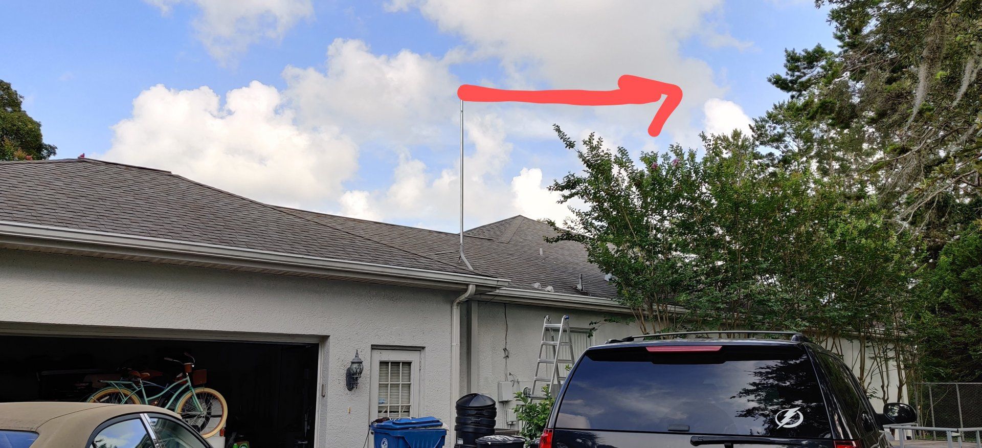

Here you go. That EMT fit so tightly in the mount the paint scraped off the inside of the mount.
It's only a 10' piece, any higher I would definitely guy it.
You can see the much higher available peak of the roof and I drew an arrow in the direction of the towers. Like I said, if it doesn't work here, I'll get a new tripod up top.
You can see the much higher available peak of the roof and I drew an arrow in the direction of the towers. Like I said, if it doesn't work here, I'll get a new tripod up top.View attachment 146110
Looks good. :thumbup I'm super cautious when it comes to stuff like this so if it were me I would guy wire it even at that height. Doesn't seem like much but once you get an antenna (or two) up there and you get some strong storms the wind load can be really bad. I wouldn't want it coming lose and shish-kabob-ing the neighbors. :D
I wouldn't trust that J mount with 5' of mast,let alone ten.
Reactions: TheKrell
I'll see how bad it feels once the antennas are up. It's not just a simple j mount, it's a tripod type.
I tend to err on the side of caution as well so if it doesn't feel 100% it'll be replaced quick.
With the just the pipe it feels extremely sturdy so far.

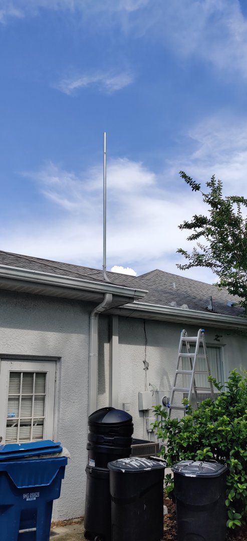

Coax cable pulled through the attic yesterday and terminated into the homerun to the TV/Tablo. Also run from the antenna through the grounding block.
The RCA Preamp/Combiner should be delivered today and then everything will be ready to go for when the antennas arrive which should be tomorrow.
We had a bad storm roll through last night and the pole is still standing...of course, there's really no wind load on it right now. My plan is to take my leaf blower up and see how much I can make it sway once installed. Not quite as stong as a good Florida storm but should give a reasonable idea of how much movement there might be. Too much and I'll get a 5 foot tripod and move it to the top of the roof line.

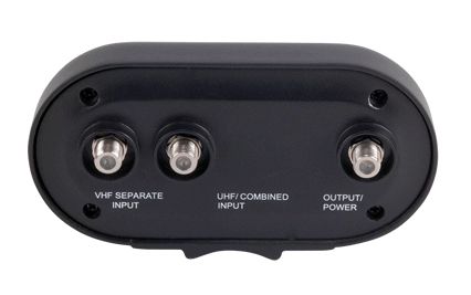

The antennas got delivered today. I got the UHF installed but it seems that RCA has changed the preamp. It no longer has a combiner built in. I checked my local Lowes and the same deal, amplifier but no combiner.

But I did test out the UHF antenna and it seems to be working great. Even picking up the VHF channels but at a lower signal strength. It still works but I'll definitely still install the second antenna to be safe.
Pole mount seems strong enough, I might try lowering the antennas on the pole and see if signal strength is still good. If I can lower it some I will to try and minimize load on the mount.

So your RCA amp does not look like this?
Nope. Only has 2 coax connections, one for combined input and one output.
I have a second one coming from Amazon cause I thought they sent the wrong one by mistake. But the one's at Lowes were all single input/single output.
Well that is disappointing. Hopefully it was just a mistake and you will get the good one this time. I was going to get another myself to have on hand since it is 'lightning season' and I don't want to be caught without one. RCA website still has the one with separate inputs pictured so maybe confirm it with them and buy direct.
