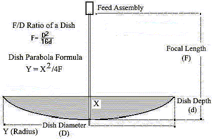

This sounds familiar and I think there is a thread about this floating somewhere here. There is an equation to find out your focal length to diameter ratio.
f (focal length) = D squared divided by 16 times C
or D x D / 16 x C
where D is the diameter of the dish surface and C is the depth.
More about that here:
http://www.geo-orbit.org/sizepgs/tuningp4.html#anchor879461
