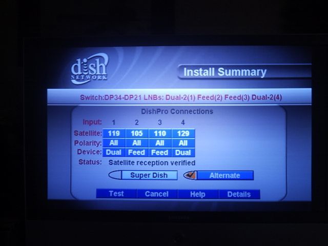

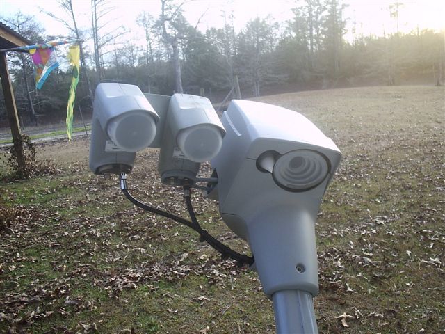

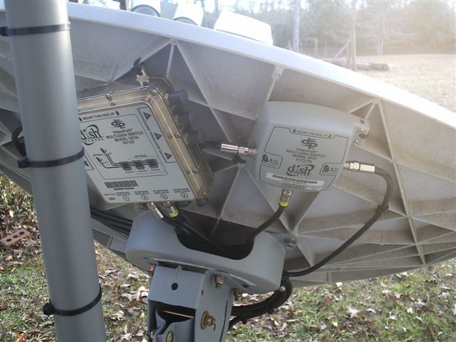

I seen the pictures from the Mad Scientist and decided to try it. Works great. I also seen the questions about a DP 34 and a DP 21 working together. This also works great. The sats are 105, 110, 119, 129 Voom, core programing and locals all on 1 dish. Here are some pics if any one is interested.

what kind of signals do you get on 129 (and where ya located...seems like closer to the borders of the US, the worse it is)
Thats a pretty good simple idea... I didnt have a lot to work with when i tried it. Zip ties and a wood block did the trick.. sheet metal will definitely let you tweak it easier. I only had my signal in the mid 80's.. it could be the difference in location i guess.. but if you've got around a hundred signal could you measure the distance between the 119 and 129 lnb's?
