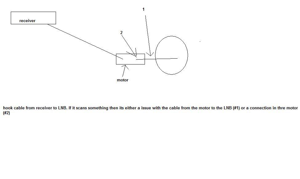

The signal level on the traxis shows 10% only. Though, I can't recall if it did the same on the geo at this point. I checked to see if there is at least some resistance on the coax and there is so I'm a bit stumped at this point.
its very possible that something blew in the motor connection to the LNB because you mention the motor moves. As long as there is a connection between the receiver and the motor it (the motor) will move. If there is a bad connection between the motor and LNB then it wont scan anything in.
If you could get to the dish what I would do is move it to true south and hook the cable from the receiver directly to the LNB (bypassing the motor)...if it works then its either a bad cable/connection from the motor to the LNB or something in the connections on the motor circuit board.
see attached (crude) drawing
