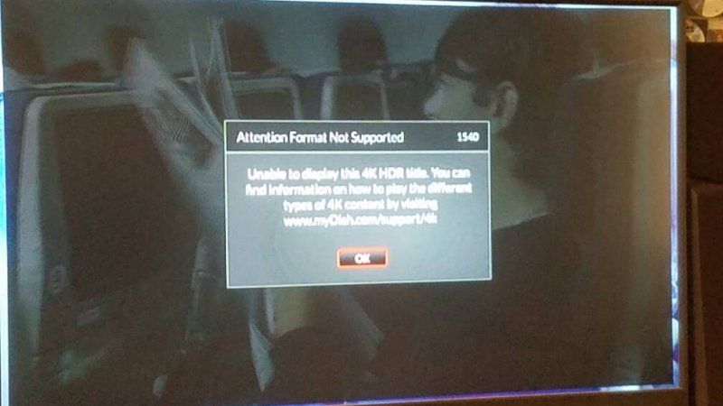

Why could the H3 previously pass/down-convert the 4K to our 1080 tv, but now cannot?
Artificial equipment verification block imposed by Dish?
Side note,
guide shows the 4K channel,
Pressing select to setup a timer brings incompatible message,
Pressing record button (below pause button) on remote allows initiating timer setup.
I have set timer to record all new and rerun programs on the 4K channel.
I don't have much of am expectation to watch them,
Expecting incompatible message on dvr/play attemp.
BUT, can't hurt to try.
Follow up.
The H3 recorded the open ceremonies from the 4k channel.
Reiterating, our H3 is connected to a 1080 tv.
The 4k program is in the dvr listings.
I press play.
The program starts.
With a superimposed shading and the incompatible tv message.
Why?
This is clearly a software forced block by Dish.
The program is clearly downscaled and is the fullscreen picture being mostly covered by the shaded window and incompatible hardware box.
Again,
Why artificially block what clearly is capable of the hardware?

Follow up.
I press play.
The program starts.
Why?
Again,
I have the same issue.
So in one household we have a non HDR 4K Vizio that will display the 4K channels just fine.
In another I have an Epson LS10000 4K laser projector that gets the 1540 error message. I was able to set a recording and start watching the recording with the error message plastered in the middle of the picture like KaptainRandom above.
I called Dish and got someone on the line and he took control of my Hopper 3. He did something that removed the error message and allowed me to view the 4K recording just fine as long as I didn't stop watching or change the channel. Unfortunately he wasn't able to make this a permanent fix, but he did log an incident report.

I recorded Olympics 4K on the H3...The 4KJ's do not show the recordings in the DVR list...Though I might be able to watch them that way!
I wish they had made the error message behave differently.
A pop up stating that it may not behave correctly, but allow you to go to the channel would have been nice. If no picture or an incorrect picture tune up, down or chose a new channel from the guide. That would have allowed me to view the channel in glorious 4K on my 126 inch screen. It looked nice for the short time I was able.
What cable do you have between the Epson and the Hopper? I had a sim8lar issue and was cured by a cable swap. Even though I was using premium certified HDMI cable, I swapped with another and the message went away.
I would have to check with the theater installer, but I'm sure it's a high quality cable. And unfortunately it's routed through the walls. It does go through a conduit, but would still be a hassle to change. I'll call them Monday and see if they have another cable I can try though.
Everything else works fine. Apple TV 4K, Xbox One S, Zappiti Media player.
The key is the cable is "premium certified" by hdmi.org. The package would have had a hologram on it.
Another person here who can't view the 4K feed. TV is 4K but not HDR and I get the error message trying to change to the channel.
I'm on the same TV, receiver, wires, and H3 with nothing in the setup changed on my end since I watched the 4K feed during the 2016 summer olympics.
So it does seem like Dish has changed something to block regular 4K users from viewing anything flagged with HDR
