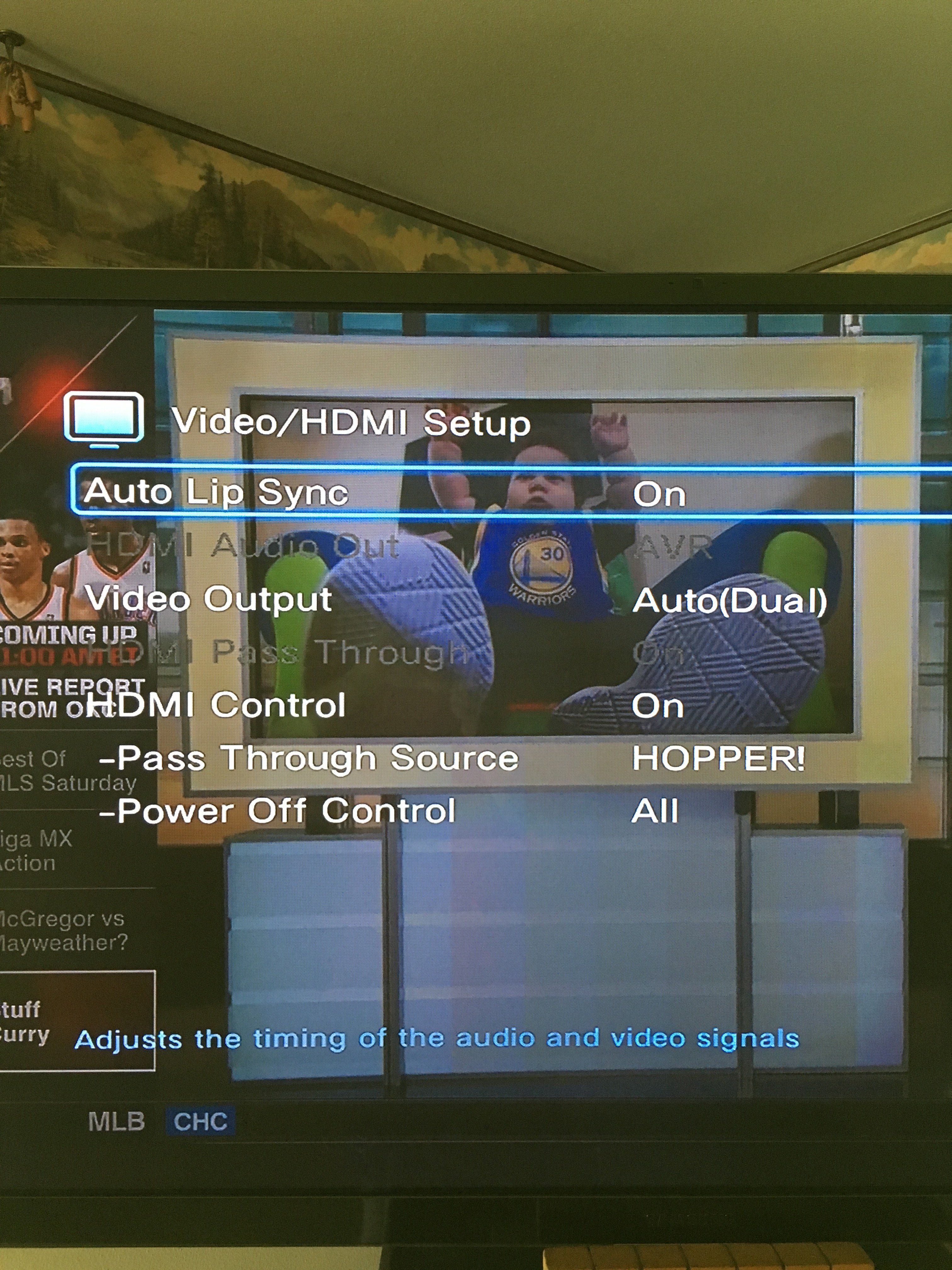

Yes I do. Here are the settings on the Denon AVR-X4000. Keep in mind the problem only exists on the 4K Joey. But since the H3 is the mother ship so to speak. It could be one or the other. IMO Thanks
You have an avr between H3 and tv?
Power the avr off and on should reset the black screen.
So at night when I leave the H3 in the main room. Go the the bedroom where the 4K Joey is I should run back to the living room, cycle the AVR on/off run back to the bedroom then check it? I fell like saying should I stand on one leg and hop at the same time, but I won't. I know you are tiring to help but that is just wrong. I know it is a process of trouble shooting. But it would be nice to know if anything could be done. Or is this a known issue. So I am not wasting my time. Thanks again.
:) sorry forgot we were talking Joey.
