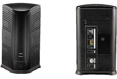

This is what I was looking at ...
I have my genie 2 connected via wifi... but yes there's an ethernet port on the HS17
People use Genie2 for a whole lot of things.
Technically, the HR34 was Genie, HR44 should have been a Genie 2 and the HR54 a Genie 3, the HS17 is a different animal all together ...
Some call the Clients a Genie 2, which they are not.
The HS17 has also been labeled a Genie 2
The only Genie 2 is the HS17. The HR34, 44, and 54 are Genies. The clients are just clients.
