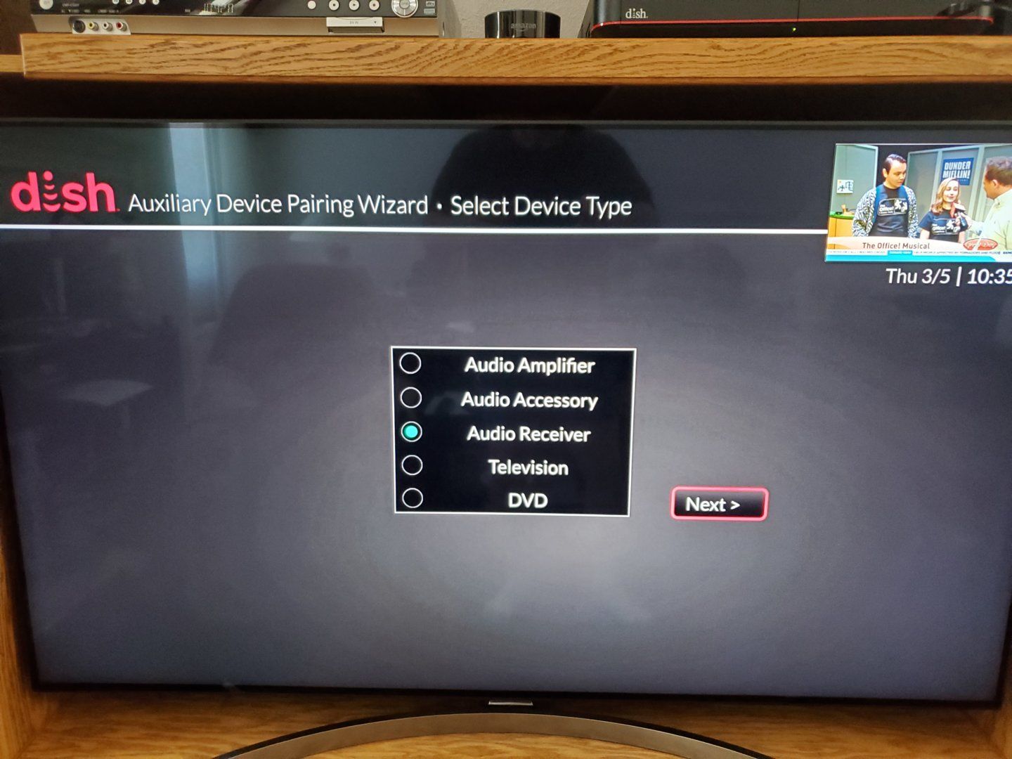

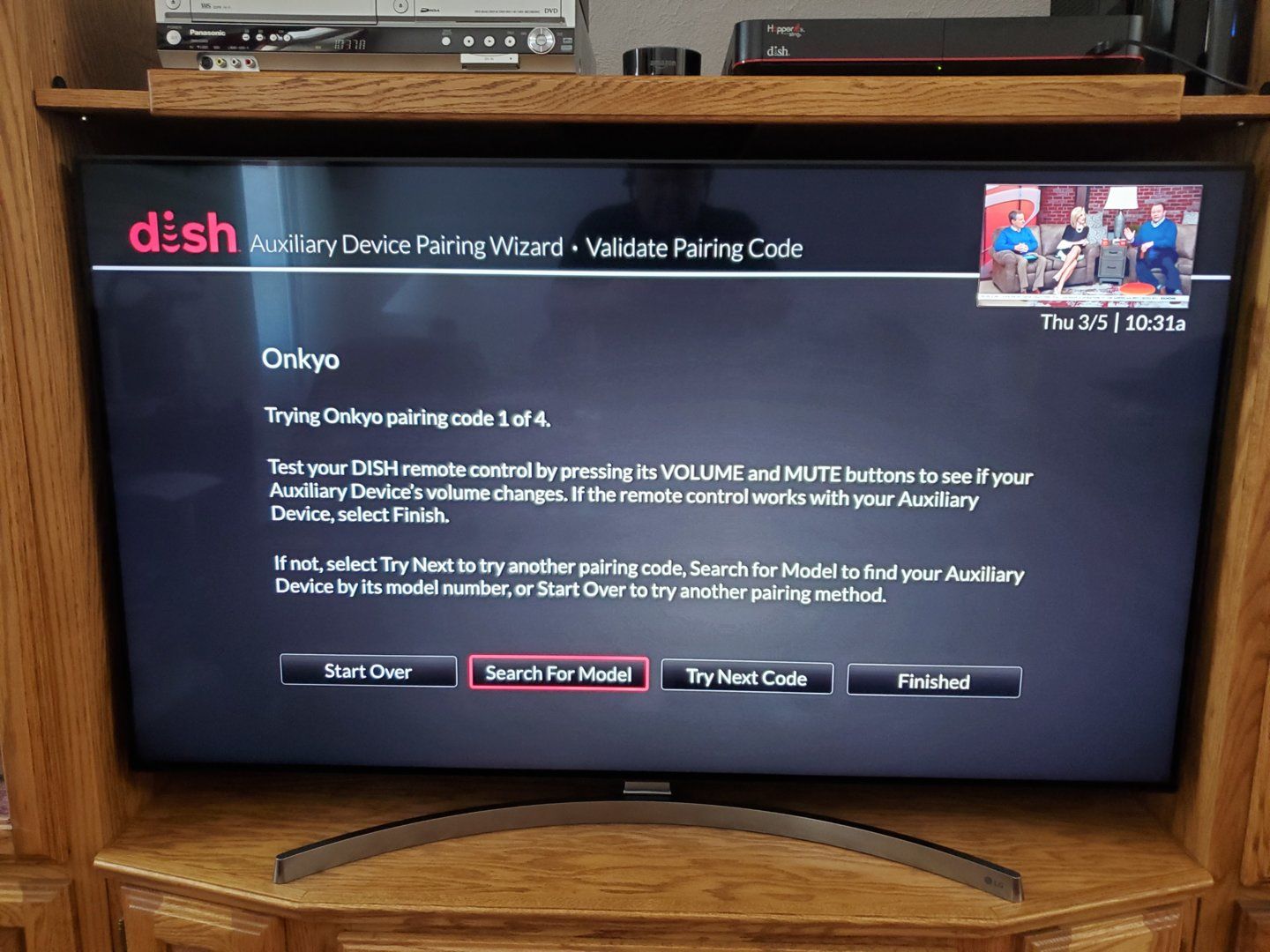

No telling what happened to cause the issue. I just looked in the Remote Control settings. After you select the Brand Onkyo and then hit the next button, in the next screen select the Search For Model tab, then enter your model number. It is worth a try. Also I notice in the menu there are three audio selections. Did you try out all three? I know this might not make sense but you need to try something to get it working again. You can also try the Teach Commands method too if all else fails. I presume you did a Hopper pull the cord reset!
Thanks, I did now see the Search for Model option. The exact model is not there, but I did choose one very close. Still no power on.
