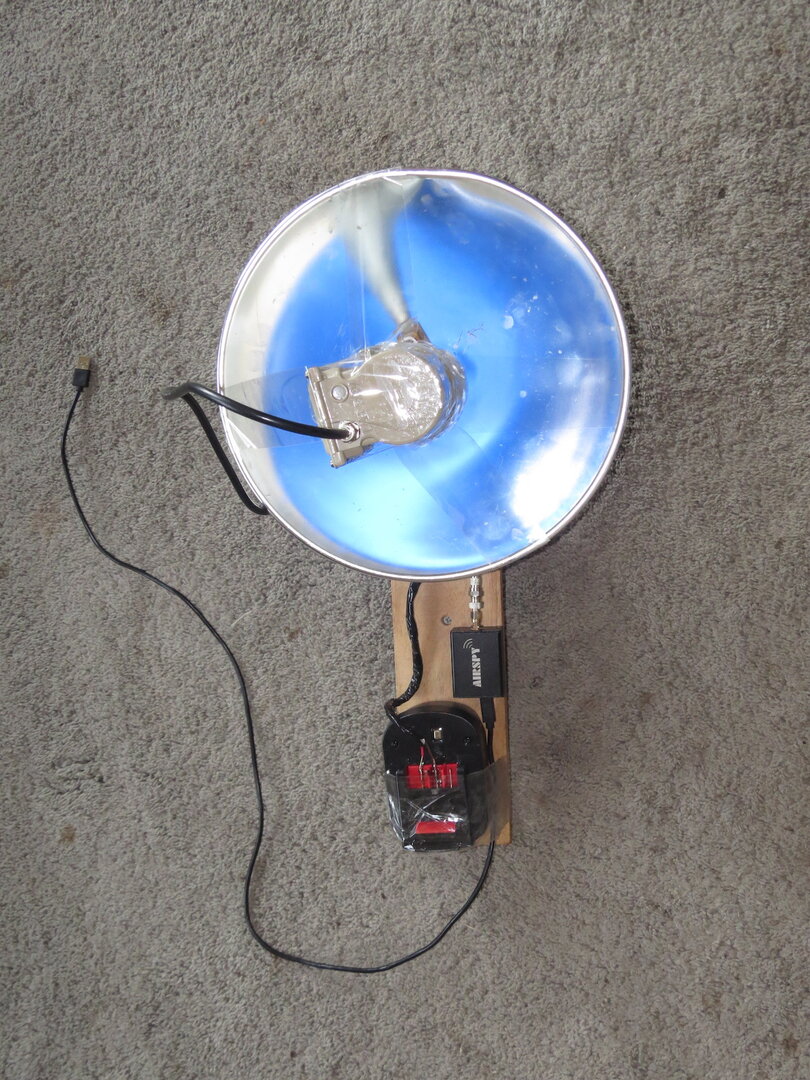

But the one I plan on building will consist of a laptop computer, an SDR (software defined radio), an unfiltered C-Band LNBF, a 13 volt power source with a bias tee to power the LNBF, a 12 inch wide parabolic dish and my SDR Program named DR Processor running in wide band mode. Or I may decide to use another SDR program: Spectrum Analyser
I have strong 5G interference in my area. I intend to find where it's coming from.
I finally found time to build a 5G hunting device (photo below). I'm using a 12.6V Lithium Ion battery from a cordless drill to power the LNBF. I installed a DC blocking capacitor to protect the SDR from 12.6 volts.
For this project I used the CTC (Clear Tape Construction) method. :) It's not elegant, but it will suit my purposes since I will not be using it forever.
For improvements I should add an on/off switch for the 12.6 volt battery which powers the LNBF. For now I just unscrew it from the LNBF when not in use. I also need to find a better cable for my Airspy SDR (the one that has a choke).
Am now going to setup my Windows laptop with the Airspy software and an SDR Program that can do a 100 MHz at a time.
Hopefully later today I will have it all working and will find the closest source of 5G band N77 in my area. I just hope that no one calls the police on me thinking that I am spying on them. :)

I tested my new 5G finder using "Spy Sweeper", which can cover 500 MHz at a time. But most of the time I had it set for 100 MHz bandwidth for faster update speeds.
First I tested the directionality with a 500 MHz bandwidth. When pointed at the Clark Belt I could see the signal intensity increase. When pointed down the signal dropped substantially. So I conclude that I have a directional antenna.
Next I had my wife drive me around town with the bandwidth set at 100 MHz in band N77. I noticed 5G spikes mostly in the direction of travel, or behind us. This makes me think that its coming from 5G cell phones in cars.
When we drove through residential neighborhoods, the signal spiked at times as we passed certain houses.
So it seems that I have found end user devices with 5G (lots of them), but not the tower that serves them (yet).
Looking forward to doing more hunting and finding the 5G tower, or street light with a mini 5G node on top.
