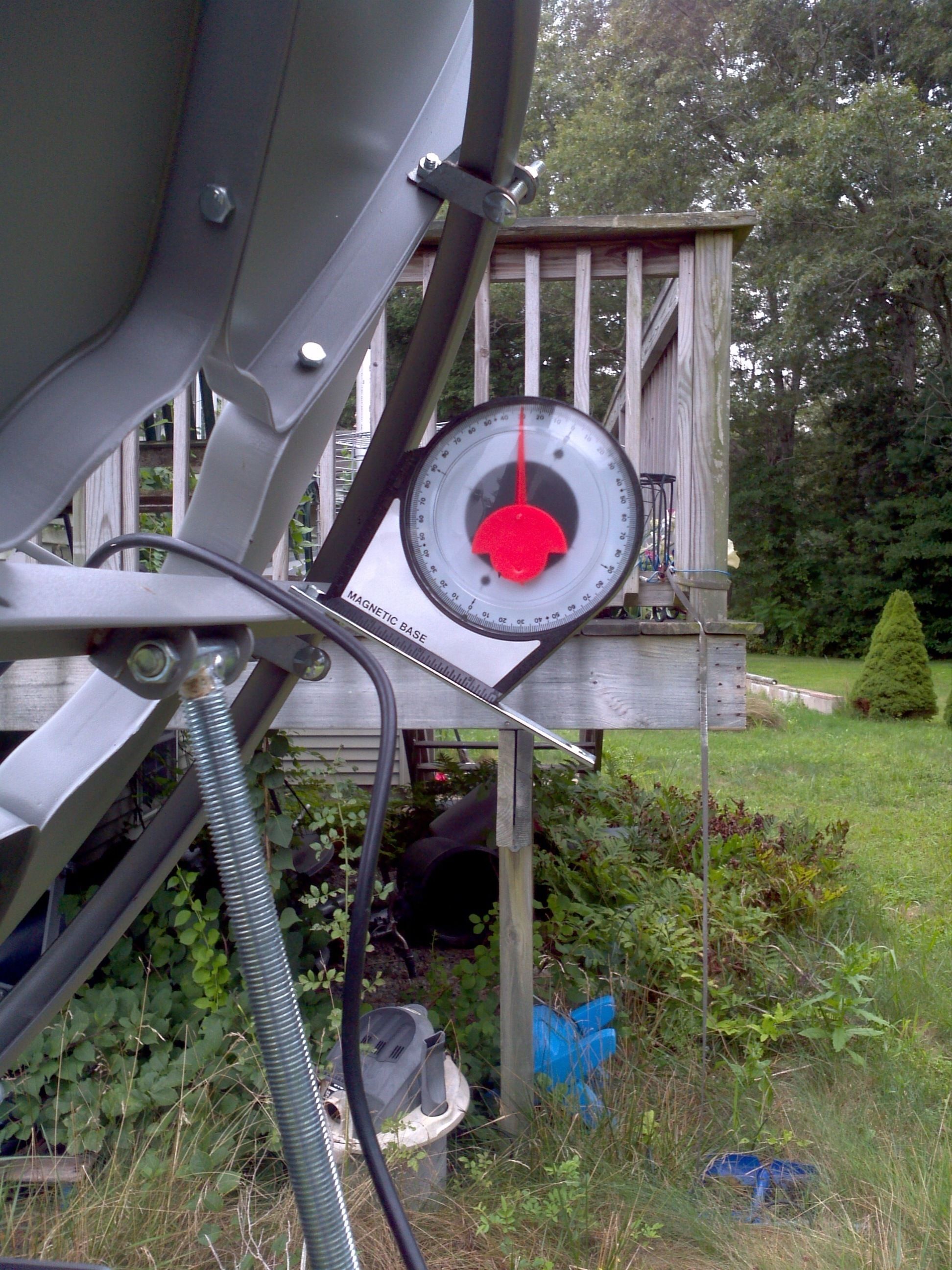

I have two questions :
Regarding the dish elevation. Using dishpointer (website) I found that the elevation for my dish should be 31.8 for NSS 806. I have an inclinometer, I mounted the inclinometer as depicted in the attached photo. The inclinometer is parallel to the surface of the dish. I then adjusted the dish elevation to be 31.8. Do this sound correct?
Regarding the focal length of the dish. My dish is 6 ft (72 inches) in diameter and I computed the depth of the dish to be approximately 11.5 inches as follows : (72 * 72) / (16 * 11.5) = 28.14. The scale on the Lnb I am using only goes down to 34. Is my calculation correct? Should I simply estimate where 28 is on the lnb scale or should I use the 34 ring.
The scale on the feed/scalar should be set to the F/D ratio.
Focal length / dish diameter.
6ft dish. 72
28/72= 0.38888888888888888888888888888889
?set to 39
