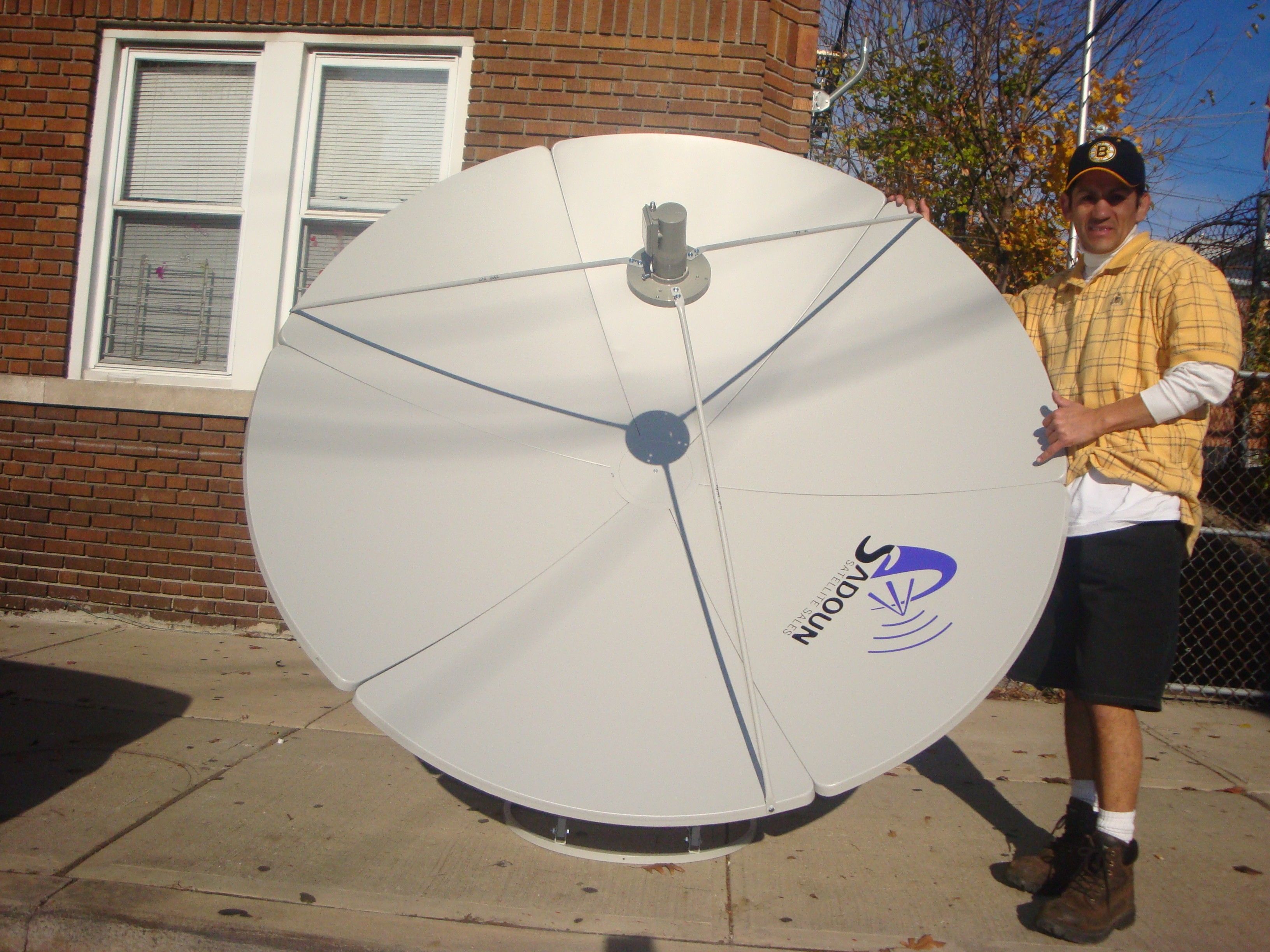

i just found that 6 foot fortec star dish is kind of same QS as the 10 foot.
maybe just for 14 counts or less. but i really like my 6 foot tortec star from Sadoun. good quality dish, not heavy and y can take it easy where ever you want.

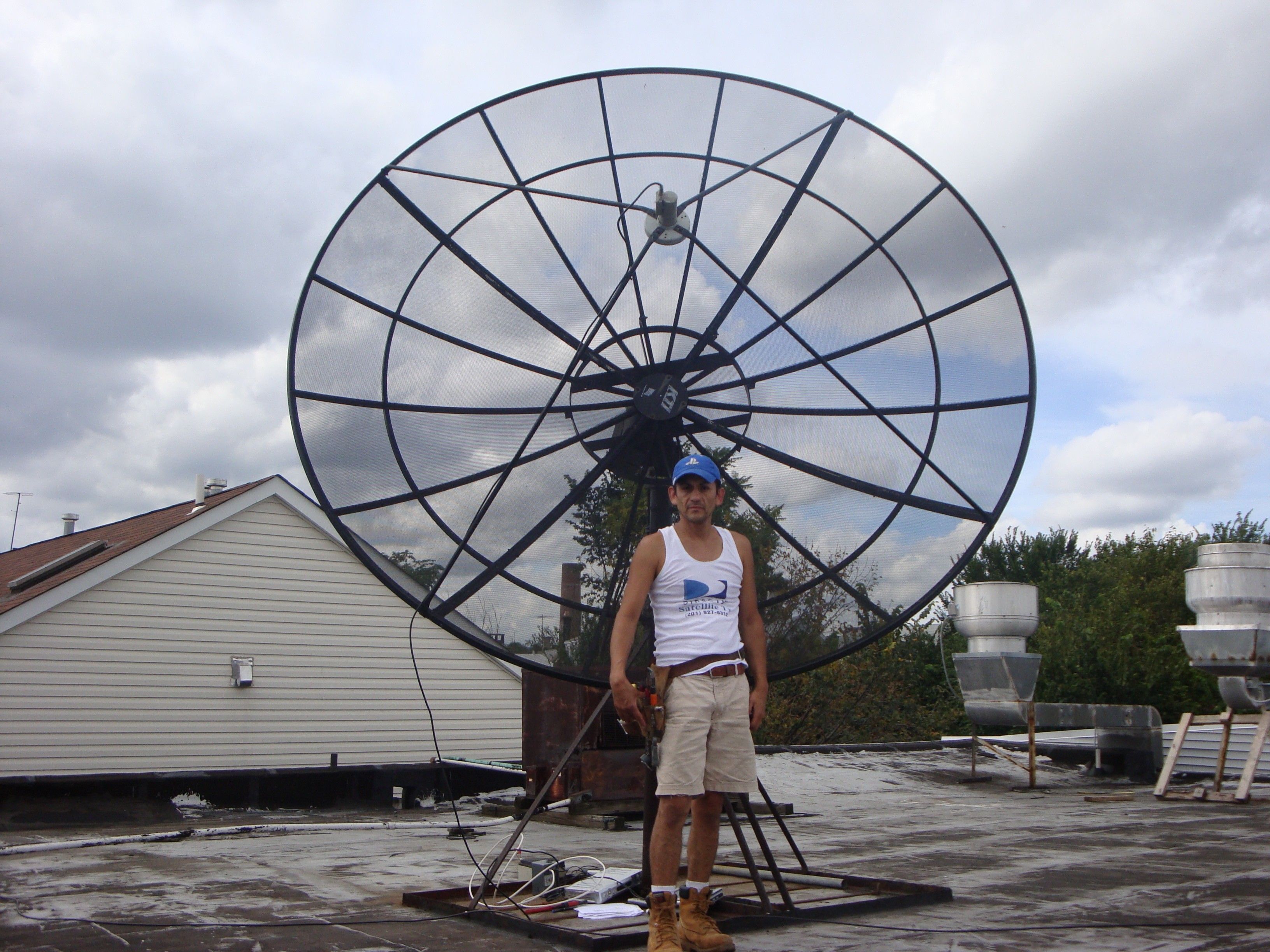

Well i got 8 foot fotec star dish , this dish is really big, I never try to even open from the box, well i got 2 of those. but my Question is. tis 8 foot will be have the same or more Quality signal than the 10 foot.
if someone can answer this question , i really be happy.

sorry mistake foto
hello guys
i really make a mistake with second foto, here is the one
manny
. . . but the real question is:
. . . why isn't your 10 foot dish doing better?
Maybe not aligned fully?
Maybe the LNBF?
Maybe the mesh is sagging or damaged?
I don't know anything about KTI 10'er, but would expect significantly better C-band than a 6' dish.

For RFDTV on AMC1 103ºW, I went from 36% quality on my 6' Fortec star, to 99% quality on my 10' mesh I use now.:eek:

Thanks for your business and comments about our dish This is actually a SADOUN brand dish and not Fortec Star dish.
~ It is a thicker dish than the Fortec (0.8mm vs 0.6mm)
~ Galvanized steel
~ Heavier duty mounting brackets and hardware.
The 6ft dish will get almost 90% of the C-band signal out there with enough signal quality to keep a lock on the signal. Bigger is usually better since the dish will collect and reflect more signal from satellites.
I am happy with the 6ft dish and user reviews have been positive the last few years. We will introduce an 8ft dish this year. We don't expect the sales volume to be as much as the 6ft dish due to weight, box size, and shipping costs.
