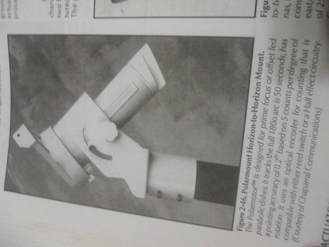

Though I have never seen one, chaparral made a h-h motor.

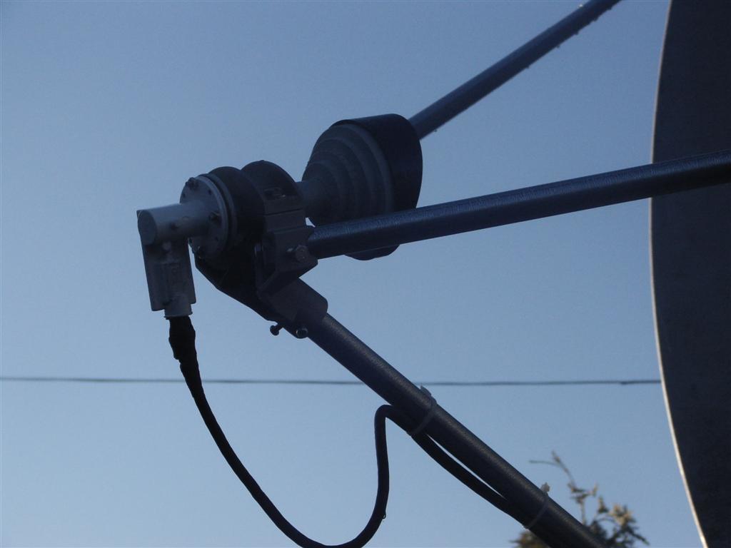

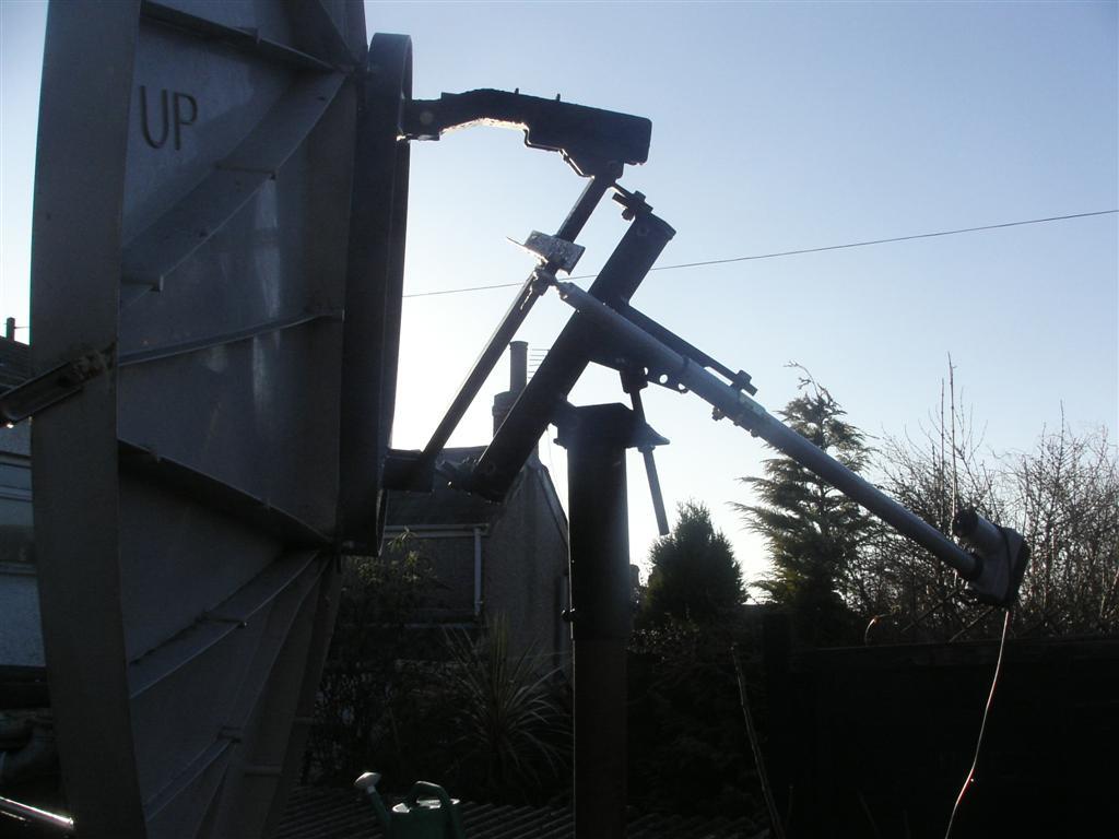

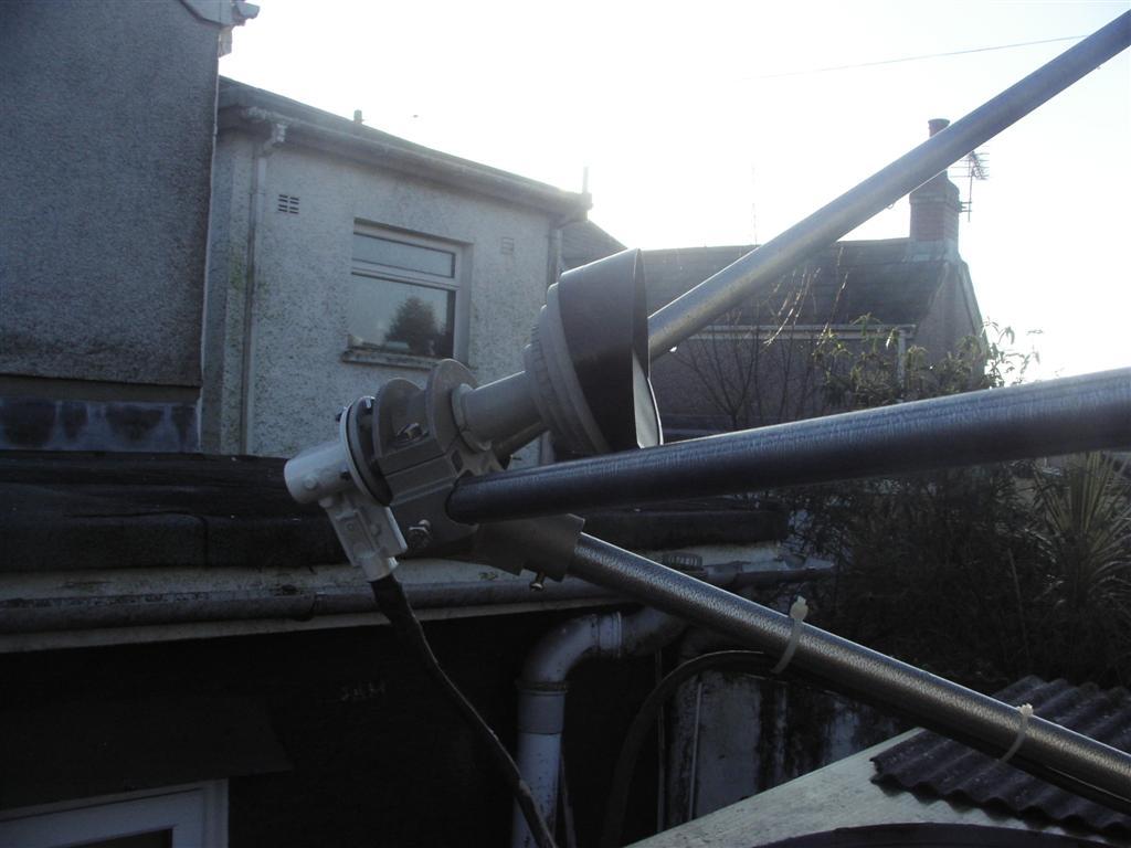

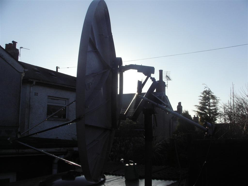

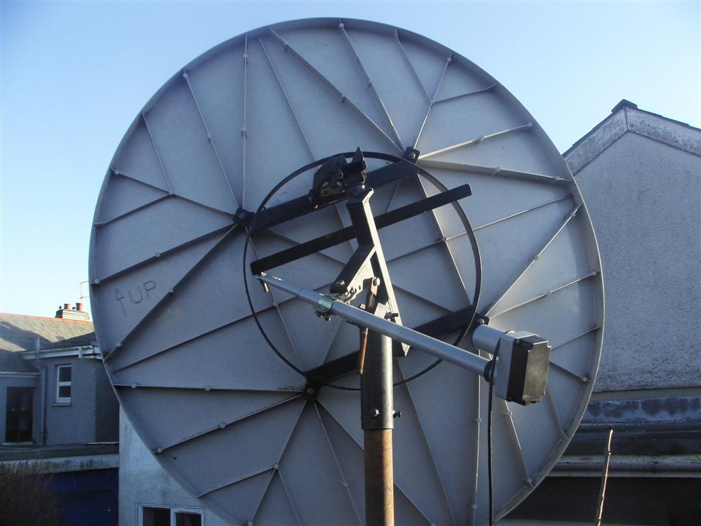

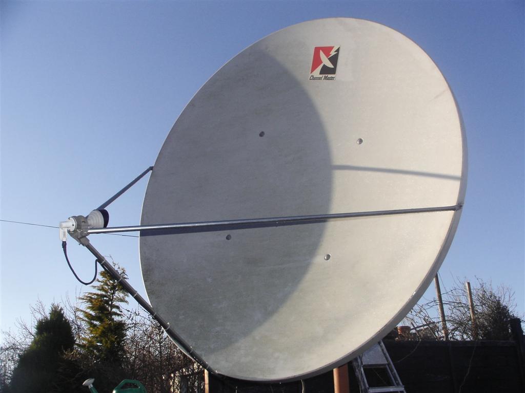

On a more serious and useful note, here are pix of the 6' Andrew/ChannelMaster dish on a BUD mount.
Note the bracketry to tilt it forward/down.
That compensates for the up-look of the offset dish.
Check the dish specs, but it's around 24°.
I've seen the hardware sold in stores in the UK.
Here in the USA, we usually just build our own.
These pix show the matching Ku feedhorn and LNB, as well.
