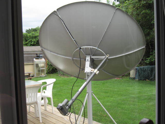

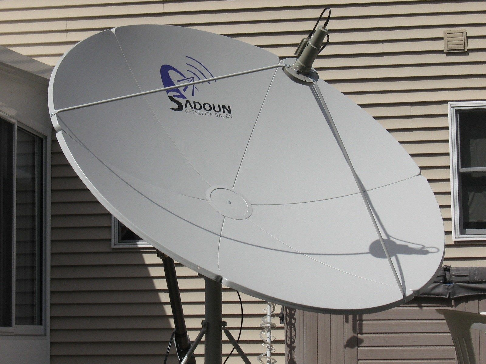

I have a dual c band and k band system set up. the k band is a 1.2 satav dish with dg380 and a sadoun 6' prime focus with a v motor. the microhd is connected to a 22k switch that either feeds the k band or c band dish. get a very good k band signal and acceptable c band signal. charlie
Heres mine using a 741 c/ku standard LNB.I have gotten very good results on both ku and c.There are a few c signals that i cant get with a 6 footer but a high percentage including s2 that i can get.
