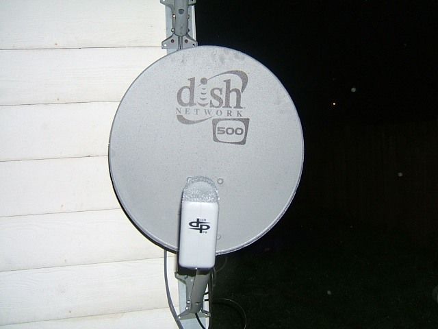

Well at about 715pm they indy installer showed up. His name Jeremy. Very nice guy and very apologetic for being so late. I told him is was all good. Just happy to see him.

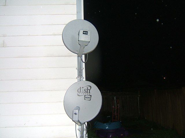

He went to work right away. He put up new DPPlus dual on my Dish 500 for 110-119. Then wasted no time with a lousy dish 1000 and put up a separate Dish 500 wing for 129.
Then just as promised pulled out a shiny new DPP-44:D Took down my DP-34 and said I could have it. I said you keep it. He was very appreciative.
He peaked sats and did great job with wires. All in all this part took him about 20 minutes.
Said he has had some fix jobs that were scheduled for an hour that took much more and he was an hour or more drive from last job. Said he gets lots of Dish nets weekend and overflow jobs. Seem Dishnet may not actually install on Sat and SUn in my area and farms out to indy contractors.
In my cast I feel very lucky to have gotten such a true pro. He knew what to do and did it. Very clean job.
Then to the inside. We put the power inverter for the 44 at the 622. Also I plugged in my big Channel master dual fly swatter off air antenna on my roof.
Checked signal and 129 was at 76-79 YES!!!!!! He said it was the highest he had seen yet in our Seattle footprint. He said if he used the 1000 it would be about 46-56 at best. Lots of fade. I still am going to convert 129 to my old Voom 30 inch dish. Hopefully the DP rectangle LNB from Microtel will work with the Dishproplus setup already into the 44.

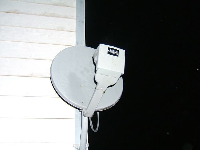

Oh good. Glad to know that. Whenever I've been using a 44 switch I've been using nothing but duals on the dish because I was getting a little higher signal. I can't tell what kind of DPP Twin you have in the pic but I know there are 3 different makers. You obviously have one that is better than others, probably Sharp. The last batch of twins I got said Sharp Electronics on the box. There are other twins that are very lightweight and feel like nothing is in them, could be why I was having trouble before. :D

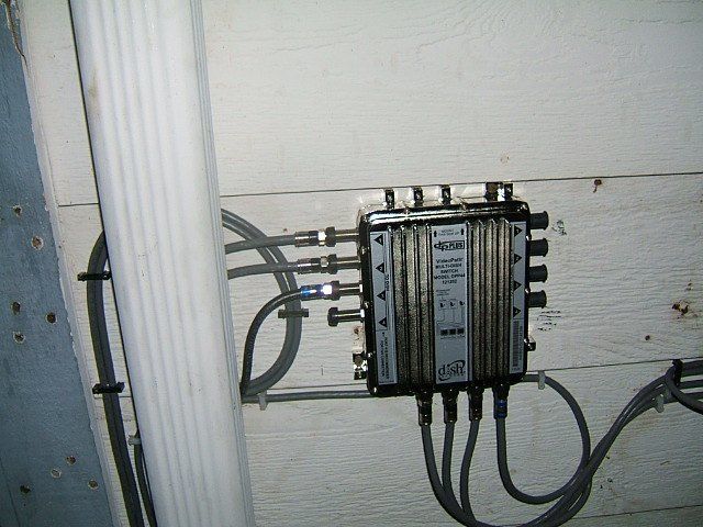

Ugh. One problem. If a tech is going to take the time to use weather-proof boots on a switch that's mounted outside, he should at least use some that cover the ENTIRE length of the input post.
And I won't even get into a discussion of absentee grounding.
Just my two-cents.

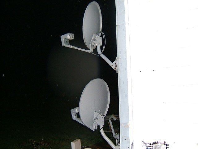

Is that D500 with single DP lnb aimed at 129 or 148? If it is aimed at 129 it sure looks like it is a quite away west compared to the other Dish, also it appears in the photo that the lower dish is skewed a little. I have an install for 622 Tuesday afternoon and might try to get installer to change my DP twin for 129 to a DPdual which I have already but don't have an "I" adapter for, if this happens I might try a little skew. My signal strenghs right now with the DP twin are from 67 to 85, but I have discovered that all the higher signals are for tps that are not transmitting the channels that we get.

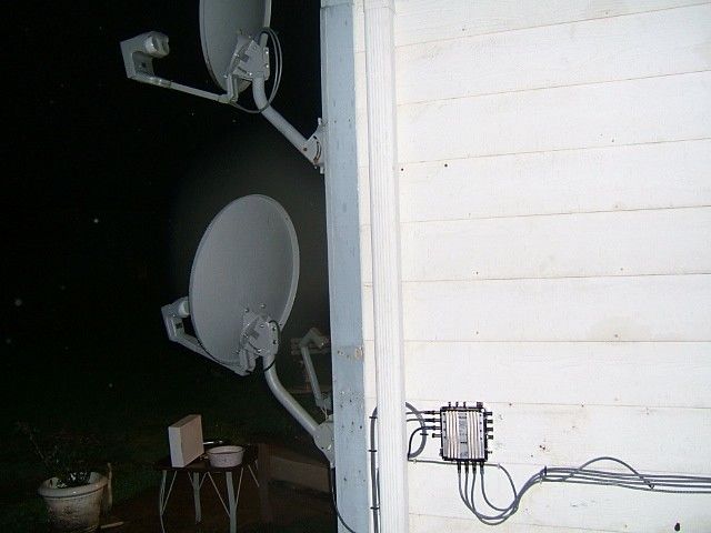

Yeah - Unless the grounding blocks are somewhere out of the pictures, they certainly seem to be absent. Iceshark - you should confirm that. No grounding = code violation = QC failure! The dishes themselves should also be grounded, check that too. If you don't have grounds, get them back there to correct that problem!
My 1-cent worth; webbydude got the rest...
Just my two-cents.
Ya I think as it got dark he forgot the boots. Luckily I have extras from my old 34's. Covered them today. As for the ground I told him to leave it as I have a ground strap on a water outlet about 5 feet away and I want to run my ground strap myself to hide it. GREAT OBSERVATIONS!
The one thing I would challenge is the dish ground. I have never ground the dish. Just the cables and switch. So please share some wisdom on that!

As for dish 500. Yes its pointing to 129. The twins are on 110-119 yes they are skewed to my zip. (Wa state) Great signal on all.
Both dish and the indys will talk you out of dish 1000 as it will get you only 45-53 signal on 129 when 110-119 peaked.

Lastly the indy installer was better then any high turnover poor trained dish installer I have ever witnessed from our local dish unit ( I know you other Dish installer here ROCK! No offense intended) He gave me what I wanted, stayed late at night to get it done when Dish local guys leave at 530 tops and I told him to hold off on the ground strap for myself to do it. It is currently grounded on a ground block not in the picture on 3 rg6 runs into home. I just need to ground dpp-44 and an waiting to get some feedback on the idea of grounding the actual dish.
622 Install
I didn't see a cable for your 148, is that still part of your system? As to grounding the 44 switch, I think I have read that it should not be grounded, only cables and dishs.
Good call Dan, I just read that as well! So my cable grounds are fine. Still have never grounded dish as it does not call for it on Installation manual. Plus no lightning around here like the midwest. But I will if I can hear the benifits?
