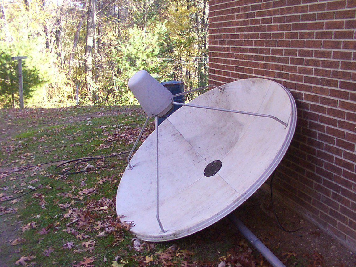

Here's what a 6 footer looks like. The mesh in these is fine... same mesh they used in their offset dishes...

Guess I just never ran into any of the 6 fts. But then I wouldn't have installed one for it was really not what was needed back in the old C-band only days.

That dish came from the C band only days. There were lots of systems sold as Galaxy 5, or G5 systems, as when G5 was launched it was the most powerful satellite in the sky. This was before 2 degree spacing, and when it was installed I noted that it didn't handle close spacing very well so it was relegated to mainly AOR use.

Yeah I remember G5 only systems never put one in though. Most ppl just didn't go for having only 24 chs. Smallest I dealt with was 7.5. I did have a portable 5 ft az el dish but really didn't do much w/ it. Just really a toy that I wound up having.
