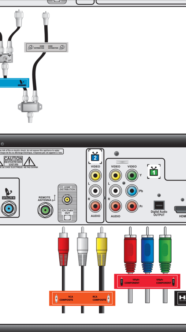

The 722 hasTV 2 composite output.I assume the OP knows TV2 is SD only.. Screenshot_20191126-052612.png3 wires.Yellow,red,white,..Have to put the receiver in Dual mode .. open front panel and push button for switching between dual and single mode..

I ran my basement off TV2 for years using an HDTV down there, but this has a major drawback. You cannot get anamorphic widescreen out of that composite output without putting the 722 into solo mode. You can get DVD quality out of it, which looks decent on an HDTV. But with the aspect ratio screwed up like it is, you can't even correct it at the TV.
Thanks for the replies! Yes, TV2 is composite out only. I believe what confused me is the fact that I had run it out to a DVD recorder, then I had run the component out of the recorder to the component in of my older TV. The 722 has been great over the years, just wish it had two HDs out. I'm still occasionally transferring stuff to a Pana DVD recorder (DMR-E18) to free up space on the DVR.
