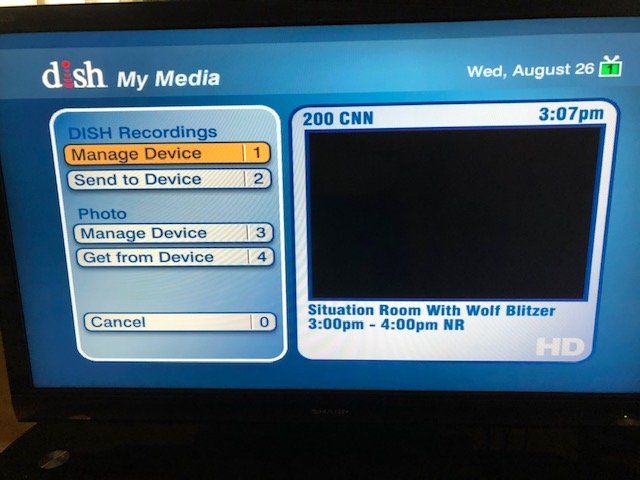

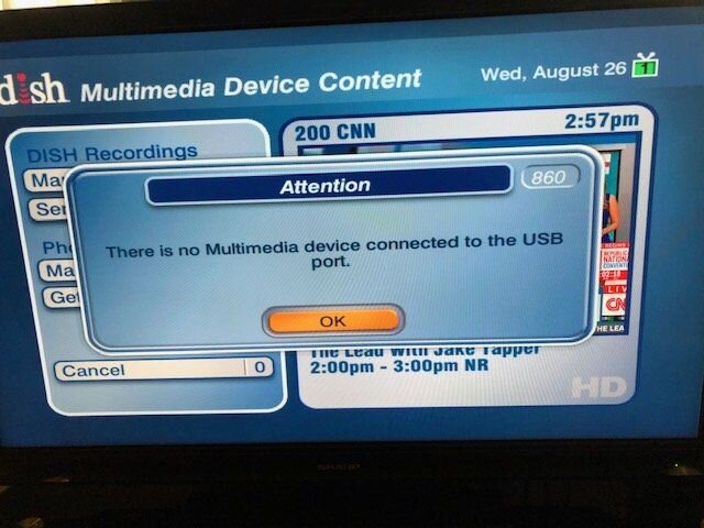

If i reboot the receiver with WD HD connected and go to manage media, I get this screen (see Photo 4093) and the device freezes. I can only use the remote and unfreeze if I remove the WD HD. Then I get this message (See photo 4094)

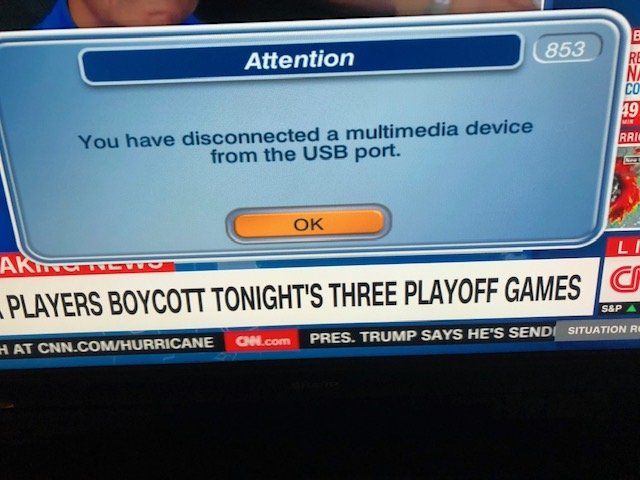

And sometimes it produces a message that this is an unsupported device. See photo.

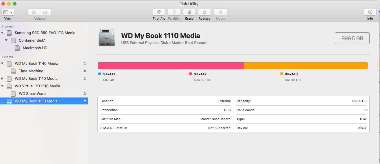

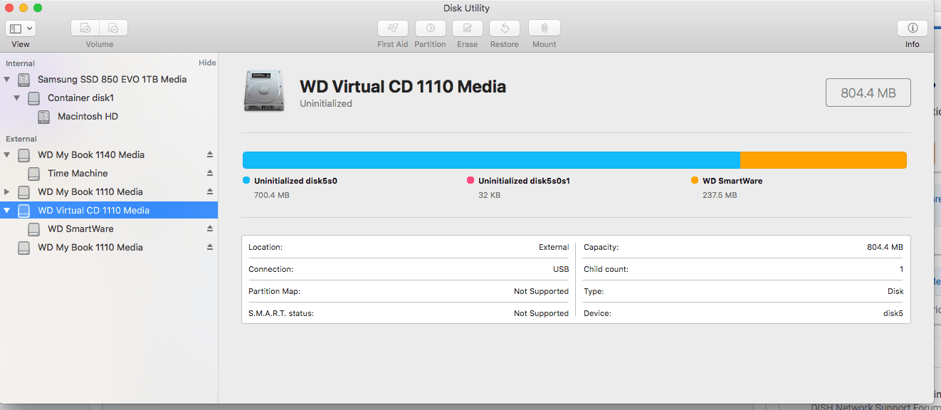

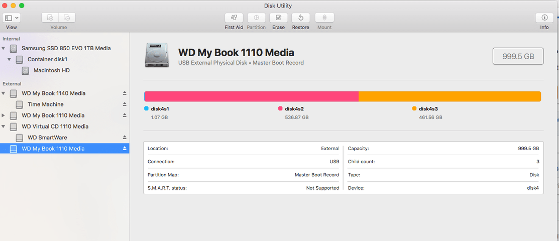

FWIW, viewing the HD on my iMac with Disk Utility, I can see there is data on the rive but don't see a partition. See attached photos.

Sounds like an external harddrive failure. Its unlikely you'll be able to keep your recordings. My recommendation would be to send in the HD to a data recovery specialist and see if they can transfer your data to a new drive. If you get a new drive I highly recommend going with an enterprise drive. It will cost a bit more, but they're also designed to last longer.
