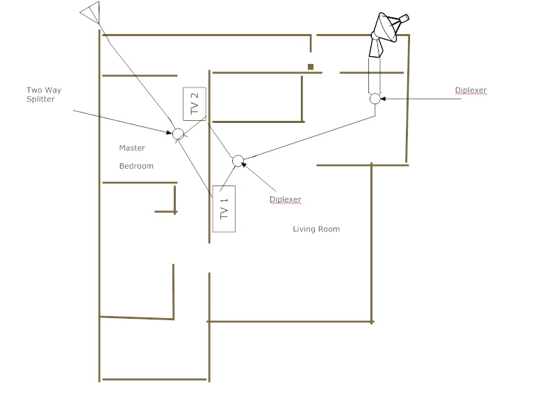

Is this how I should wire it up? (Keep in mind all the wiring will be ran up underneath the house in the crawl space.)
EDIT: I think the bottom diplexer should be a seperator ? Yes?

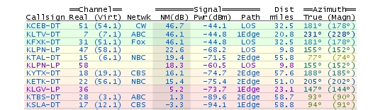

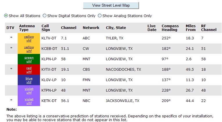

Looking at your TVFool report, which has better information than the Antennaweb report, the DB8 was probably a better decision after all. The DB8 will do a much better job of attempting to catch channel 7, which a DB2 wouldn't do well at all.

I am going to put the DISH and the OTA antenna on opposites ends of the house (just like I have it showing in my drawing) so I will run separate coax for the OTA antenna and Satellite. (Reason being is that there is a less obstructions for the OTA Antenna on the other side from the DISH.)
EDIT 2: I'll have a VIP 722k receiver for each TV
So I take it this is how everything would be connected?

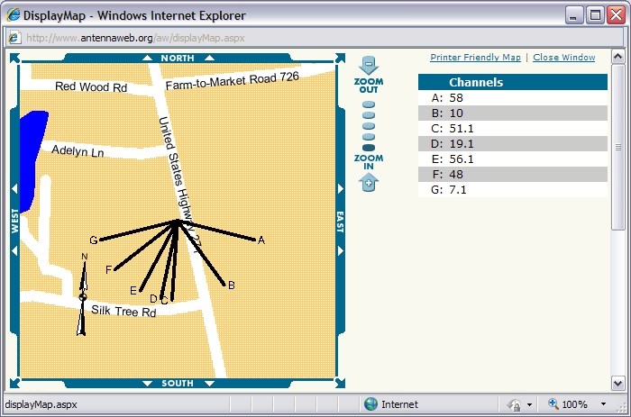

Well, you can see how much more information TVFool has, so I'm going to assume that's not your core question. ;)
The previous image from Antennaweb indicated that you were much closer to the Lubbock (?) towers, which also means that they're farther apart on the horizon. The DB2 has moderate gain (works at up to 30 miles) and has a very broad beam width. The DB8, in contrast, has lots of gain and a narrow beam width, which means more gain at longer distances, but the towers have to be closer together on the horizon. The DB8 and other 8-bay bowtie antennas also work better for VHF channels (7-13) because of that big, wide reflector on the back. DB2s and DB4s rarely work for channel 7 at all unless you're less than 10 miles from the VHF transmitter.

The error in your drawing is that there will be a single run of dual-conductor RG6 running all the way from the dish to your living room reciever, and the second conductor will continue on to the bedroom receiver. Each receiver will have a separator from the RG6 to the Sat1 and Sat2 inputs on the box, and a separator comes with each receiver in the box, so you don't have to buy anything extra.
What's the diplexer right after the dish? unless you are inputting an OTA antenna you don't need one. Is that supposed to be a switch?
Here's how I'd do it....
Antenna on one corner, dish on the other. Run single RG6 from the antenna to half-way to the dish, run dual RG6 from the dish to the same point (half way to the antenna). Drive a grounding rod at this mid-way point, ground all three wires on a block here.
As the three leads exit the ground block, one splitter turns the antenna into two leads, diplex one each into the satellite leads (requires one splitter, two diplexers). After the SAT leads have been diplexed, run dual RG6 into the house, along the beam in the crawlspace or up through the attic.
At the bedroom, drop one diplexed RG6 to a dual-F wall plate. Behind the wall plate, install a diplexer, so that one F connector is Sat only, one F connector is OTA only. Run a 3' cable from the Sat to a separator (included with all new receivers), and a 3' cable from the OTA to a splitter. (Total equipment required, one each: splitter, diplexer, separator). You only need the splitter if you plan on using the TV's built-in ATSC tuner; otherwise, just run a 3' cable from the OTA on the wall plate to the OTA input on the receiver. Repeat the bedroom situation in the wall behind the TV (also one each splitter, diplexer, separator).
This, I believe, is the most elegant solution possible. You'd need to provide three splitters and four diplexers, as well as two dual-F wall plates to make it work. You can get what you need at Lowe's, but the installer probably has these on the van anyway.
I thought there was 2 cables coming from the actual dish on the roof (one for each receiver)?
Can you elaborate on how to do the "grounding rod" part ?
There are, and must be, two wires from the dish, each terminating at a separator near their respective receiver. There is no way to simplify that wiring further.
