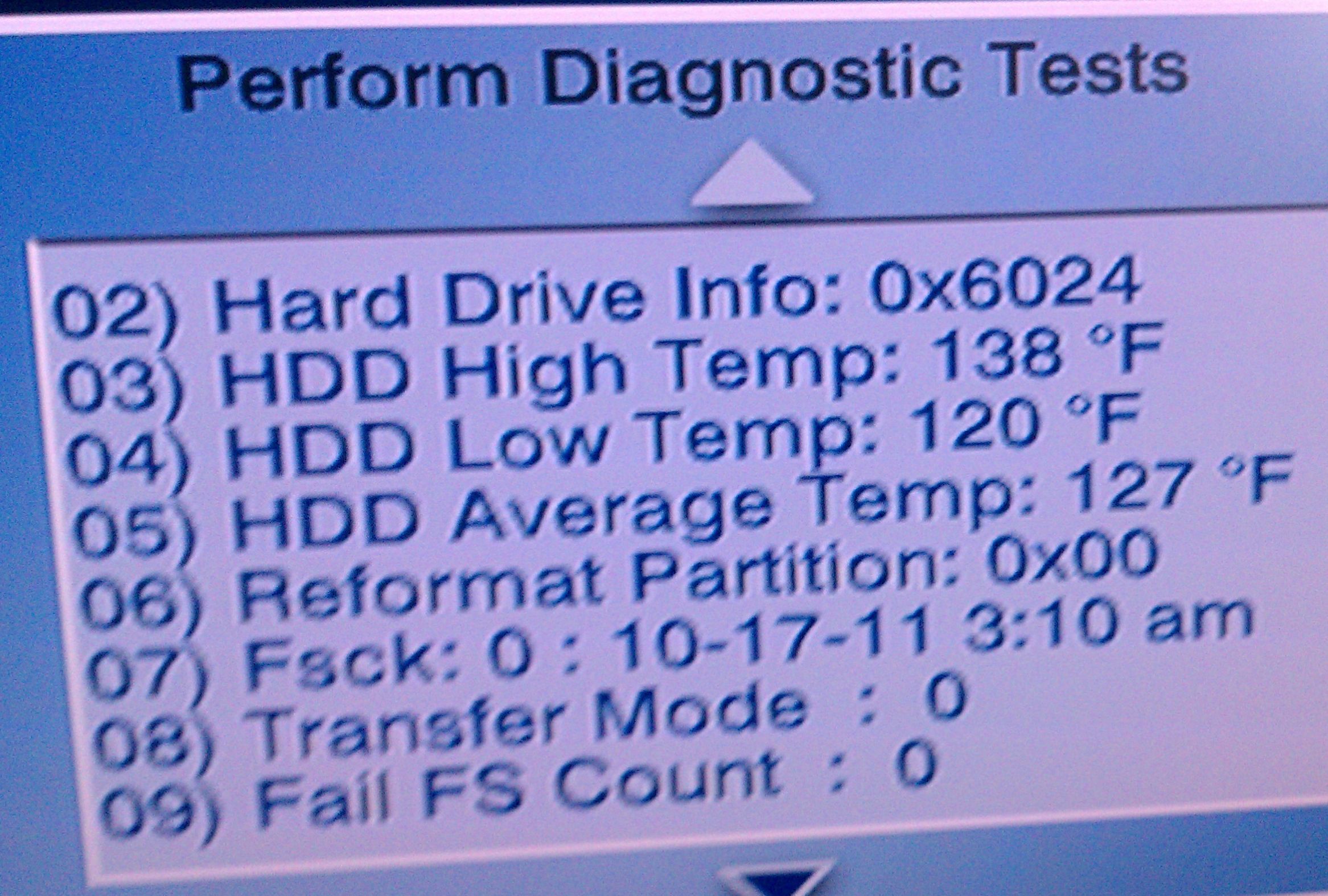

i'm a new customer (since sept 24) with a new 722k receiver and an external Western Digital 2tb hard drive & sling adapter. for the most part, everything is working great.
but, about once a week (random days or times as far as I can tell), the receiver appears to lockup - picture freezes, and then audio stops. no buttons on remote or the receiver function at this point. and about 1 minute later, the receiver will reboot itself - and then all is well again.
this has happened with watching live, prerecorded from internal drive, or prerecorded from external drive.
i don't believe the receiver is getting too hot - it is not inside a cabinet, does not feel hot on the exterior of receiver, and the status screens don't show any issues, warnings, errors.
I believe the software is L688 (last I checked).
should I be concerned ? is this an indication of a bad receiver ?
I'd still check the Hard Drive counters and report back the temperature numbers. Menu-6-3, Counters, scroll about 10 pages down. Any high temp of 140 or higher or an average over 120 is asking for trouble. The 722 and 722k are notorious for running hot.

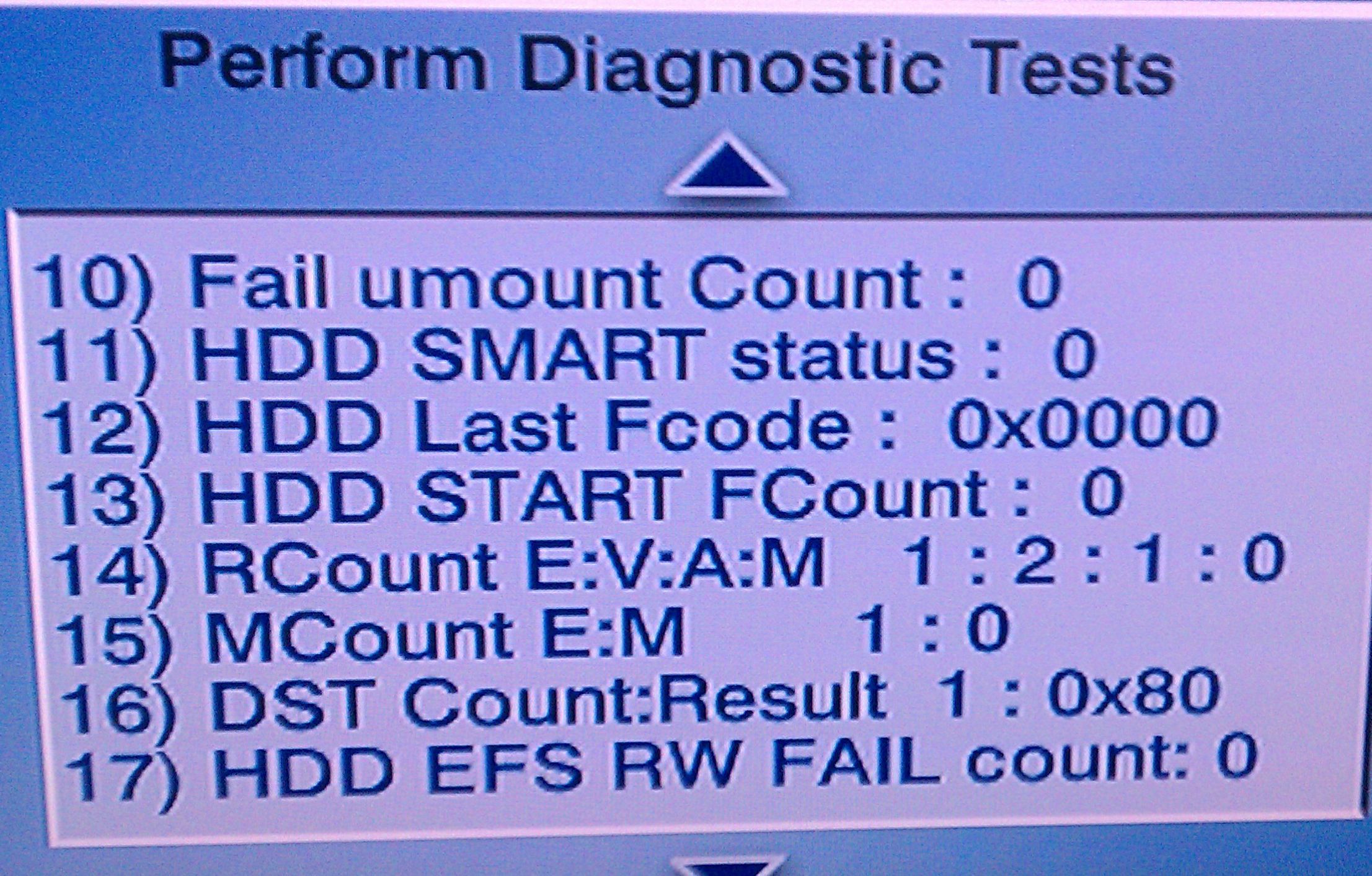

well maybe I was wrong about the receiver getting hot. I took pictures of the diag screens showing the drive info. dish_IMAG0414.jpgdish_IMAG0415.jpg

My high was 138 and avg 123 when I started experiencing spontaneous reboots. I plugged in an external USB Thermaltake II fan from Amazon and had it draw air out the back left corner of my 722, and I went down to 131 high, 118 avg and have been rock solid ever since. Others have reported even better numbers with this solution here:

I recently got the system linked above by dare2be. My avg had gone up to 120 and my low had gone up to 118 (I think). With that system at less than a week, my avg is 114 and my low is 91 (my high is still sitting at 140). I HAVE had one spontaneuos reboot since then at 3:19am when recording something off al Palladia. My download time is 3 am so maybe that had something to do with it. I hope to see no more reboots.

So do you guys think this is also an overheating problem? I have a temp of 140 high, 107 low, 123 average.
Or should I contract dish network and have them give me another 722K?
138-140 high and 123 avg is when I started having problems, and mine was when I would go to skip timers in succession. So yeah, I'd get those numbers down just to rule out temperature issues. Even if it isn't being caused by temp problems, you can still use the fan on your replacement unit as a preventative measure.
