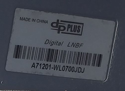

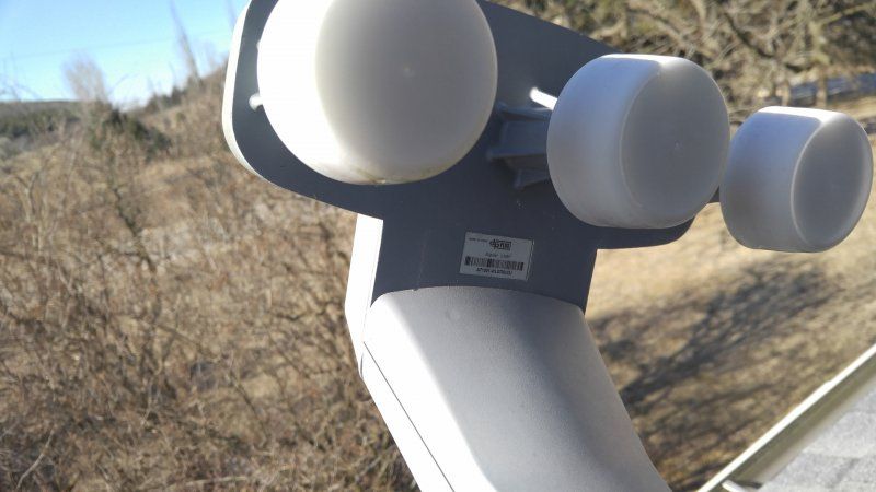

I just crawled out on the roof to look over the current LNB I have. It has 3 receptors/whatever on it.
If this is not compatible with the Hopper with Sling fine. I don't mind spending the money to get the correct one. I just don't want to order something I already "have", so to speak. In any event I will order the solo hub since Dish wants that in place for my Hopper.
So will my existing LNBF work? Or should I just order the Hybrid to be on the safe side?
Thanks again folks!
That is compatible, but you'll want a solo node, 2 lines into it from the LNB, Host line out to the Hopper, client out to any Joeys, using splitters if more than 1 Joey
