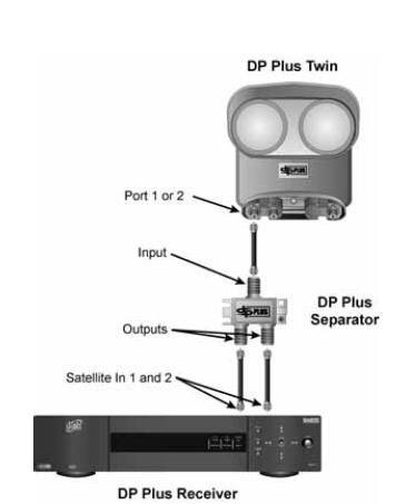

Look around and see if you can get a dpp twin. It will replace those LNBs (if your LNBs actually look exactly like that they are Legacy) and you will only have to run one line to the receiver. You may have to search a little because I don't know where to find one
Thanks - is this one
I presume it is one line for 110 and 119 and then if connect to a diplexor to go into the house and another to connect to the receiver to get the two inputs at the receiver
