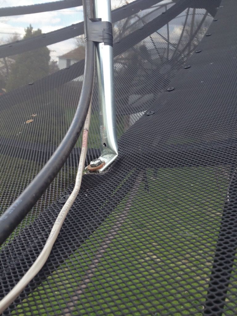

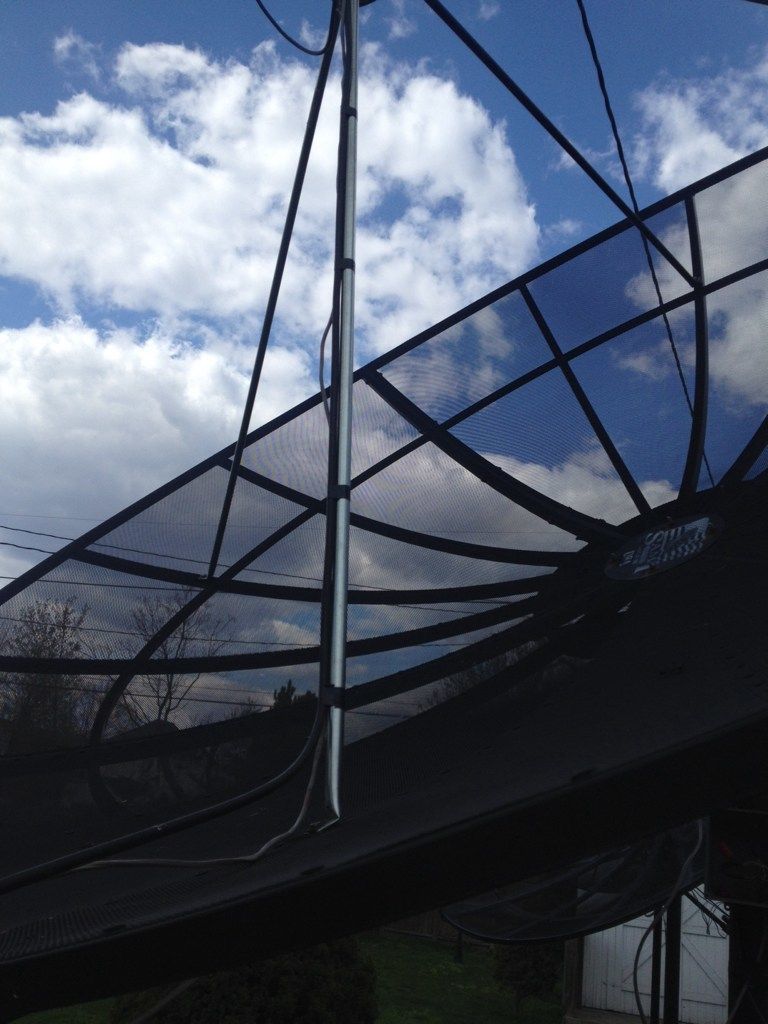

Figured out my problem. Feed arm was rusted and water froze splitting it open and distorting the centering of the feed. I made new arms out of 1/2" emt conduit. Flattened the ends Andrade them the same length.
Life is good and c and ku are in the same spot.
ImageUploadedBySatelliteGuys1397070801.676939.jpgnew arms I made from emt conduit
Drilled holes in bottoms to prevent rain buildup an freezing damage.
