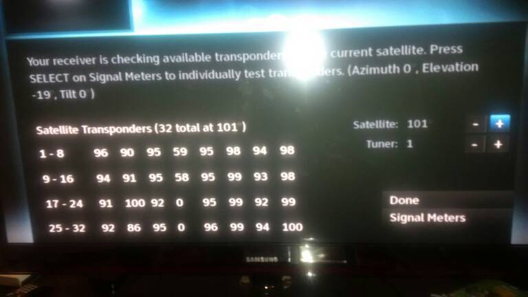

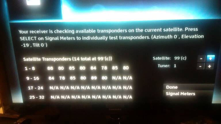

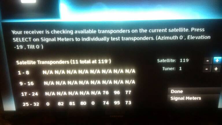

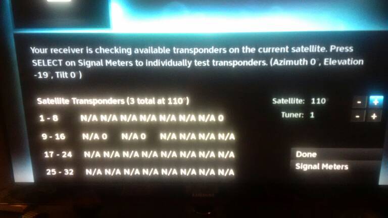

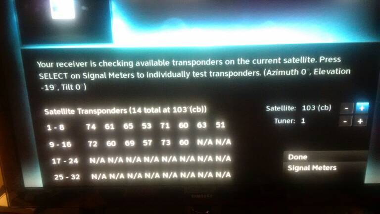

Post screen shots of the signal strength screens for 101, 110,119, 99c, 103ca and 103cb. Don't worry about 99s and 103s.

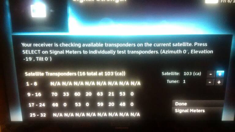

Thanks, here are the screen shots on current weather. Not raining but it did earlier and not crazy.
Very low, on several satellites. Looks like a straightforward dish alignment problem to me.
FYI the last set of 103ca readings you posted shows classic signs of dish misalignment - the odd transponders are just high enough to get reception, the evens are very low.
All your 99c/103ca/103cb signals should be high 80s at least, preferaly mid 90s.
Very low is an understatement! The first thing I would check is the dish to be sure all of the bolts are tight. That could be all that is wrong.

Apart from spotbeams, 101 should be in the high 90s or even 100. Same for 119. Ignore 110, those are only for Puerto Rico.
