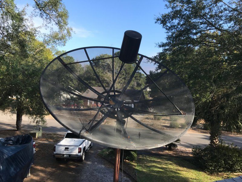

A guy that lives in the neighborhood has a BUD in his front yard I've been looking at it for a while and was driving by and he was getting out of his car, I introduced myself and asked him if I could have it and he said yes and he would help me take it down! So score, I finally have a BUD after wanting one for 25 years.

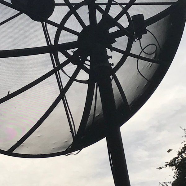

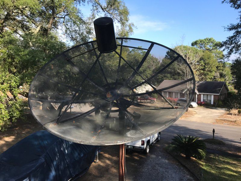

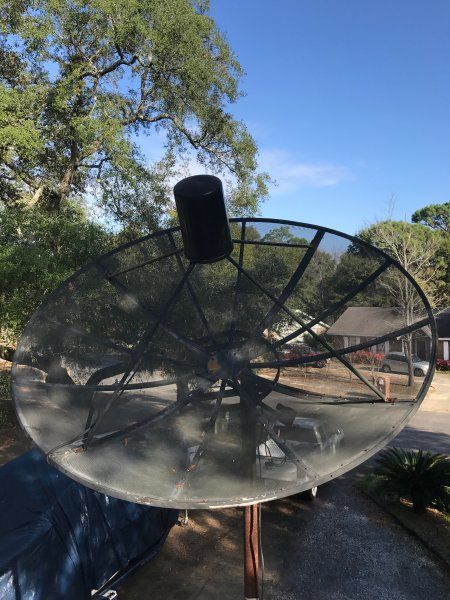

He said he hast used it since 2004 and it went through Hurricane Ivan ok but it did get dinged up in a big hail storm we had one year. Here are some pics... If I set it up as is, are these dings going to be a problem? If so can I get new panels? I been doing satellite stuff for many years but ku band, never c band. So I know what I'm doing and the language but was always a little fuzzy on c-band.
So my plan is to get an ASC1 and a HDVR3500. I used to have a microHD and liked it and I understand the HDVR3500 is better. Im thinking about a pc card too but I don't know yet, I think Id rather start with the STB.
I know if the positioner is bad I'll need a new one of those and the LNB I'm expecting to need to replace. Is there a PLL LNB for c band too? Im thinking the CK1S Combo C / KU-band LNBF. Im really just hoping those dings won't be a problem. Looking forward to it!

Nice find! I wouldn't worry too much about the dings.
Should be an easy set-up.
Yes there are PLL LNB's. If you decide to go to an LNBF, Titanium makes one of those also that is PLL. The C1-PLL, I have sold hundreds and many happy customers with that LNBF.

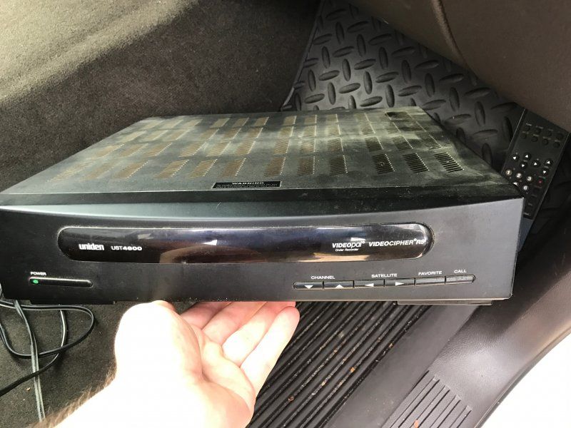

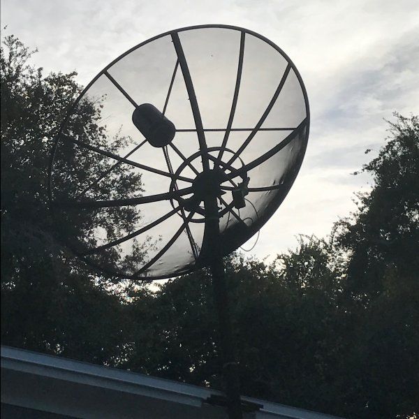

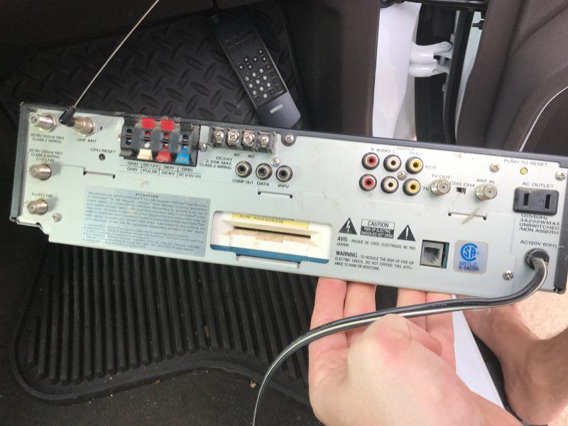

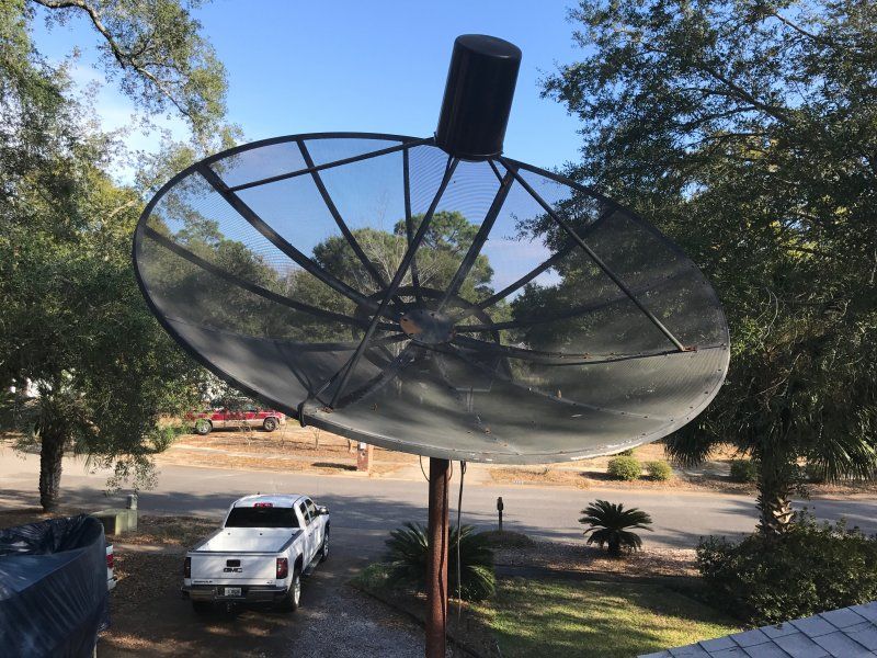

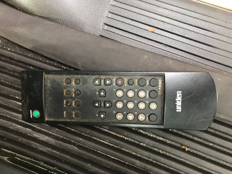

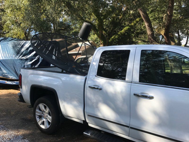

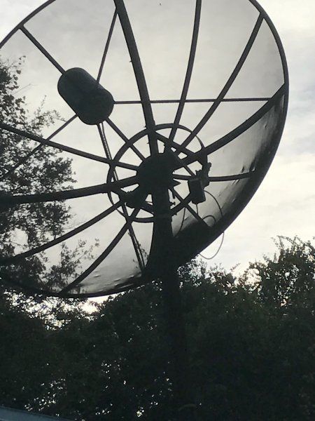

Ok so satellite weekend came and I finally got my first BUD! Turns out its a 7.5" Odom that was originally installed in 1996 said the owner. He even gave the receiver and remote, its a Uniden UST4600. Check it out.

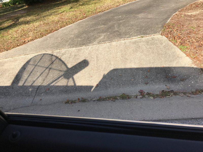

Really like the timelapse video! Sure was a close call on the way to it's new home.
No kidding right! I don't know what the hell happened there. I only had to drive within the neighborhood. I went slow but there is a big dip where our street meet the other, happened after they repaved it. I think that threw it up and the wind must have caught it but I wasn't hitting the gas hard at all. I saw it in the rear view and thought, "OH sh*t!" and hit the brake gently and was hoping it wouldn't come down and break the back window of the truck but luckily it didn't and went right back down. Jeez, close call on messing up the dish and the truck. Things were going too smoothly, had to be something! LOL
I have a question... Im tentatively going to set this thing up this weekend, so since I moved this dish from right down the street, would it be safe to say that if i mounted the pole level, put the dish on it and then spun it to point at the arc, i should be receiving signal. Now I know there are a lot of variables and that things could have moved in all these years but even if I put my birddog on it could the LNB be too old/analog?
