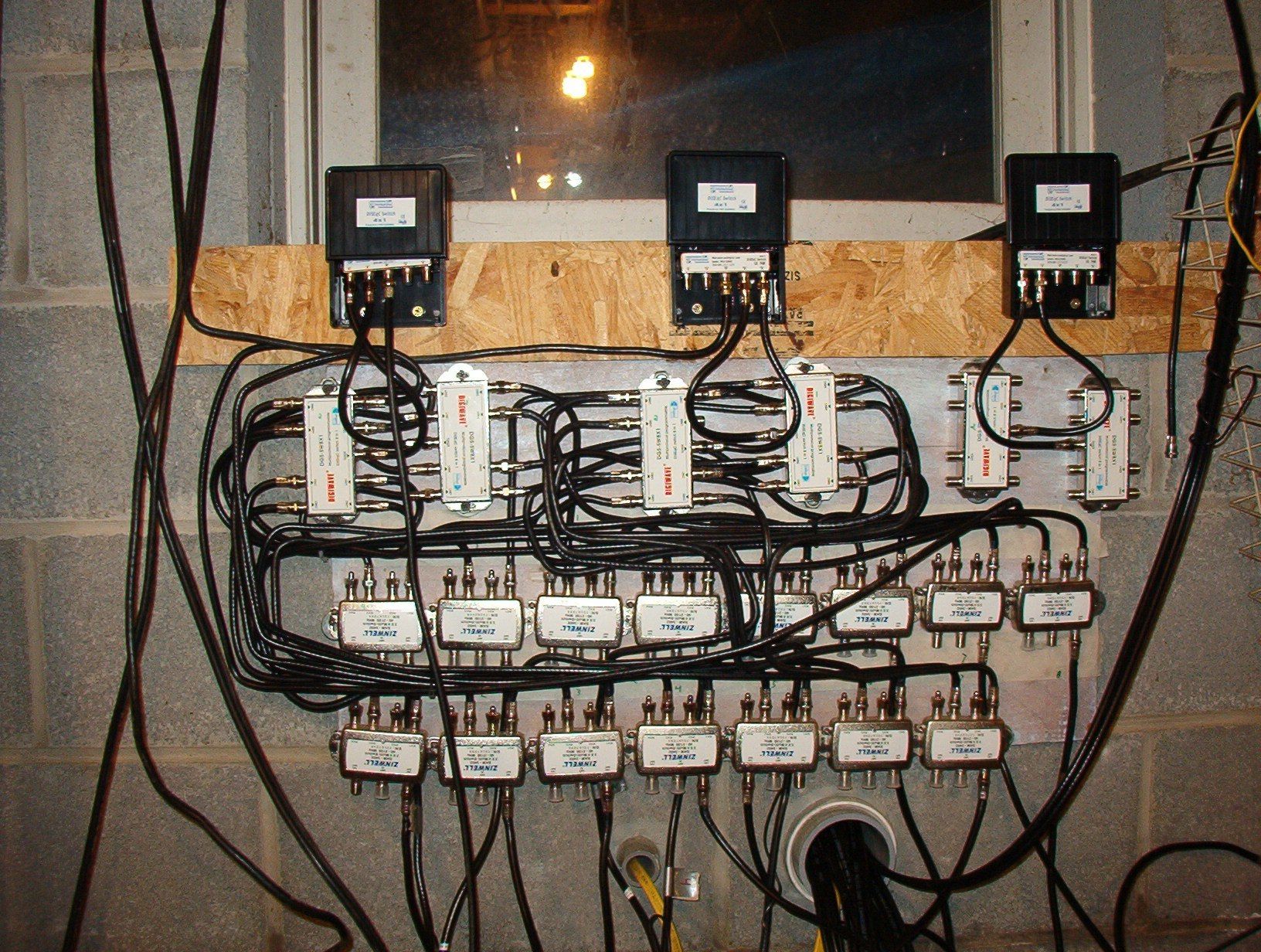

yep, they play well with others too.

Didn't realize they can be cascaded like that. Learn a now thing every day I guess. Might have to re-evaluate some of my installation(s) where I am running out of ports. Could go this route instead of using 22KHz switches.
yup so you could do 32 LNB"s if you wanted with 4x1 switches off each of the 8x1 ports
