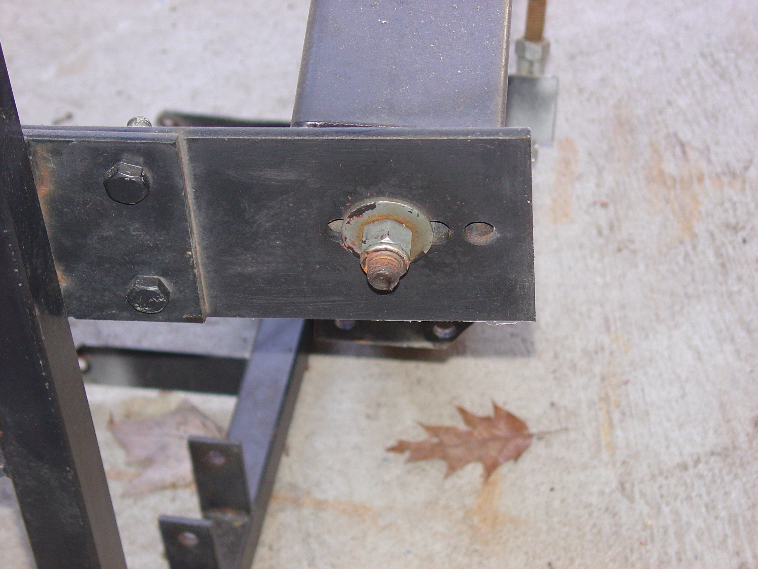

One question; from the picture of the polar mount, how is the declination adjusted?

I could, but I'll let Pixl give you the declination answer.
I haven't messed with the declination, I think it is elongated holes on the right side of the frame picture posted above. Since I didn't move the dish very far from it's last set up, I figure to just leave it at that adjustment.

Wilson Dish 009.jpgIn post #1, picture #2, on the left end of the large square tube is the nut with the elongated hole you mentioned. This picture may show it. I would agree, you did not move it far enough to worry. I'm at 43.99 and you are just South of the 45th. Micro movement at most?
