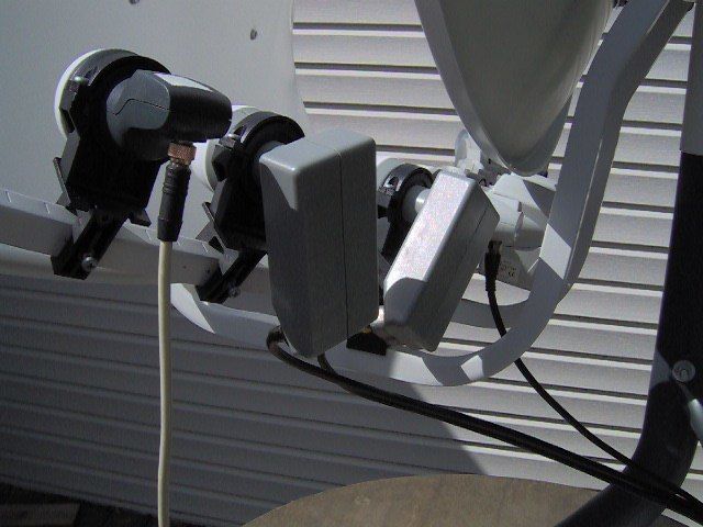

Yes, you will have to skew the LNB as well as it is really off from what it should be. I have 91, 97, and 103 on one dish (pictured below left to right, plus Echo8 at 110). The skew for my area is 10.5 (91) and 16.5 (97), and as you can see 103 is in the minus!
I succeeded in installing 91w and 97w yesterday, but for the life of me I could not get 103w. I got signal from 105w, 119, even 101w, but not 103w. I tried twisting and angling the LNB but nothing on 103w. Oh! BTW my 75e globecast dish measures 36"X27". My location is North Lat:42.12 and West Long:71.04. Based on my location what should be the skew on 103w? How do i know if the skew on the LNB is right without having the do trial and error?
AMC1 (103W) is an oddball skew on KU. You take what the skew normally is and to optimize signal, turn it 25 degrees OPPOSITE of that

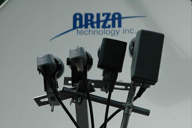

Here is a great picture of what I am talking about
The farthest left LNB is on ANikF1 for StarChoice and the skew is right...the LNB to the right of it is AMC1...look at the skew (technically on the T90 dish the LNB's should be on the 0 spot on the holder...the LNB for AnikF1 skew is probably off by 2 degrees of zero or so
