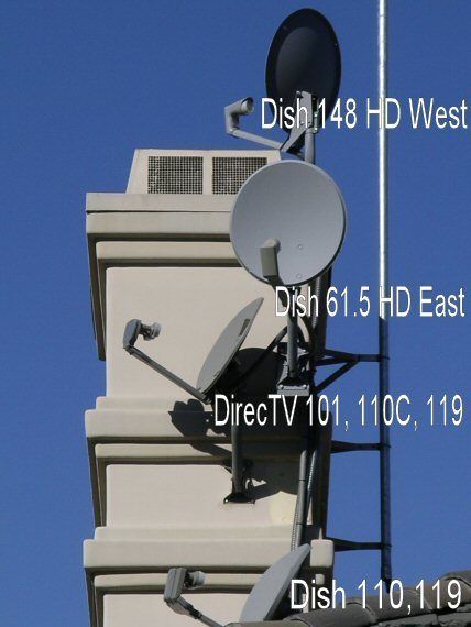

I have (1) 721; (3) 6000's; (1) 501; and would add a 921-for a total of (8) ports.
If I have (2) cascaded SW64's, Legacy Dual LNB's and a total of 8-ports, with my 501 and a 6000 as the "power" line to each SW64, can I add a 921 to any (2) other SW 64 ports?
Yes - use the same ports on the other SW64 that the 721 is using on the first one - just because I seem to remember some issues with splitting ports on the SW64.

It's been so long since I was up on the roof, I don't have a clue.
I have a four-dish E*/D* hybrid now, but, will need to reclaim the (2) D* cable drops to get 8 E* feeds lit up.
