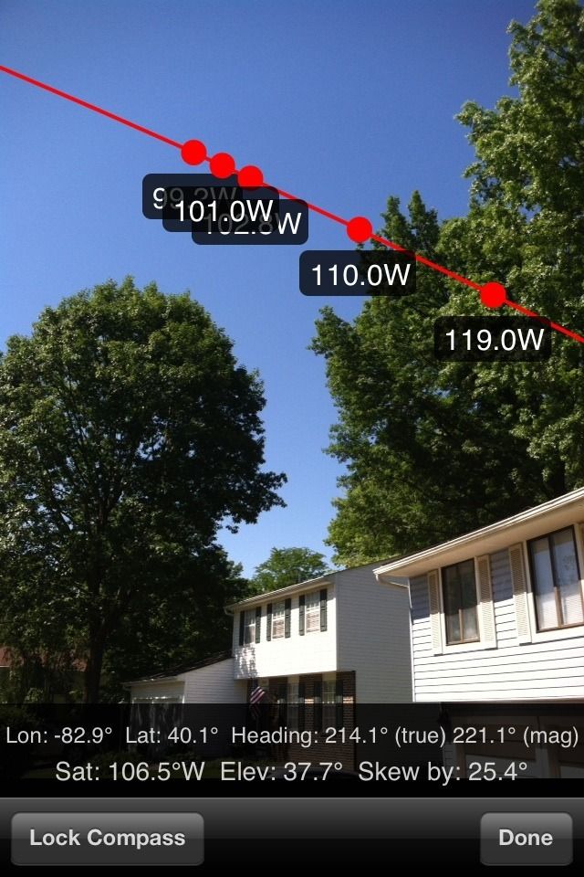

I wouldn't even have it installed unless a better clearing could be found. The 103 is boarder line working from that picture and I've seen that app be slightly off before so it could be completely covered. He'd miss half of his HD

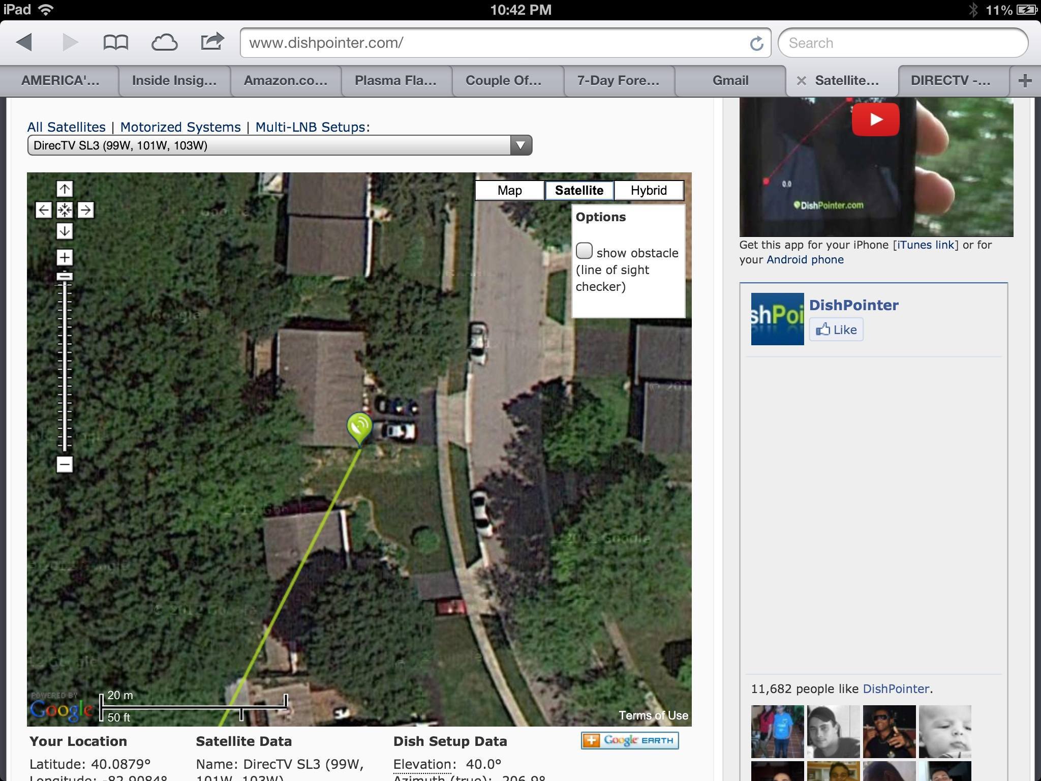

Here's a google earth dish pointer view so you can see what I'm dealing with on my property. Ignore the tree to the right of my driveway as it is no longer there.

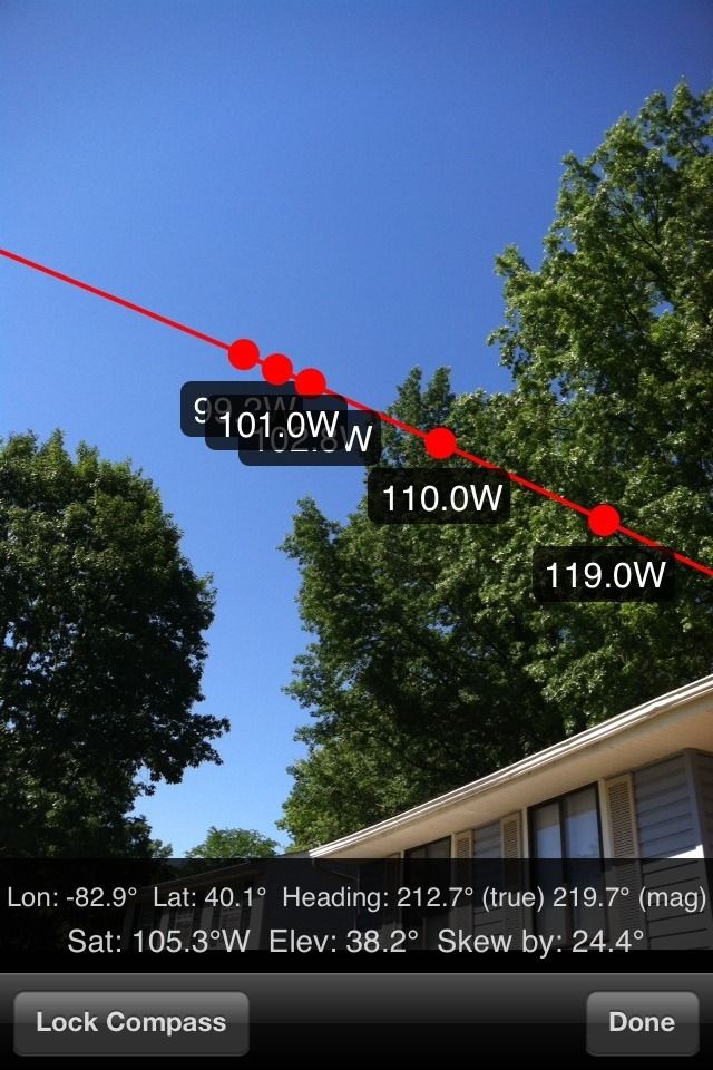

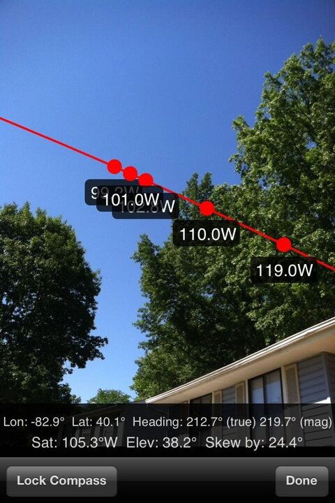

Quick update. After playing with the Dishpointer AR app a little I noticed that you really need to hold it steady in one spot for at least 15-30 seconds because it seems to recalibrate a touch. I was curious about that because there was a descrepency between the app and the google earth dish pointer. So I took some new shots. The first is from as far back as I can go while staying on my property and staying off the sidewalk. The second is on that same line but closer to the house near a ground up stump I have. I'm thinking I have line of sight!
That first pic doesn't have a 10 degree window but you would be able to more than likely get a vet tech to put it in. It's close but doable
