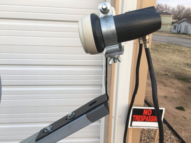

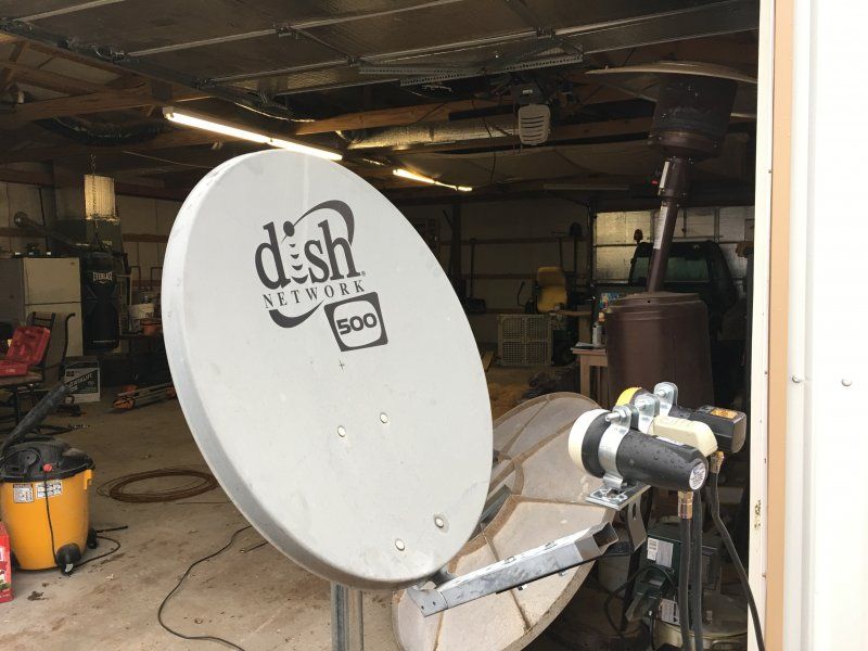

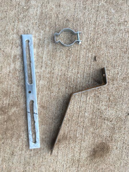

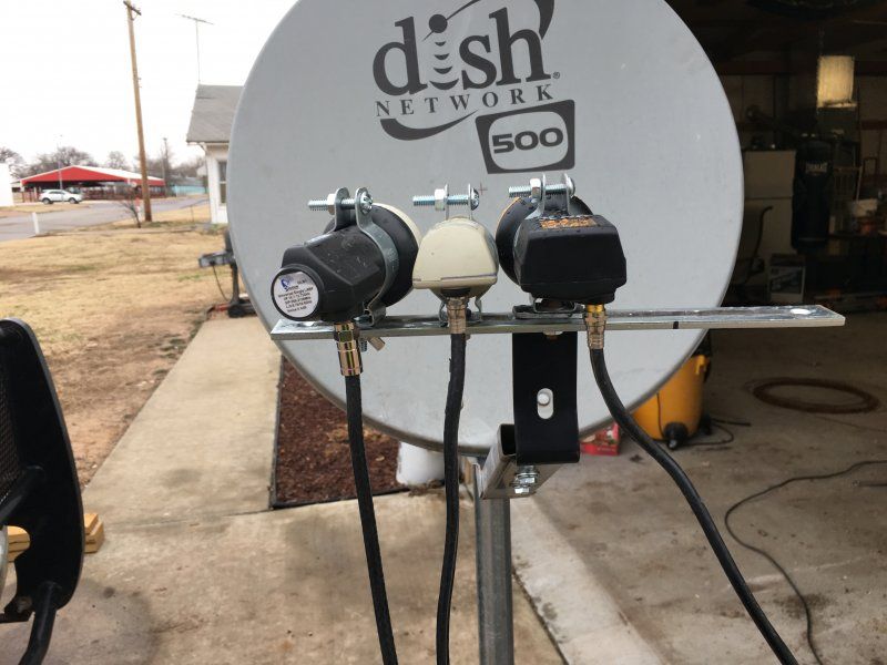

if i recall the avenger is a pretty good lnbf. you will have to build a bracket to position the lnbf in the proper place. Im attaching photos of my recent projects of converting different dishes but disregard the multiple lnbf part for now. What i did was measure the distance from the dish to the front of the factory dish network lnbf then measured the angles i needed to get to put the lnbf in the right spot and bent a bracket in my vise.

Dang shicks 3 lnbs on a dish 500! That thing is tinny.
Shicks is correct you will have to bend the bracket some to the the angle correct. With a slimline you have to drill a new hole (I think) 2 3/8 inches down from the top of the arm in the center. You can hit 97w with ease. You should be able to hit most other ku sats.

They all worked too, but i got little bit better signal with a oval turbohd dish so I stripped the lnbf's off the dish 500 and put em on the turbohd dish. interesting tidbit the same bracket worked for both dishes, just had to bolt it to the top of the turbohd dish instead of the bottom of the support arm. Neither dish will pick up the LPBS mux or the PBS mux. Beleive me I spent quite a bit of time trying. Its all a moot point for me really as i already have a motorized 90cm dish, im just playing around since its nice outside and work is slow. Better then sitting around eating chips and doing nothing all day.
