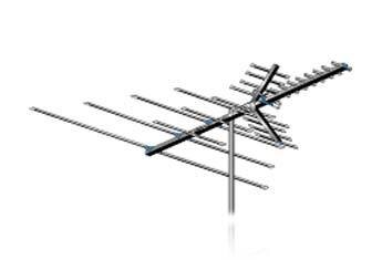

I have a Antennacraft C290 hooked to a VIP 622.
I would like to add a VIP722K in another room to my C290.
Signal strength is very good on 2 of the network stations and "just ok" on the other 2 we care about.
What do I need to:
1) split the C290 outside.
2) Amplify the signal (don't know if possible without overpowering the 2 "good" channels.
3) feed the 622 and 722K properly
Thanks in advance for any help!

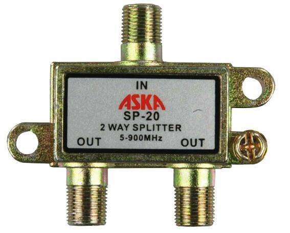

So DON'T worry about splitting the cable outside?
Just split prior to the 622 and fresh run to 722K.
Now the 722K will have 2 OTA inputs.
Use a splitter again there?
Is there a difference in splitters?
Nope – just put one splitter behind the 622. Both distribution amps mentioned above have one input and two outputs. That'll make swapping out the splitter a breeze in case the boost is needed. Besides, the amp needs to be indoors, and needs a power outlet close by. The end of the current downlead, behind the TV, seemed like the best place...
Now the 722K will have 2 OTA inputs. Use a splitter again there?
Honestly, I don't know. You'll have to consult the user manual to find out why it has 2 OTA connectors. My hunch is that a second splitter shouldn't be needed, though.
That Aska splitter is fine for use between the antenna and the OTA cabling. Its frequency range isn't wide enough for use in satellite-dish wiring, though.
