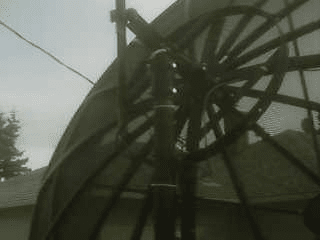

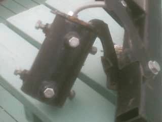

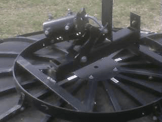

Walked by my BUD a couple of times this morning before I noticed the damage. The polar mount broke and the dish was just hanging on by the elevation bolt, actuator and a small peice of metal. Got it all down and apart today and will be pulling the pole tomorrow and re tapping some anti-twist bolts. Will have to get some more quickcrete, a new elevation bolt and some straightening and welding done. Here are some pics of the damage:

Was wanting to redo the pole since the anti-twist pin broke last year and wasn't getting around to it any time soon until now! Hopefully I can get the polar mount straightened and welded good enough in town. After I put in the new pole it won't take too long to put the dish back up and tune it in. Will have to get on putting the pole up first as once the pole is in I can take my time with the dish.
