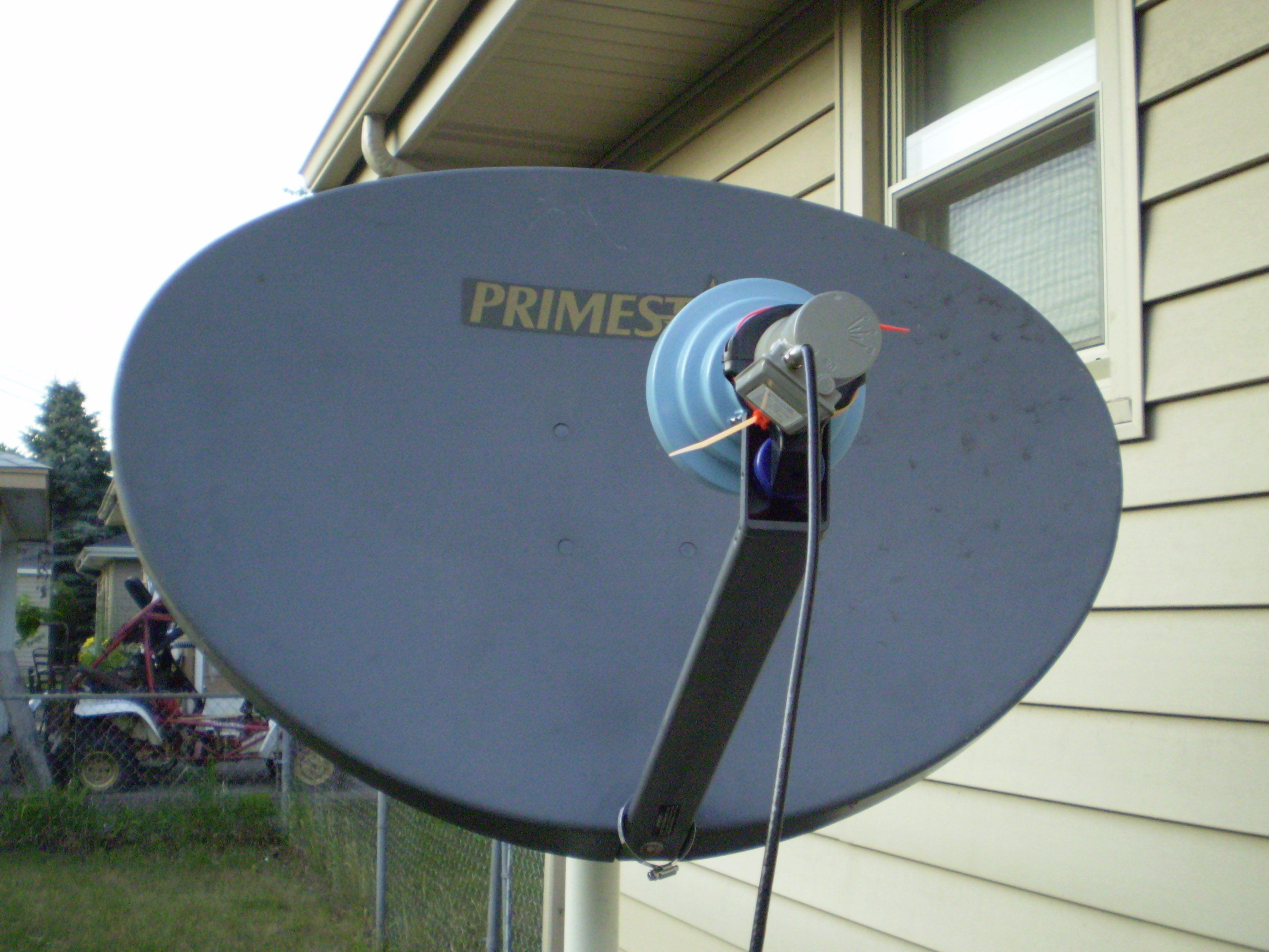

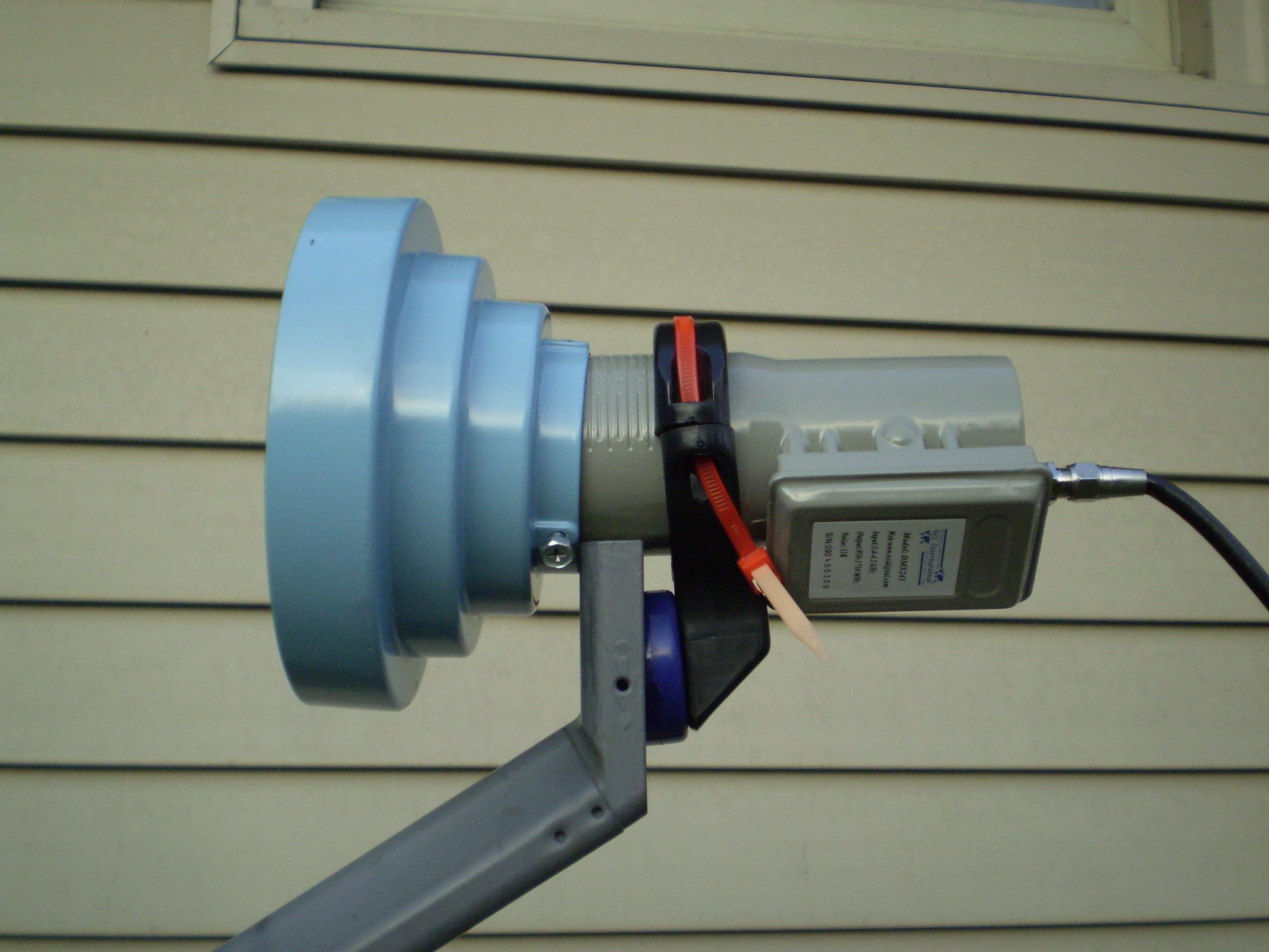

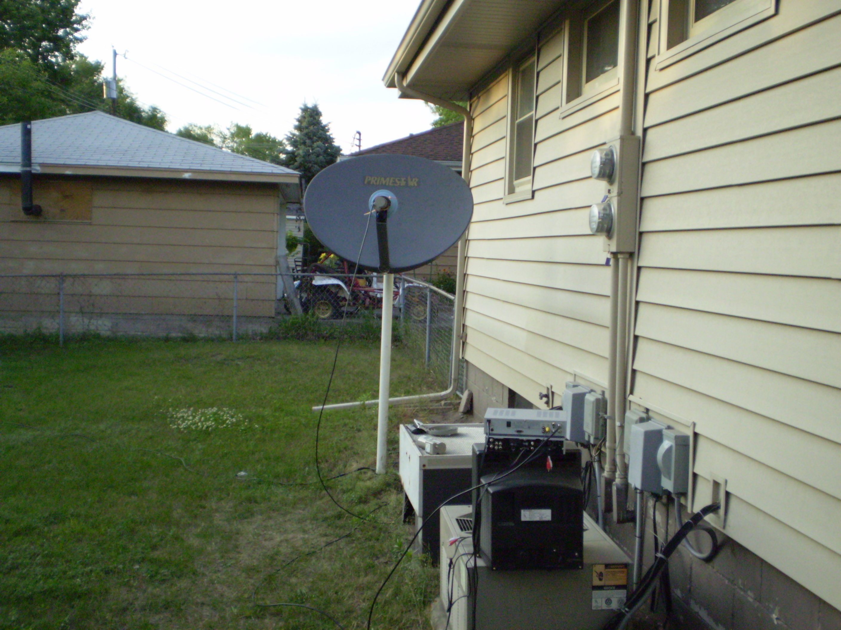

Here are three pictures, one as a general view of my outdoor setup at the moment, a closer shot of the dish, and the closeup of the LNB sans hose clamp. It's pointed at 99 in the pic.

The conical scalar is really designed to match a round, not elliptical dish.
However, it may well be a better choice than the flat scalar... your results should be interesting.

Anole, thanks for the links and info. As much as I'd like that conical ring to work, I think I may throw on a scalar ring later on just to see if I get better quality. At best I got the MyNets at 60%, WAPA at 49% and WHT around 46%. Not bad, all in all. I'd love to get the nets, but no luck yet. Golden Eagle bled over as well, but even tweaking couldn't get it over 39%
