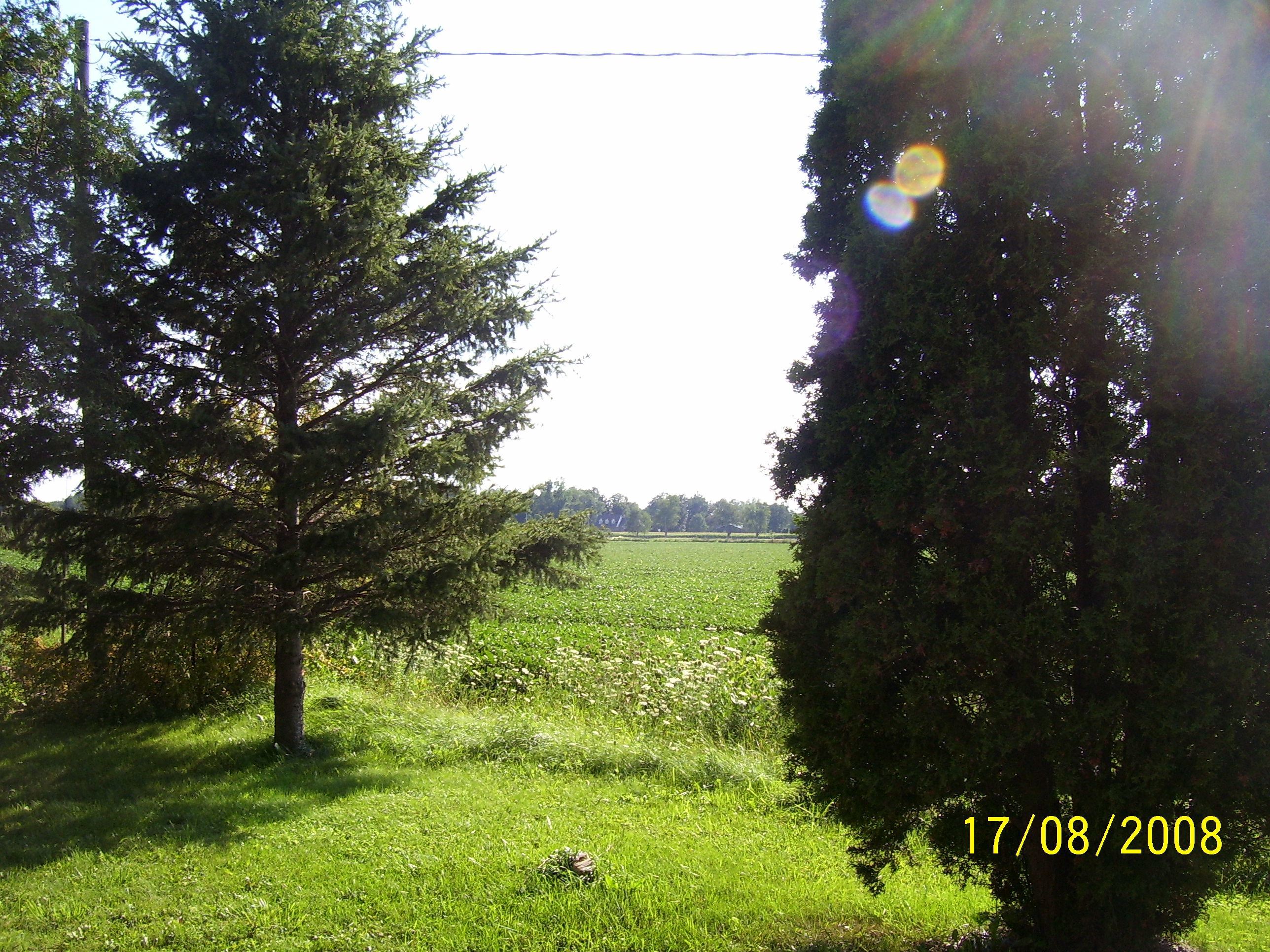

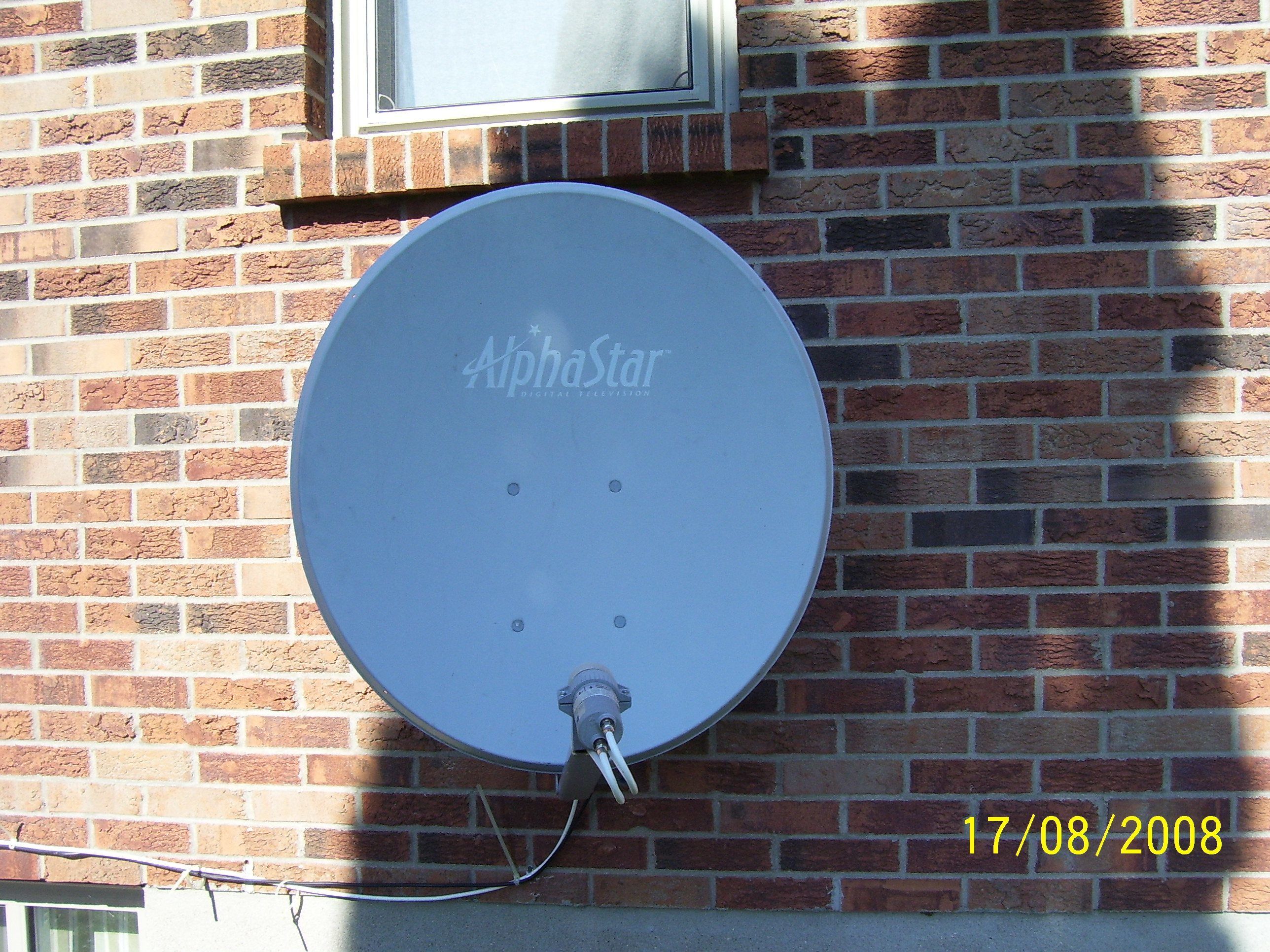

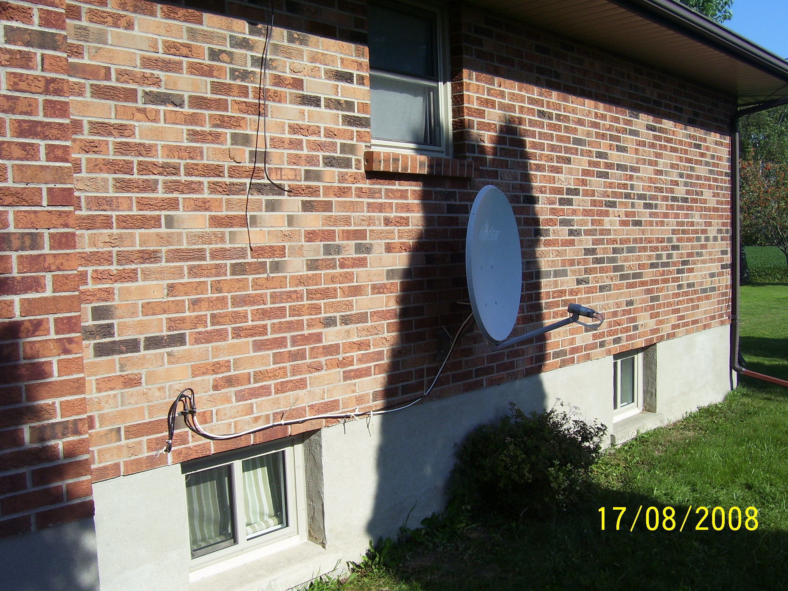

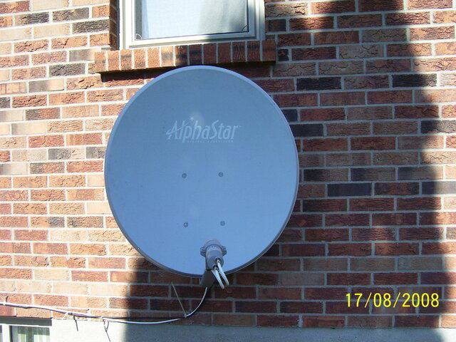

The install went well today! The family years ago had Bell ExpressVu, but had to cancel service when money got tight. My plan was to simply replace the ExpressVu dish with the 31" Alphastar dish, but I ran into a snag.. The snag being an evergreen tree that was completely blocking 123 West. I fired up the Fortec receiver and with the dish on the ground I moved from location to location until I figured out a spot where we could get signal and then moved the mount to that new location. In the attached pictures you can see the tight squeeze that we're pulling signal through.

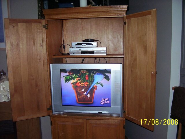

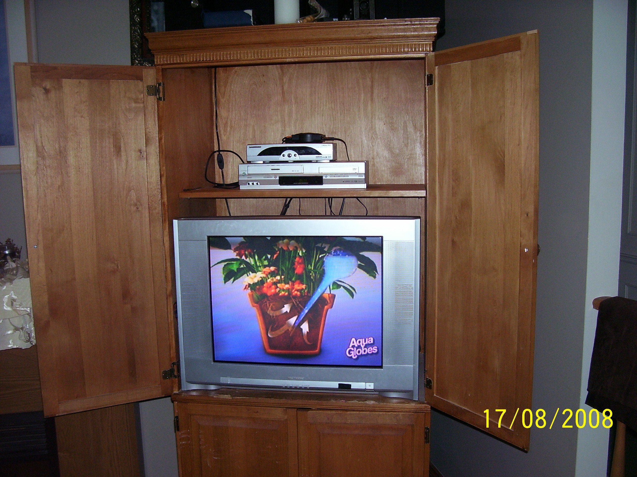

Iceberg, in the one picture you will see the new home for your old Fortec receiver. Platwound, on top of that receiver is the Sonic Voom AC3 decoder that they are using to get some of the AC3 channels on Galaxy 18, and in 6 to 8 weeks from now they'll be using that same decoder to get the PBS channels after PBS migrates to AMC21.
