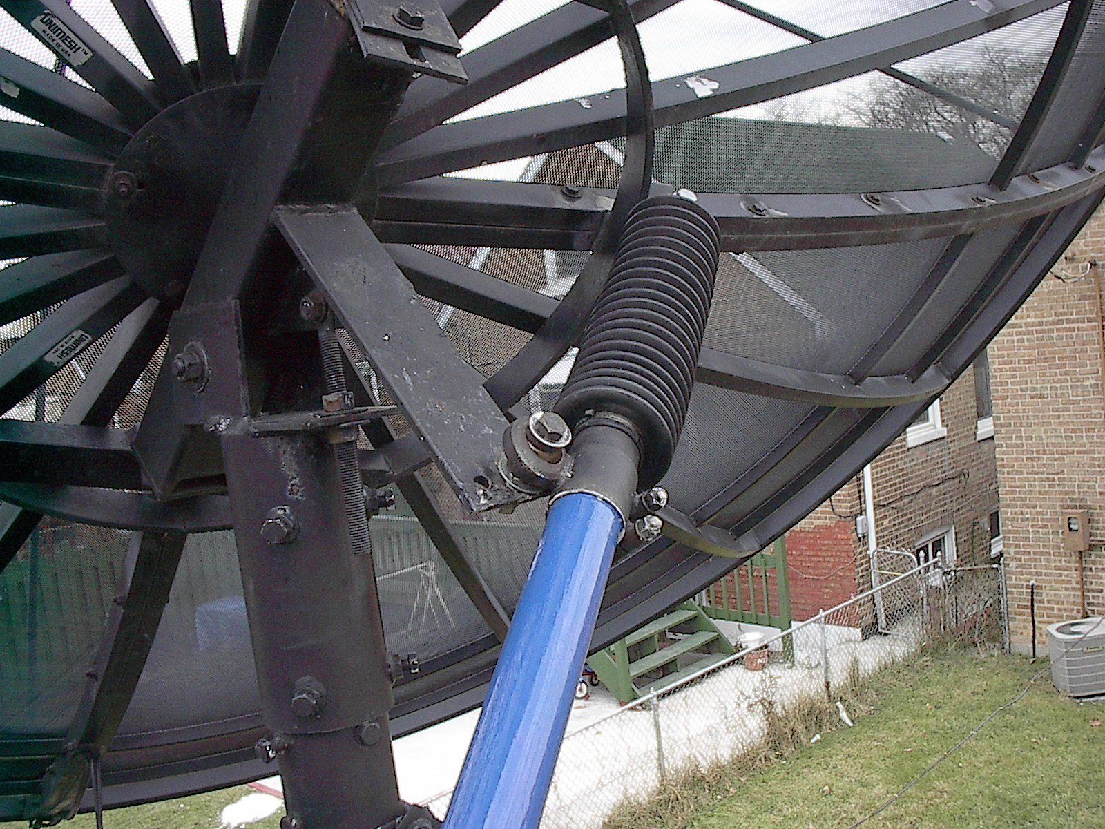

Skyvision sells a boot. My 21 year old Saginaw still has the factory boot in good condition. Once or twice a year I spray some WD40 on it and rub it into the rubber, works wonders :) If you go with a new unit stay away from the 150 dollar specials they won't hold up.
