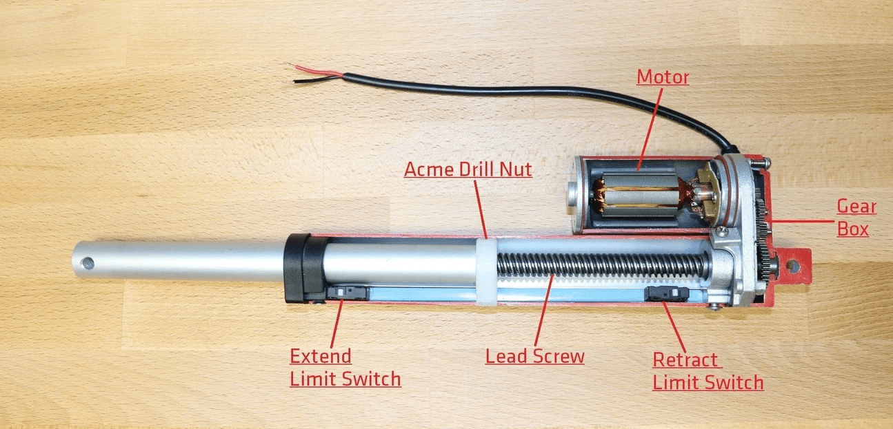

I did 6 pumps and cycled the actuator but I don't see any grease on the shaft. So, I emptied a 3 oz tube of grease into both actuators and still no evidence of grease on the shaft. The grease tubes were empty when done so the grease must have gone into the actuator tube.
I'd grab a junker and tear one down if I were you. You can certainly wipe a layer on the outer tube but the whole idea is to lube the ball screw assy. inside. Once you rip one apart and look at the guts you'll get it.

Yeah I got a mini lube gun that takes 3 oz tubes of lube. I figured that's all I really need. But I did notice that there's a better variety of lubes for the "real" lube guns. By the way, mine is an acme screw, not a ball screw. And I don't have a junker to tear apart.
Well you're on the right track. The idea will come clear once you peek at the photo. We want to extend the tube so that when you pump the sauce in and run it in and out a few times the screw assy. and hopefully the thrust bearing/washer will get what it needs.
