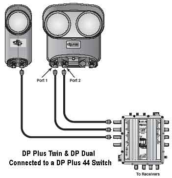

a) Two DP34 switches ($65 each at Dishstore.net)
or
b) One DPP44 switch ($180 each) and two separators ($10 each)
Actually, the OP only needs (1) DP34 switch. Regardless if he has a DP Quad or DP34. Granted it would be cleaner and easier if he DID have a DP Twin/DP34 combo already existing.
All that is needed is to hook up ports 1 and 4, or 2 and 3 on the DP Quad, to a DP34 switch, and from said switch, you can have four tuners. The remaining ports on the Quad can run 2 more tuners.
