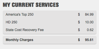

That's excellent ! But, wait, what about the monthly HD fee I pay? Will that increase as well or stay the same? Is the $10 HD 250 fee a flat fee that covers both or is it PER receiver?

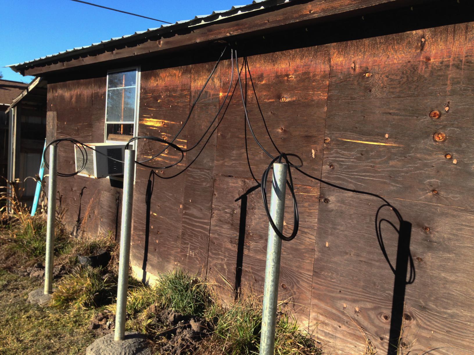

I have 3 new sch40 3" poles, 3 foot in the ground with 240lbs of cement on each one and anti-spin rods inserted through them and RG-11 run end to end. I've learned from my previous FTA grief and these poles/dishes are ready to take on a category 9 hurricane ! :D Oh, and when I set the poles, I clamped two digital inclinometers to them and set them to absolute perfect, dead on 90 degrees. They could not possibly be any more plumb than this. (ignore the ugly garage, it's getting new siding soon... )
Tuesday is the big moving day. I'm encouraged now to seek out another 211k and some more LNBFS..
Per account, i.e. it covers both.
YES! This is also very good! I hope some day they will run another special that I can jump on where I can get the HD for lifetime deal. I missed the bus the first time around. I snoozed, I loozed.

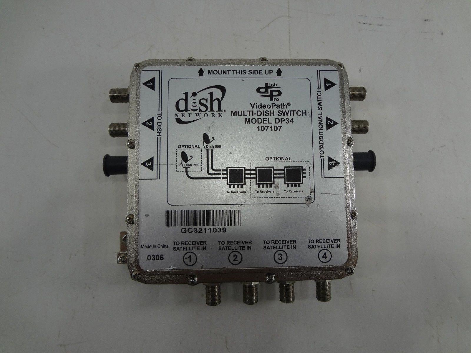

I bought this switch today.

That is a DishPro switch hence the DP34 model number, you need Dish Pro lnbs and not Legacy lnbs to use it
Oh cr*p...... Here we go again..

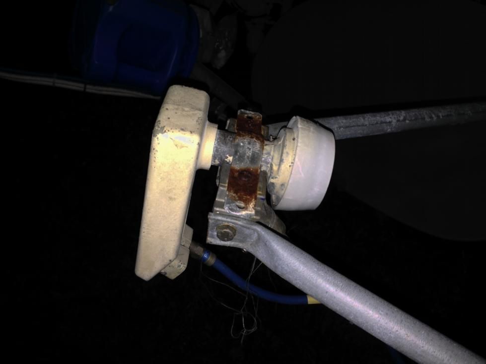

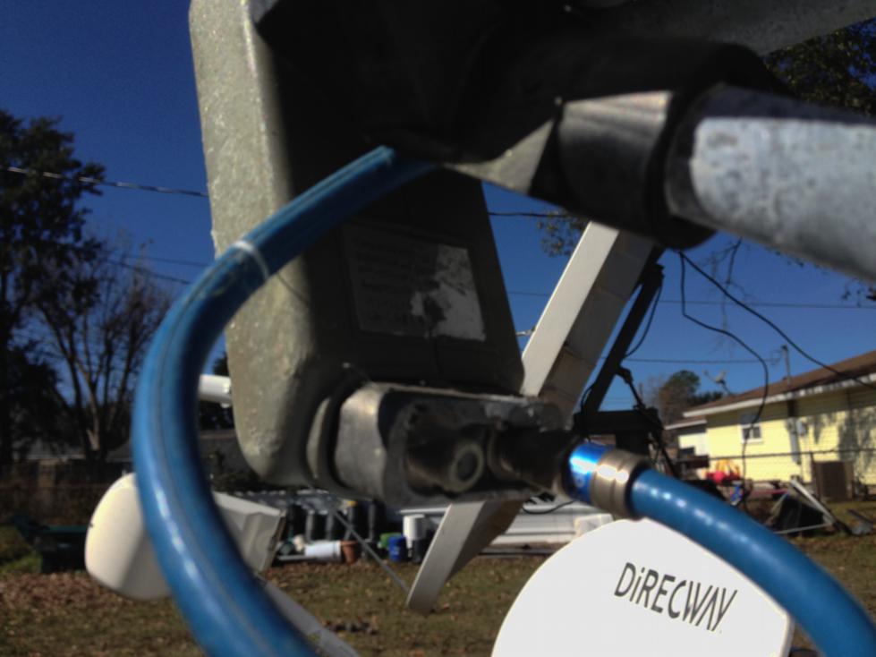

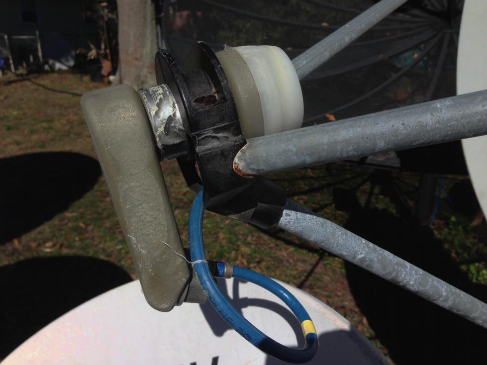

I think that every one of them is an old Directtv brand. I used them because I find them on the side of the road sometimes and they fit my dishes. I popped the plastic covers off of them and they fit right into the 20mm clamps on the Prodelin / Primestar dishes I use. My largest 1.2m dish needs a 40mm neck and there is a third party Direttv one that fits into it, it just say on the sticker "Compatible with Directtv"..
So my problem would be finding LNBF's to fit the dishes. I'm not changing or replacing them, as they are now they work exceptionally well and I never, ever experience rain fade. I guess what I should do is sell the DP34 I just bought and find new LNBF's that fit but have dual outputs and use another SW21-3 like I am using now. I doubt I would find Dish Pro LNBFs that would fit the dishes. It's all very non-standard. I know, I know... It's not the right way to do things but it's worked so very well for me that I've never had an issue in more than two year, it just works.
So, I would need three of these, yes?
