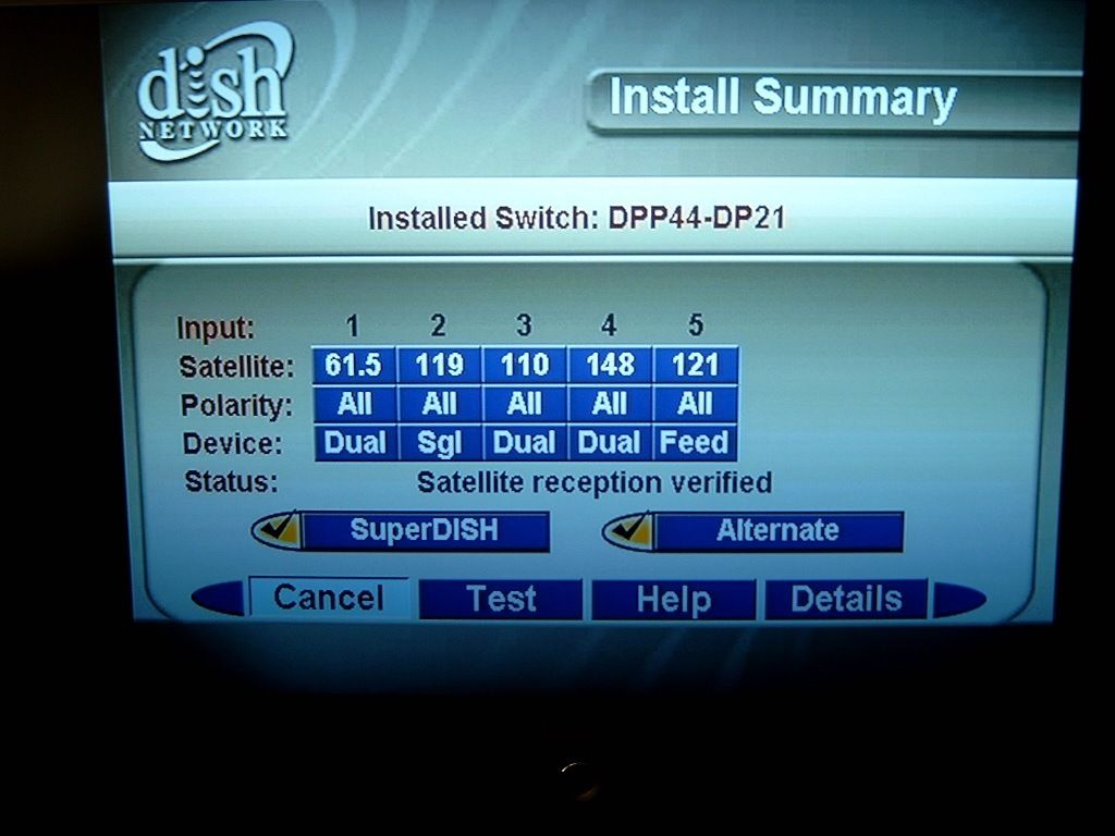

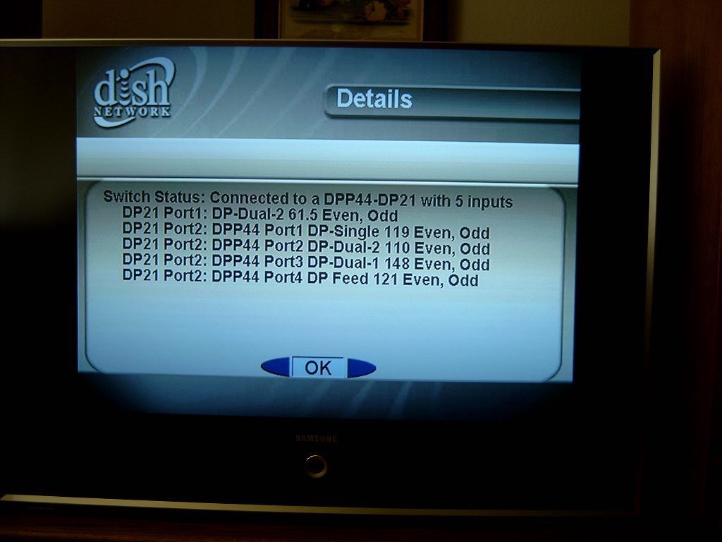

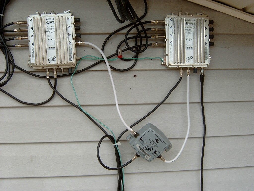

DPP44 + DP 21 between two DPP44 works
OK, the "DISH 1" side of a DPP21 DOES work with the PORT side of a DPP44 combining the DP21 with two DPP44's for 5 satellites.

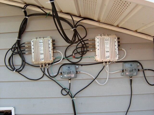

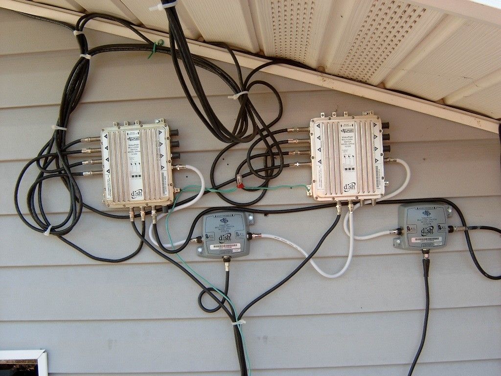

Example: First DPP44 OUT PORTS
1 = 119
2 = 110
3 = 148
4 = 61.5 to "DISH 1" of DP21
Second DPP44 LNB PORTS IN
1 = 119
2 = 110
3 = 148
4 = 121
Second DPP44 TO RECEIVER
1 = Model 921 w/ power inserter between
2 = "DISH 2" of DP21
3 = unused
4 = Model 6000
Testing with Model 311 the above configuration works.
See the photos that are attached.

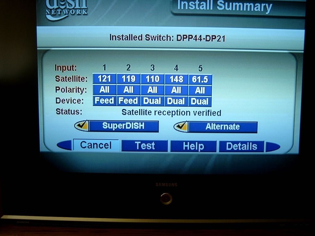

I tried this with my Model 6000 but had to use the power inserter to the DP21. It would only show 119, 110 & 121.
I have not tried using two DP21 with opposite configurations to my 921 as there is no possible way to get the exact switch configuation. Using the two DP21 switches showed the first DPP44 with 61.5 at the top ad the second DPP44 with 121 at the bottom. Oh, well. I'll have to think about trying some other ideas in the future.
View the attachments for better details.
I would have expected that to work since the port side of the DPP is just a pass through of the LNB signal. (i think) What I find cool is that your DP21 Port 2 detected the DPP44 - so Port 2 is not single LNB only. But can DP21 be connected to only one switch (either on port 1 or 2) and the other port must be single LNB - or is it that there is DPP44 on port 2 that makes a difference. Rats, just when I thought I had run out of things to test.
Yes, it will read 5 satellites being hooked to one DPP44 switch.
I didn't experiment in great depth having read through the Mad Scientists data. It satisfied me that only the dish 2 side of DP21 works with the switch. You are correct in that the DPP44 port is,"pass through." Having read the treads I was beginning to believe that the DPP44 switch out ports were too switch dependant and wouldn't work with the DP21 dish 1 side. Nice surprise! I have tried putting the DP21 between the LNB's and the first DPP44 switch, only one side of the DP21 switch will work. I will have to take the DP21 dish 1 side from the output port of the first DPP44 and put it on one of its receiver ports just to see what happens.
In considering the two DP21's for hook-up to a 921, I may reverse the second DPP44 LNB ports in hopes that they will read the same as the First DPP44 LNB ports.
BTW, the Model 311 check switch screen shows a sixth spot for a satellite assignment. Any idea on how to configure the switchs for the sixth?
Thanks for the test, but that configuration is NOT really using two DPP44s.
The cascade outputs of DP switches are effectively identical to the corresponding input LNBFs.
If anything, it's probably comparable to using a DP Splitter.
P.S. AFAIK, NO ONE has been able to get 6-birds running.
Your are correct SimpleSimon. I did some more testing today. the DP21 dish 1 side only sees LNB's the dish 2 side sees the switch. Maybe E* will produce a switch that will see more than five satellites or better than that, program the switches so they will work in cascade.
Thanks,
John
Any time you connect another switch to a DP or DPP switch it will only take one satellite signal per input. Normally, one line from a DP or DPP LNB contains both satellite feeds because there's a built in switch. A 21 switch into a 44 switch would show up as whatever went into SAT input 1 on the 21.
I could be wrong, but I think I've seen DPP 64 switches. That would solve all our problems.
