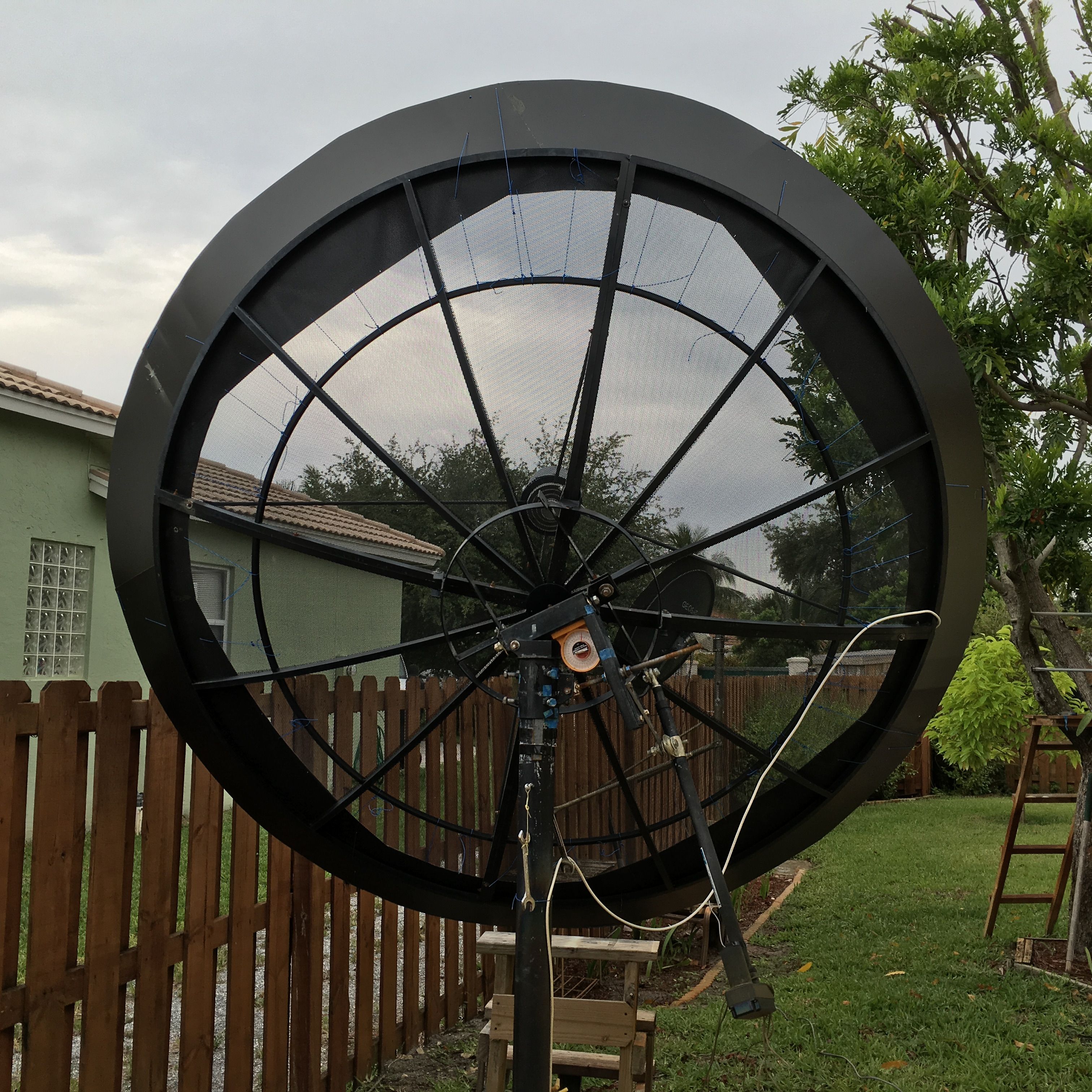

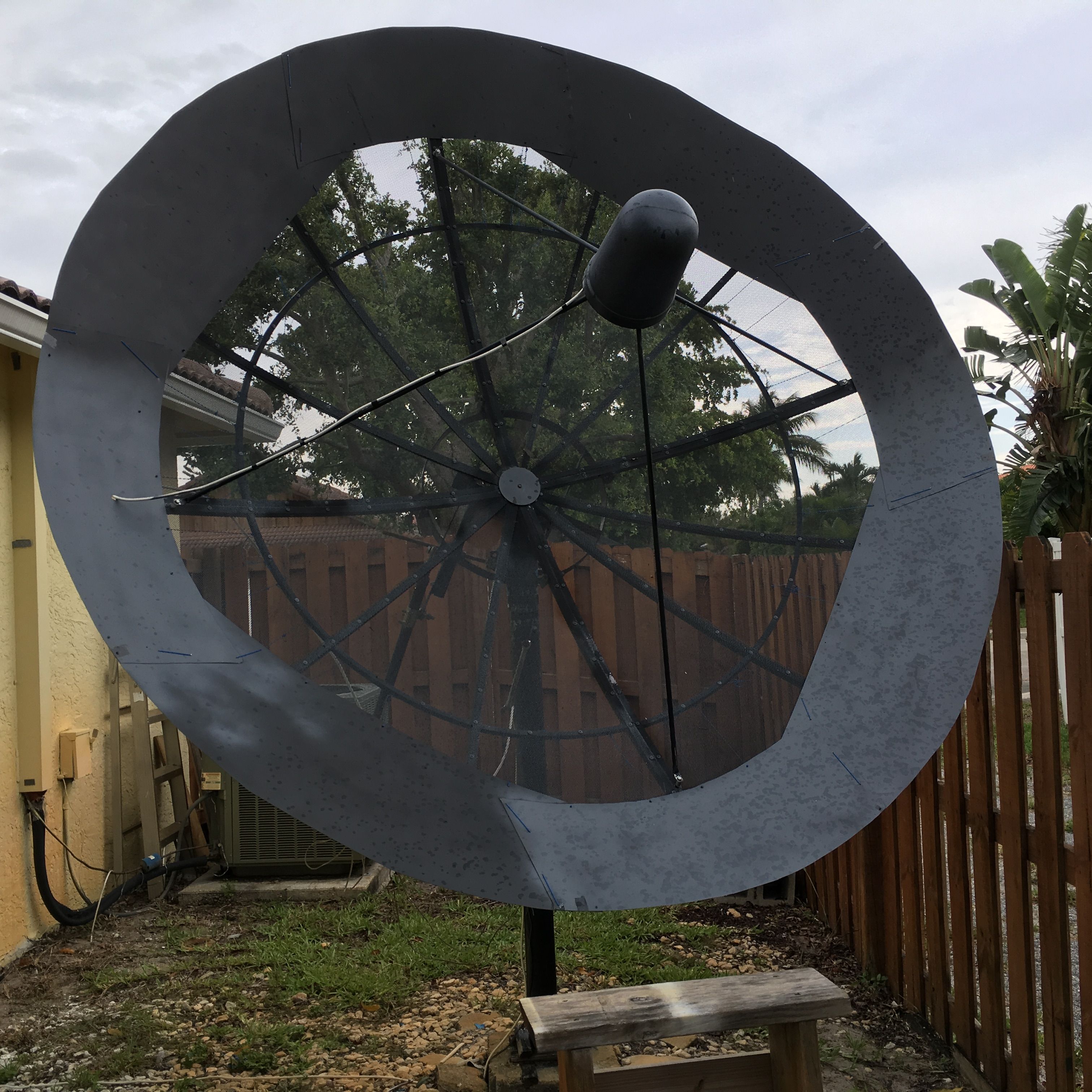

077.JPG074.JPG075.JPGI started this project about year ago. I have gone through a lot of metal plates, glue and duct tapes. I finally, I hope anyways, reached the end of the road. On this particular setup I used metal plates, power drill, round trimmer line, pair of scissors and spray glue. It took me a couple of days to put it all together but at the end it was worth it. Reception is much better. My only issues right now is 137W and 105W. 137 I don't eve get a bit. Last year was able to get 3760 and 4080 but not now. I may have some tree issues. 105 however, I get NASA with not problems. NBC/Telemundo comes in but it has a low signal strength.

jibaro29, how did you figure out the amount of curve to put in the metal panels you added?
thanks
Cnut
thanks
I used screen door kick plate. It has a natural curve if you lay dawn the right way. You can get this at Lowes or Home Depot. I no longer have the 6 footer. I got me an 8 footer that has the same extension panels on it. I will post a picture on my next post.
