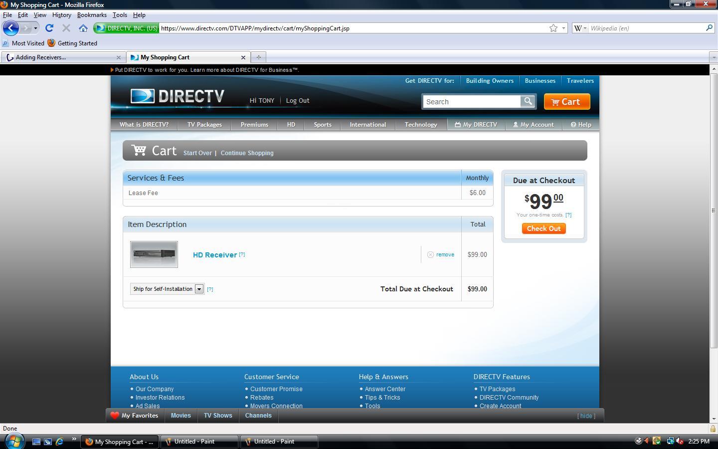

I recently got a new HD receiver and one of the options says "self install" which it allowed me to do. :) I didnt pay anything extra for it. It was $99 + sales tax

The reason I asked you if you were a sub was because if you were, you can see on your account that if you add a receiver the option for self install is there

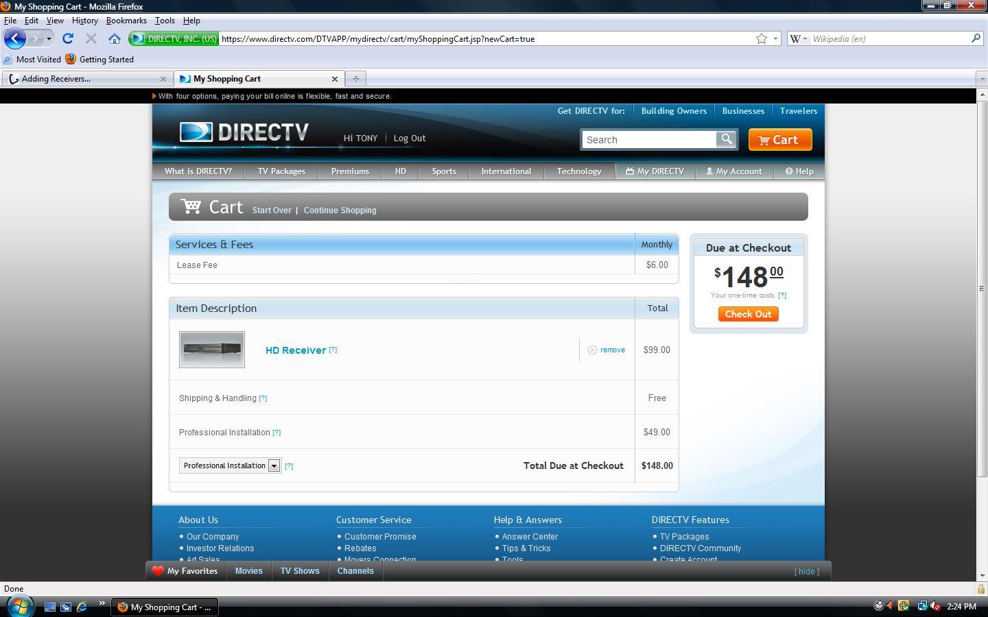

I guess for me its the $49 install charge for them to come out and do it. When you select the self install option it does give you the pros of self install and of "pro" install.

Also for the price for labor in my case if I would have waited for the tech to run a new cable it would have taken probably 2 to 2 1/2 hours for the tech to run a new cable through my house...into the drop ceiling in the basement...through the basement into the garage...staple it to the ceiling of the garage and up into the room (which sits on top of the garage). Since I was redoing all my cabling anyways (had some old RG59) I had rerun 2 lines of RG6 into each room. So the cable was already there :)
The $49 for "install" I'd rather stick that towards gas or groceries...but thats just me :)
