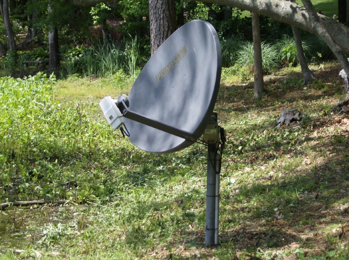

The LNBF that comes with a Primestar 84E is a Standard LNBF 10750 LOF and beats the pants of of my Invacom. You don't say what kind of Primestar dish you have, there is a model or mold number on the back of the dish. Primestar (Channel Master) are of the best in service. My Primestar LNBF has V and H outputs so you would need a Diseqc 2 X 1 switch at the dish ($5) on Ebay.
I wonder how much of that is the LNB and how much is the feedhorn (I'm assuming you didn't use the Primestar feedhorn with the Invacom). I tried replacing my Primestar's LNBF with a cheap Digiwave 0.3dB universal, and my quality on G25 went from 80 to 55. I blamed it on the mismatched feedhorn, but maybe I was wrong. I'd love to know whether an Invacom mounted on a Primestar feedhorn can beat the stock LNBF.
(It's kind of a moot question for my situation, because I was mainly trying to replace the LNB with one that weighs less. I'm certain my motor wouldn't move with an Invacom on there.)
Check this out.
Invacom C120 with elliptical feedhorn on P*84E.
I guess I'll be keeping the ol' beer can on my Primestar dish then*. I was only considering an Invacom because I thought it would work substantially better, but with the exception of AMC-1 I never have any weak signals anyway.
* Unless I can get my BSC621-2 to work on the thing! :D No luck so far.
Hope I didn't mislead about the Invacom. I dug that picture up of the Invacom and P*scaler ring. In my test I used the SNH-031 and that has a scalar ring for offset dish but not elliptical. So who ever did this install did not post their comparison. My take on the original P* LNBF is that it is more to commercial grade.
I would be interested in your findings if you decide to test one of the Invacoms with the P* elliptical conical scalar ring.
